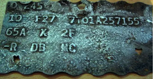

Hi
I have a mustang 67 mt 3.03 3 speed (i think)
i wont to know what kind of rear axle I have, and more specs of my car
the data is :
D \\\\ 245
10 \\\\ f27 \\\\ 7t01A257155
65A \\\\ x \\\\ 2f
-R \\\\ db \\\\ mc
ultrastang said:
That's the body buck tag. It won't give you the rear end ratio. For that, you'll have to look on the tag on the driver's side door (inside the door jamb). Look under the "Axle" heading on the tag.
Assuming the door hasn't been replaced, that code should reference you to what ratio you have.
Here is a link that may help you to cross-reference the codes:
http://www.ultrastang.com/Rearinfo.asp?Page_ID=5

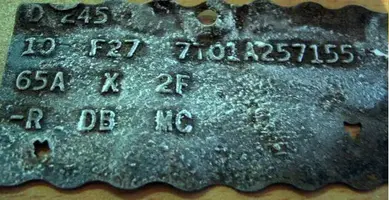

hi
i dont have the tag on the door.
what kind of info can you give me from this tag?
on the axle i have this :
c70w
4025-a
11
on the tag:
cz f1
00-7fb-311
