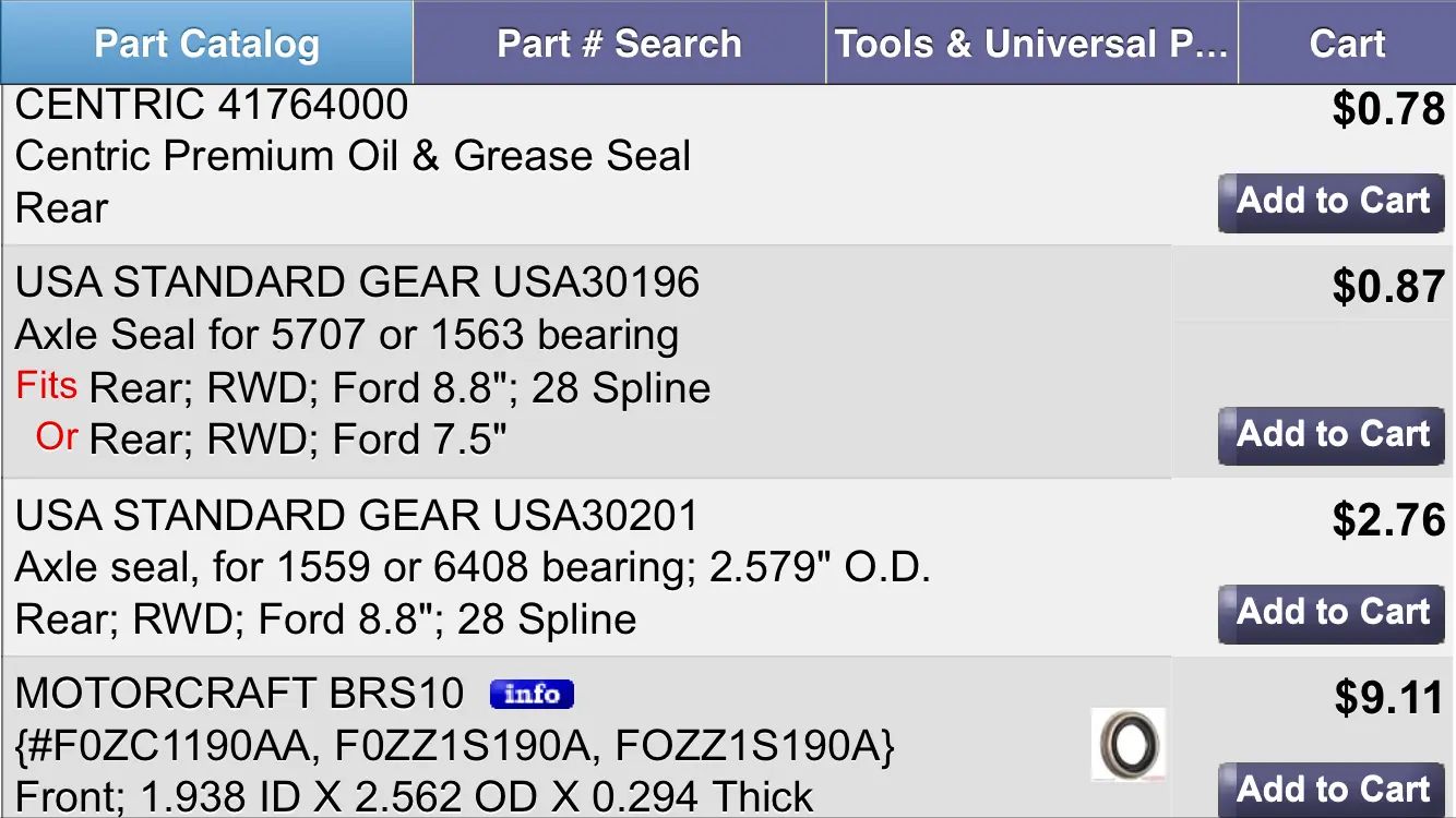

Rockauto shows these ford Ford oem part numbers.
Note that a lot of parts systems are yet again listing the wrong parts for these cars. Foxbody owners can't catch a break. They're listing Timken 714569 or equivalent, which is for a newer car and the O.D. is .022 too big. The correct seal is Timken 8660S or equivalent.
