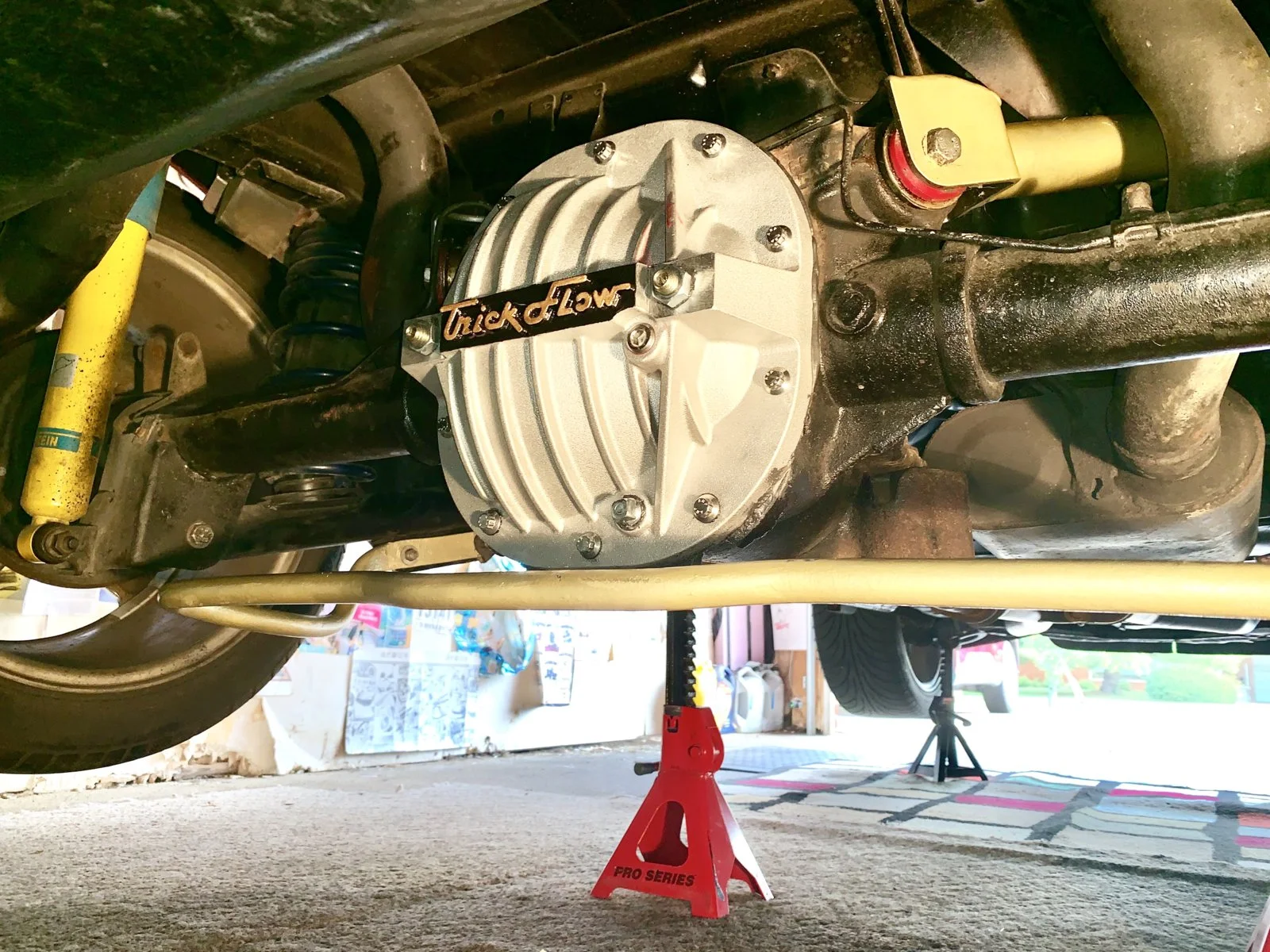

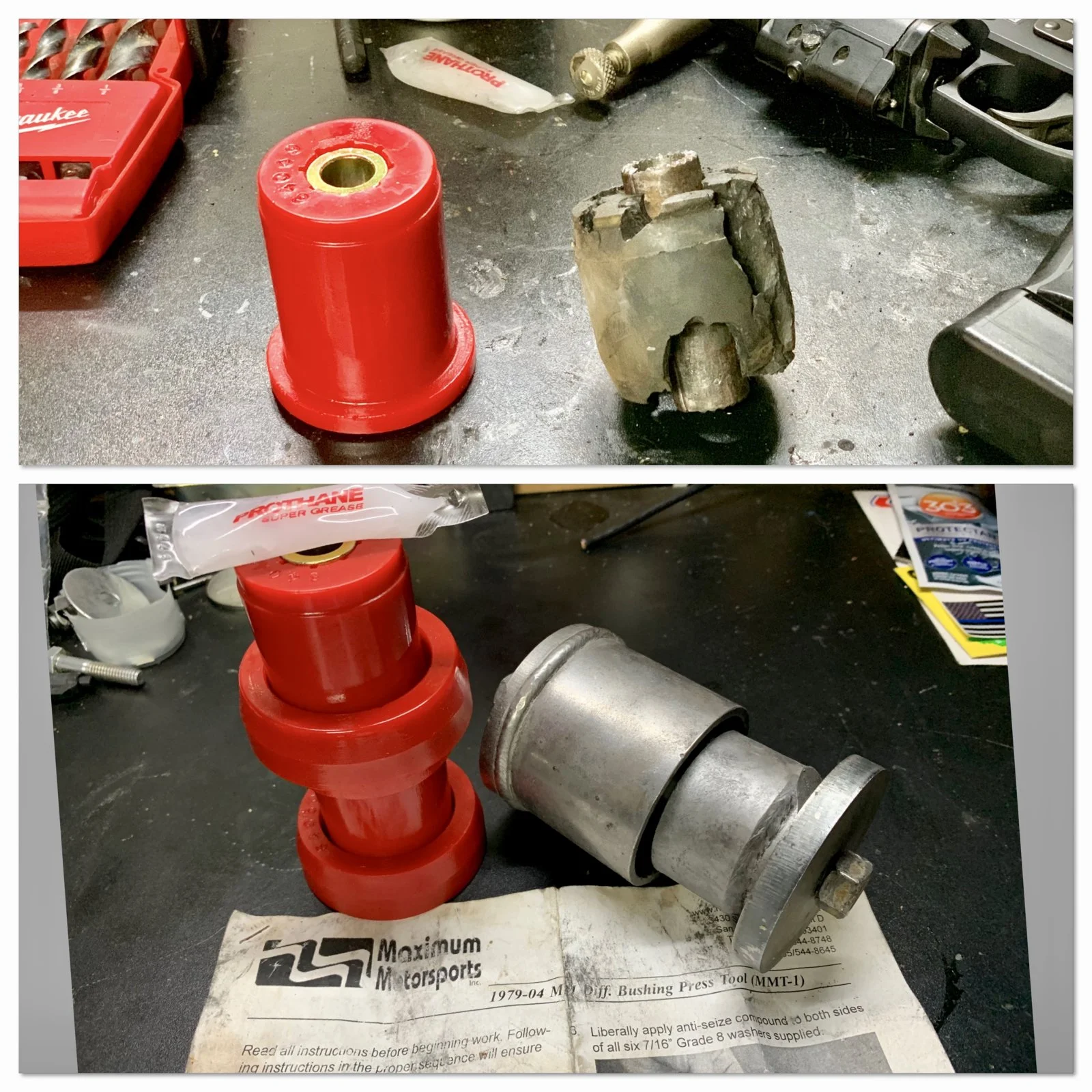

I have J&M upper and lower control arms with the “Poly Ball” bushings. Sort of like a cross between poly and spherical. I also have poly axle bushings too. (GASP!) There is no binding. There is no snap oversteer. I don’t track my car, but it sees more spirited street driving than most peoples cars, I would imagine. I hung the back end out really far a couple days ago, nice predictable angle of attack, throttled out, zero issues.
I do want a panhard bar setup real bad, though.
Edit: also, the MM bushing tool is worth its weight in gold.
I have the Steeda sway bar (they call it that, it's really a yaw bar). It makes a big difference. It can take the car from it's natural really bad understeer all the way into oversteer. Trouble is that it sometimes doesn't clear an axle girdle. Worth looking into. Cheaper and easier to install than a panhard bar.

I particularly like the fact that there is what looks like a tactical Sig in the first pic!
Yeah, that MM tool is awesome.
Good eye, sir. There’s a special place in my heart for my p226s. I carry one as my service pistol and another as my off duty.
