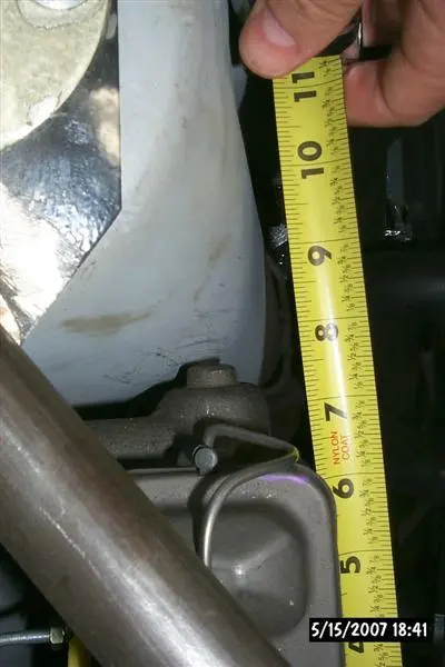

Wow.. It looks like on my 69 with a stock booster there is only 7 1/2" from the booster face to the tower. I'm not sure how I could get the extra length to work without notching the tower. Fun fun...
Looking for more options I guess.
-Stephen

I have customer, in Washington state, who has the same SN-95 V6/GT rear disc bracket setup that you got from me.
He was asking me about MCs when he was trying to put the parts together for this swap, and said that his '68 has the factory '68 power brake booster. I told him that the '94-'04 V6 4-wheel disc MC should work, since the SN-95 V6 MC is 7-3/8" long. He got the V6 MC and it did fit in his '68 on the stock booster. Picture of Ron68's MC setup; http://img261.imageshack.us/img261/725/ron68sn95reardiscs5dd1.jpg
The ports are metric and they exit on the passenger's side of the MC, but it did fit his stock booster in his '68 with a 351W.
This is a photo I took 3 years ago when I used this same SN-95 V6 MC on the "guinea pig" '65 fastback I was trying to figure this rear disc swap out on; http://img480.imageshack.us/img480/5433/65050jh3.jpg
http://img514.imageshack.us/img514/9887/kieths65053vw9.jpg
Obviously, the 2.3L Fox booster I used in the '65 is much "flatter" than your stock '69 booster, but this just gives you an idea that the MC works.
http://www.ultrastang.com
Excellent - I think I'll go that way. Actually I have no issues with the ports being on the other side, it will makes things easier to plumb for the porportioning valve and line lock in the long run.
