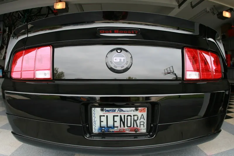

GT (Jim):
My experience was the same as Emay's (except I used 40 lb. test--it was stuck on there pretty good, and it's only been three weeks.)
Now, I put on the SilverHorseRacing rear medallion ...
... and it came with a piece of double-sided material to use in case the factory adhesive wasn't reusable. That stuff must be available somewhere if you need it.
... jim2
