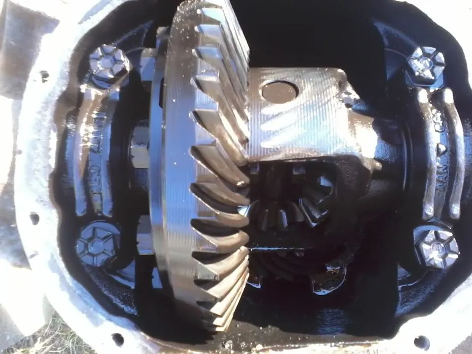

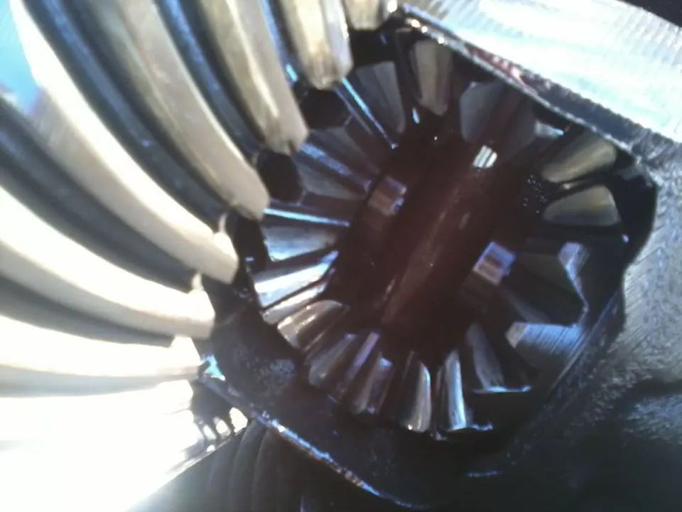

Here's the old one:
Nothing noticeably wrong with it, aside from it having zero fluid inside. I believe I could replace the pinion bearing and the seal and call it good. I've got the other rear end in the car now though, so I'm not sure if I'll keep this one or not.
