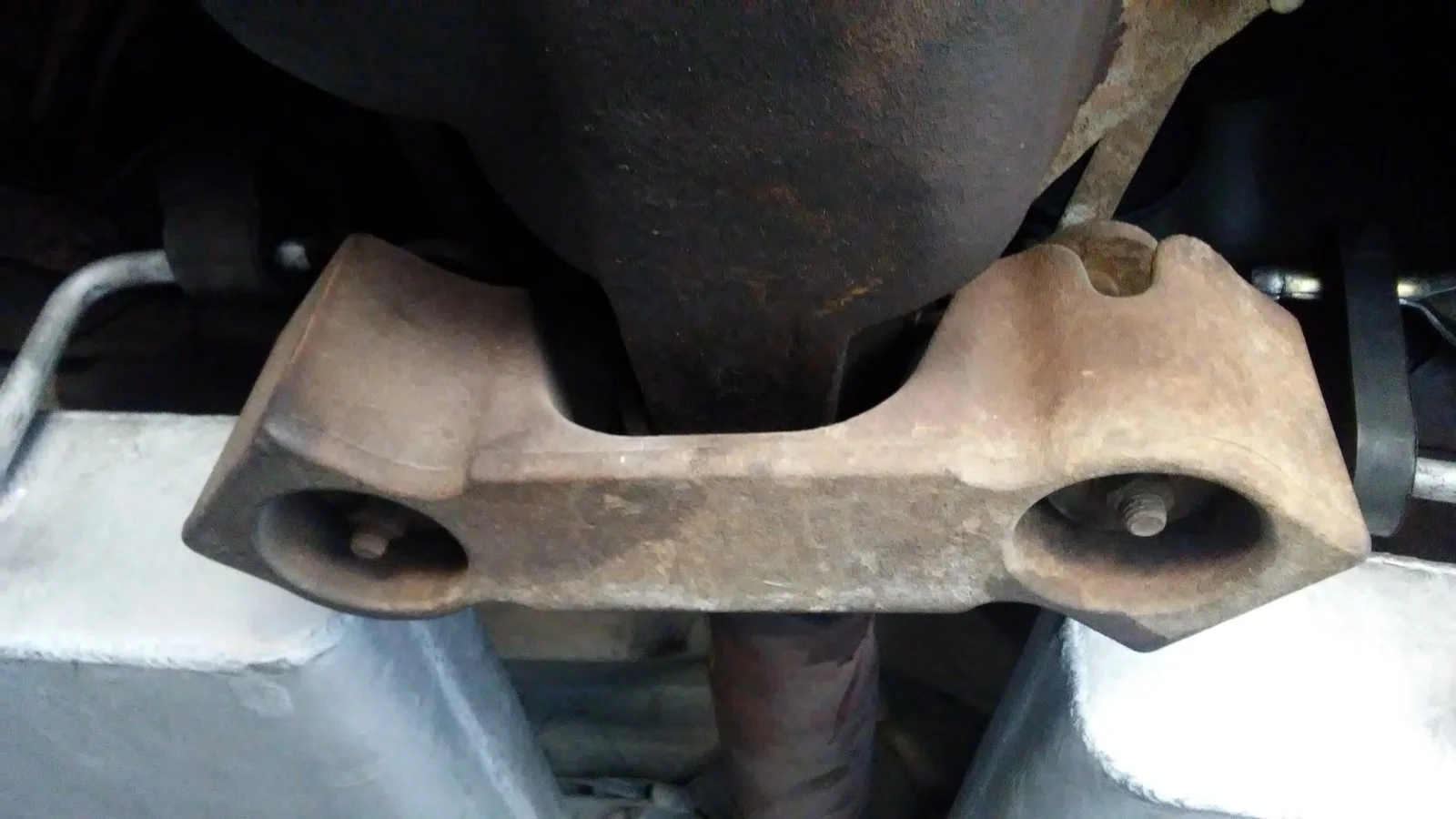

While doing a "what is this and what does it do" search I ran across this thread. Is this what is being referred to? If not, can you tell me what this is? I don't find it in my Ford shop manual.

Ford is cheap and if they could get away with not putting a part on the car, they would do it that way. The dog bone as it is often called, helps dampen out vibrations in the driveshaft. It allows a greater range of tolerance for driveshaft imbalance. This will help to reduce vibrations and make the U joints last longer.

It's because the driveshaft must spin faster with numerically higher gears for a given speed. So, actually that means that it's not good enough for higher gears. Then again, the factory hold pinion angle to the tolerances we can, or run an aluminum driveshaft, or road force balance the drive train.
Do you need to do all of that? Maybe... maybe not. Just take it off, go for a fast drive, and see if it feels alright. And ok, replace your U-joints a little more often.
