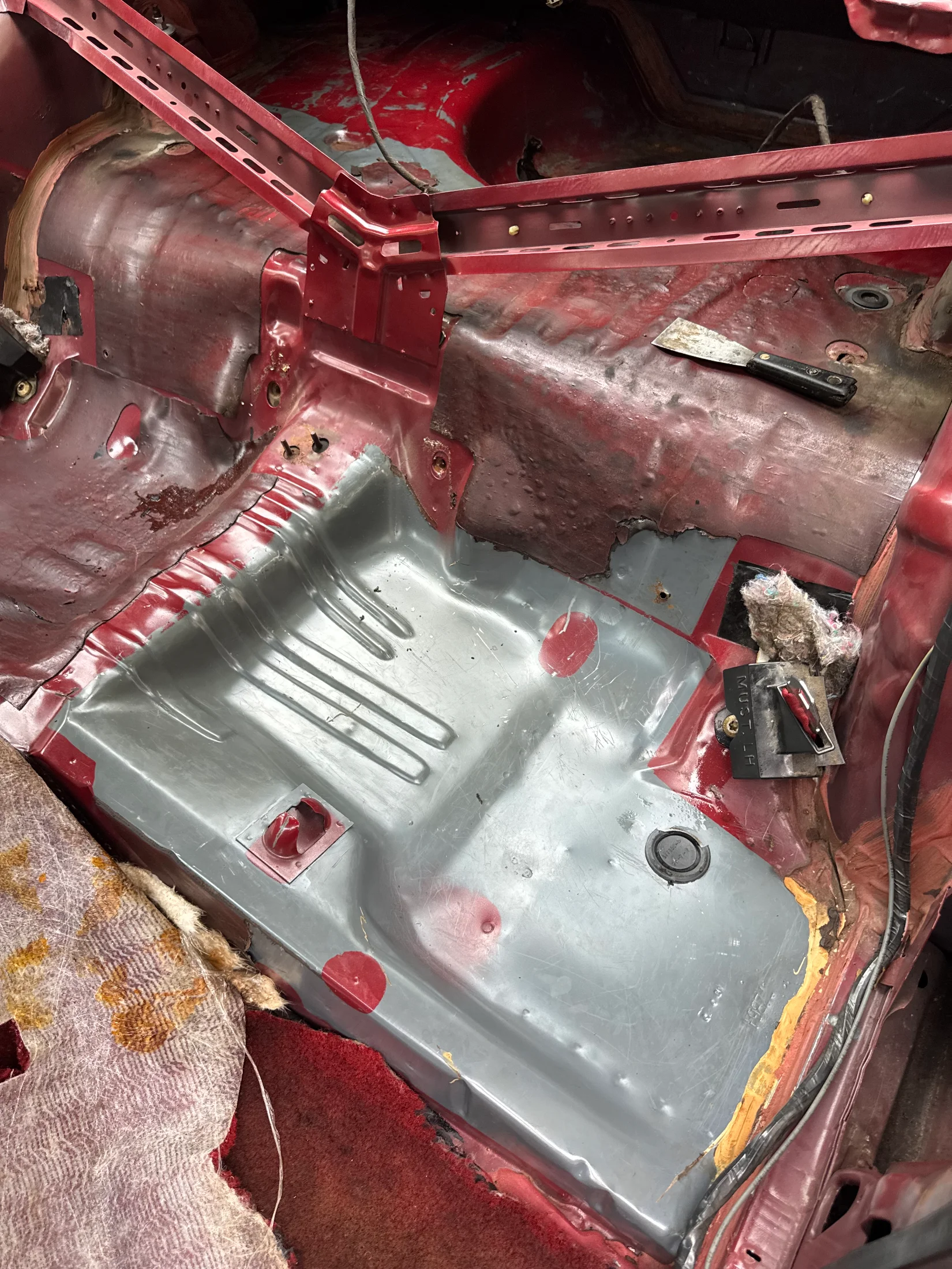

Can anyone provide some guidance on how to remove this torx screw for the rear seatbelt? It's at a very weird angle and an extension with pressure has no worked. Have also tried liquid wrench and WD40 with no luck. Next thought is heating the end of the screw because it's exposed underneath the car. Anything will help, thank you!
