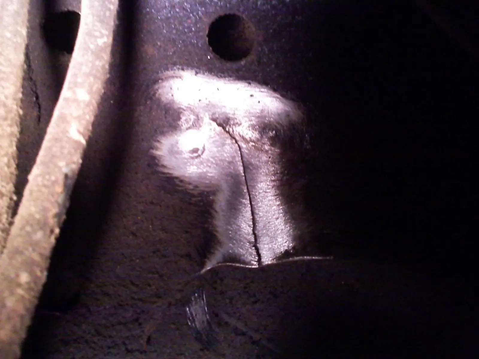

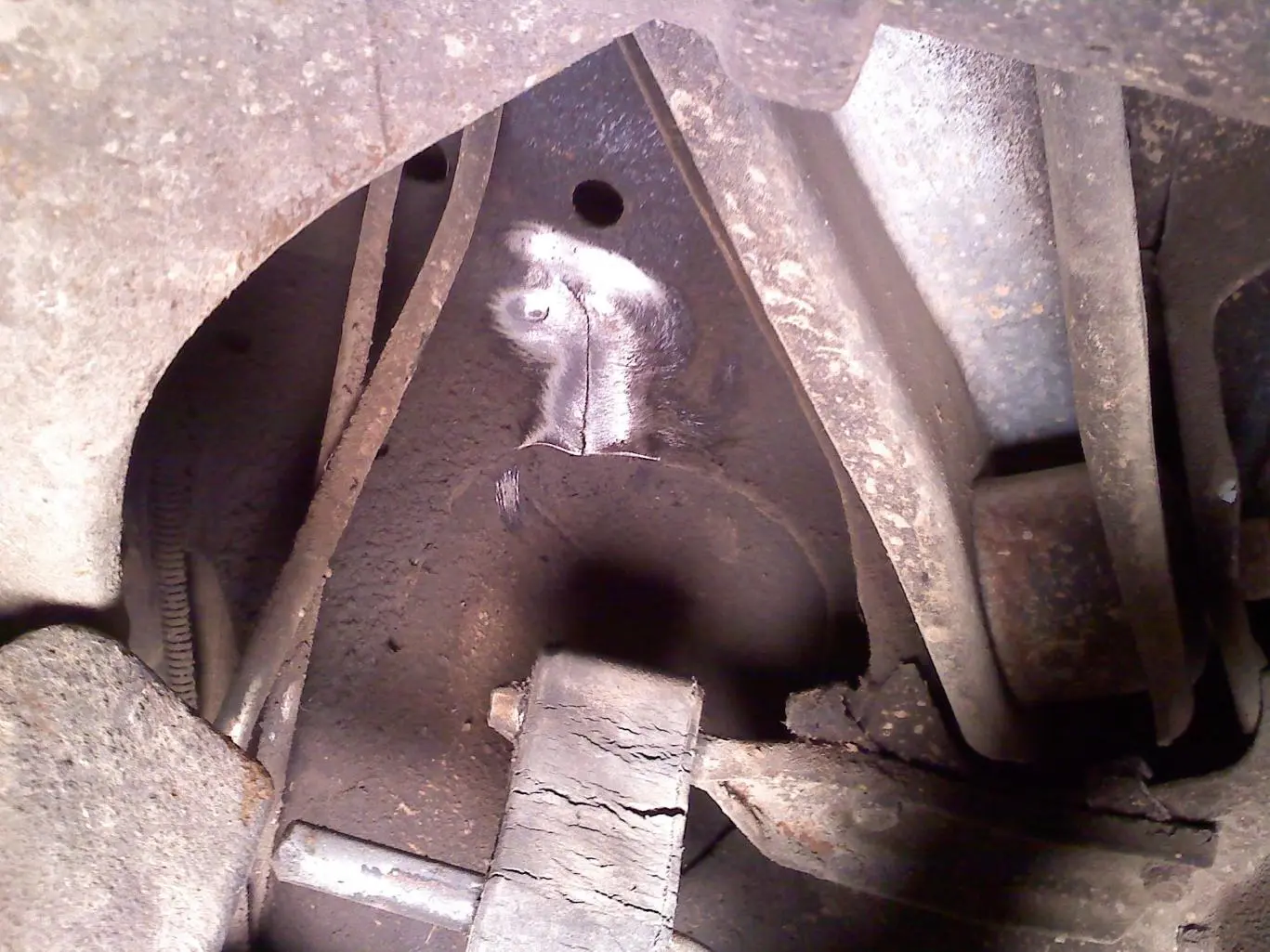

sorry cardudeuse for kinda jacking your thread.. i think i may have found my problem with my car. i looked all under the back of the car looking for signs of broken or torn torque boxs or any other rear end componets. i did find a small tear just to the left of the right side torque box. im thinking this was causing my problem. i got the welder out and welded it up and while i was under there i added a few more tach welds to the torque boxs. i took it for a test drive and all seemed fine. before this thread i had no idea what to look for. thanks guys.

No worries, the pictures are helpful actually. I'm going to check on Thursday and see if my brothers car looks like that.
