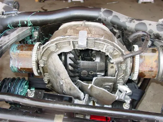

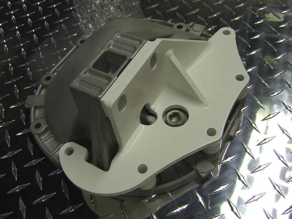

I strongly recommend getting this: http://www.billetflow.com/irs_brace.htm at the same time since you will have to have the cover off anyway to do the gears. I have one on my car and it's cheap insurance as well as a very well made product.
Pics:
