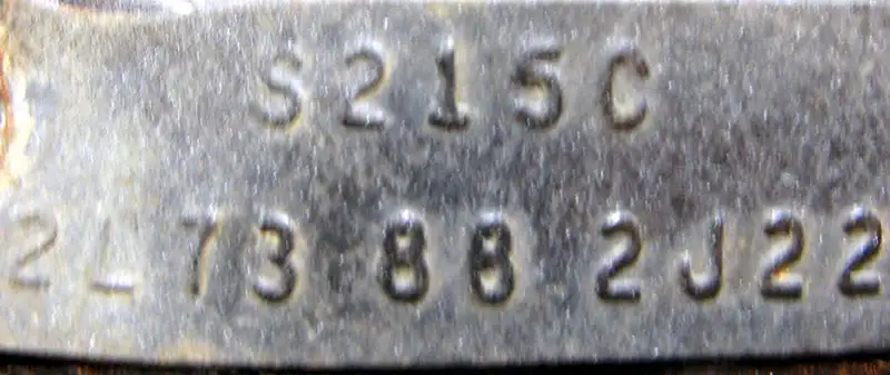

easy way to tell if its an 8.8 is from the tag on the diff cover.
If it has 88 on it, its an 8.8
Like so
