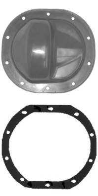

V ventura New Member Feb 19, 2011 4 0 0 Mar 13, 2011 #1 Mar 13, 2011 #1 Have 83 Gt,5spd. 4 bolt wheels. Would this have the 8.8 rear? How do I tell?
Mustang5L5 That is…until I whipped out my Bissell Mod Dude Feb 18, 2001 43,143 17,839 224 Massachusetts Mar 13, 2011 #2 Mar 13, 2011 #2 Not stock. You can tell by the differential cover. The bolt pattern is unique to a 7.5 and 8.8
Mustang5L5 That is…until I whipped out my Bissell Mod Dude Feb 18, 2001 43,143 17,839 224 Massachusetts Mar 13, 2011 #3 Mar 13, 2011 #3 8.8 bolt pattern.
Mustang5L5 That is…until I whipped out my Bissell Mod Dude Feb 18, 2001 43,143 17,839 224 Massachusetts Mar 13, 2011 #4 Mar 13, 2011 #4 7.5....notice more rounded on sides than the 8.8 above
