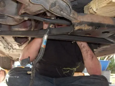

Then you can sit under it like this to tinker with the RMS... i actually found a coffee can the exact size and tapped it in to place with that... worked awesome.

Damn, either you have some really tall jackstands or you are a midget. I've never been able to get that much space under my car to work.
Kurt
as you can see the back in on ramps... the car wasnt that high up... im like 5'11'' you would be amazed how big that trans tunnel is...

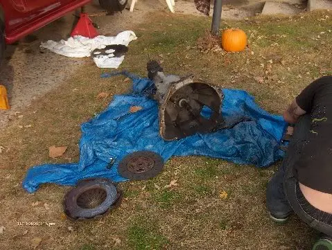

Damn, you pulled that transmission all in one piece. You know the transmission seperates from the bellhousing right? That's pretty good work getting the car that high. I'm 5'7", and I've never been able to sit up under my car. Good work dude.

Yea the bolts were in there good i know it came apart but it was easy enough to take out as one piece. the t-5 is rather light made it an easy task. Just make sure when you do the RMS not to scratch up the crank
