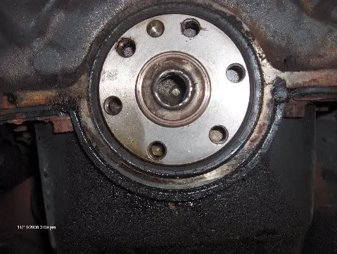

I just use some 400 grit or something like that, and do a quick sanding around the edge of the crank. The seal actually has a break in process with the crankshaft. You just have to rough up the surface a little to get a fresh break in. I don't think it's a big deal if you neglect to sand the crank. Odds are it's going to break in anyway.

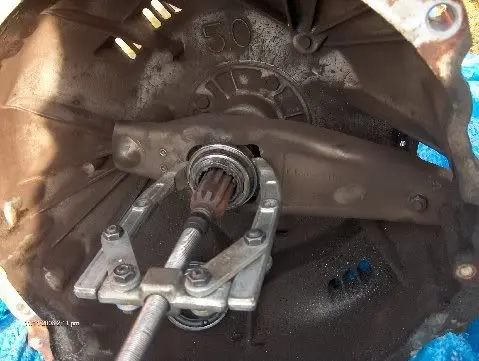

I have one question though to ask REVHEAD. He stated that you don't have to pull the whole trans and bellhousing out together in one piece. But if you are strong enough to do so, like ADAM, is there any benefit of taking them out seperately? For instance I noticed in ADAM'S pic, that he did have the clutch unit all apart, but when taking it out in one piece is it possible to keep the clutch/pressure plate/and throw-out bearing all together on the input shaft? Thanks
Yeah, it will come out just fine. The throwout bearing is attached to the clutch fork which will come out with the bell housing. The pressure plate is polted to the flywheel. However, it is much easier to take the transmission out seperately from the bellhousing. It's a necessity if you have longtubes.

You cannot goop up the seal lip, other than using a little grease to prevent tearing.
Some people (myself included) do RTV the outer circumference of the seal's housing (the metal part) to help deal with any irregularities in the metal.
more pictures if needed... you can see my tob broke in to several pieces.... the ball bearings were in the bell housing....:mad:
