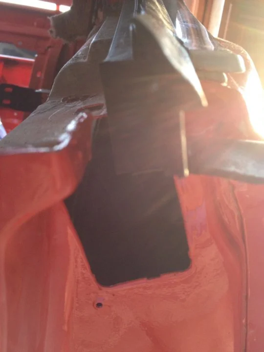

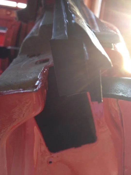

i am in the process of reassembling my 69 fastback after repaint. I am currently installing the quarter windows. The rubber is installed the window frame is next. My concern is the gap between the rubber which has a screw hole and the body which appears to have an attachment hole. The distance between these two parts is about 1 1/2 inches much to large to close with the screw. What fills the gap?
See pictures attached.
Anyone with a 69 that could take a picture would help
Unable to up load pictures at this time standby
Not great pictures but the gap is there. I can upload on my lap top no broblem. But since I upgraded my Ipad to IOS8.something it will not allow mae to upload. tahnks for the help
If i remember right ,the lower part of the quarter gasket has a metal strip imbedded in the rubber and that holds the mounting screws .It is possible the mounting screws are not in the correct place in the rubber ,you know the aftermarket stuffo_O I have had to slot the holes to make it fit correctly before but usually not a lot .Are the holes filled with hardened putty ?
