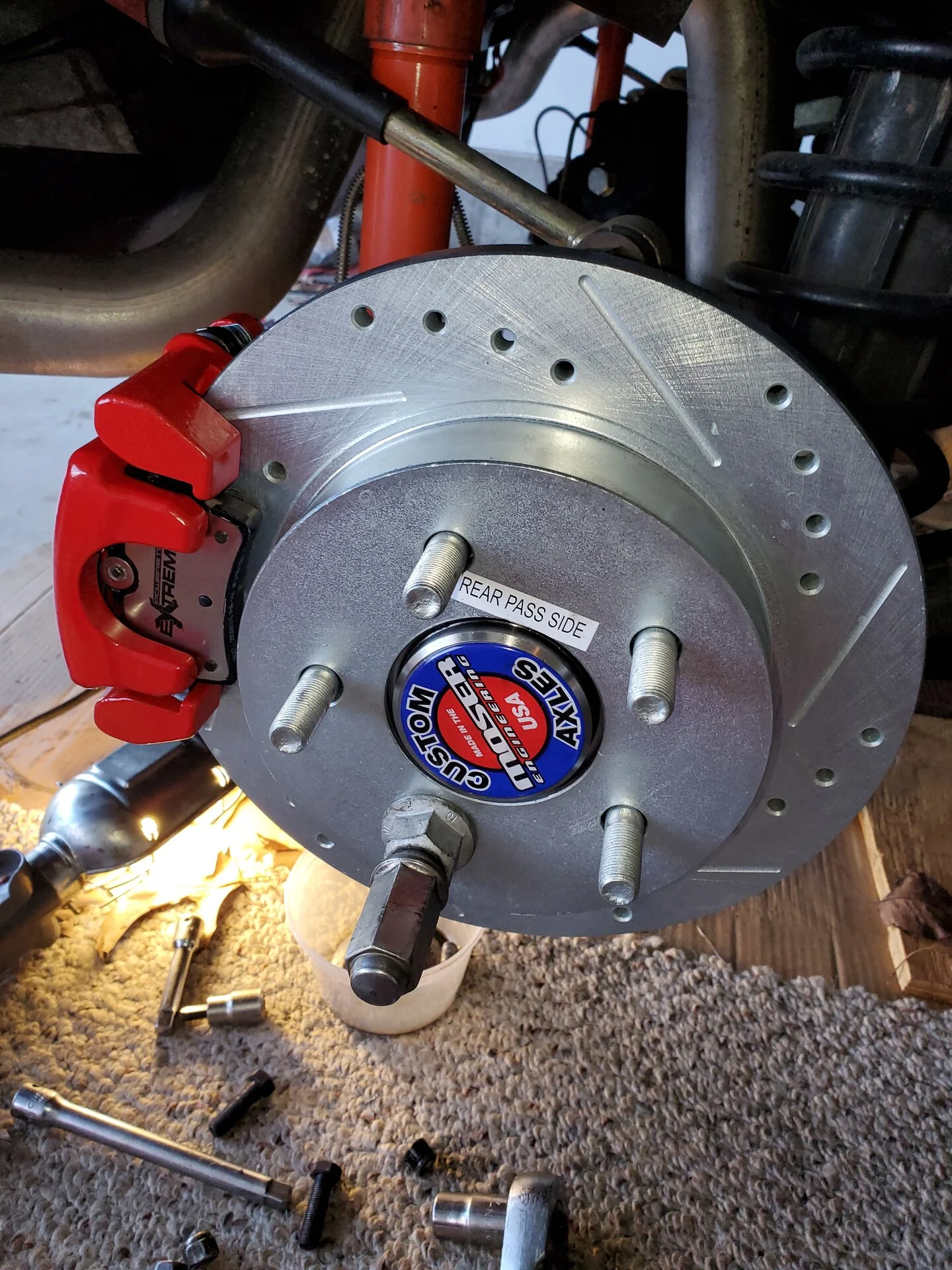

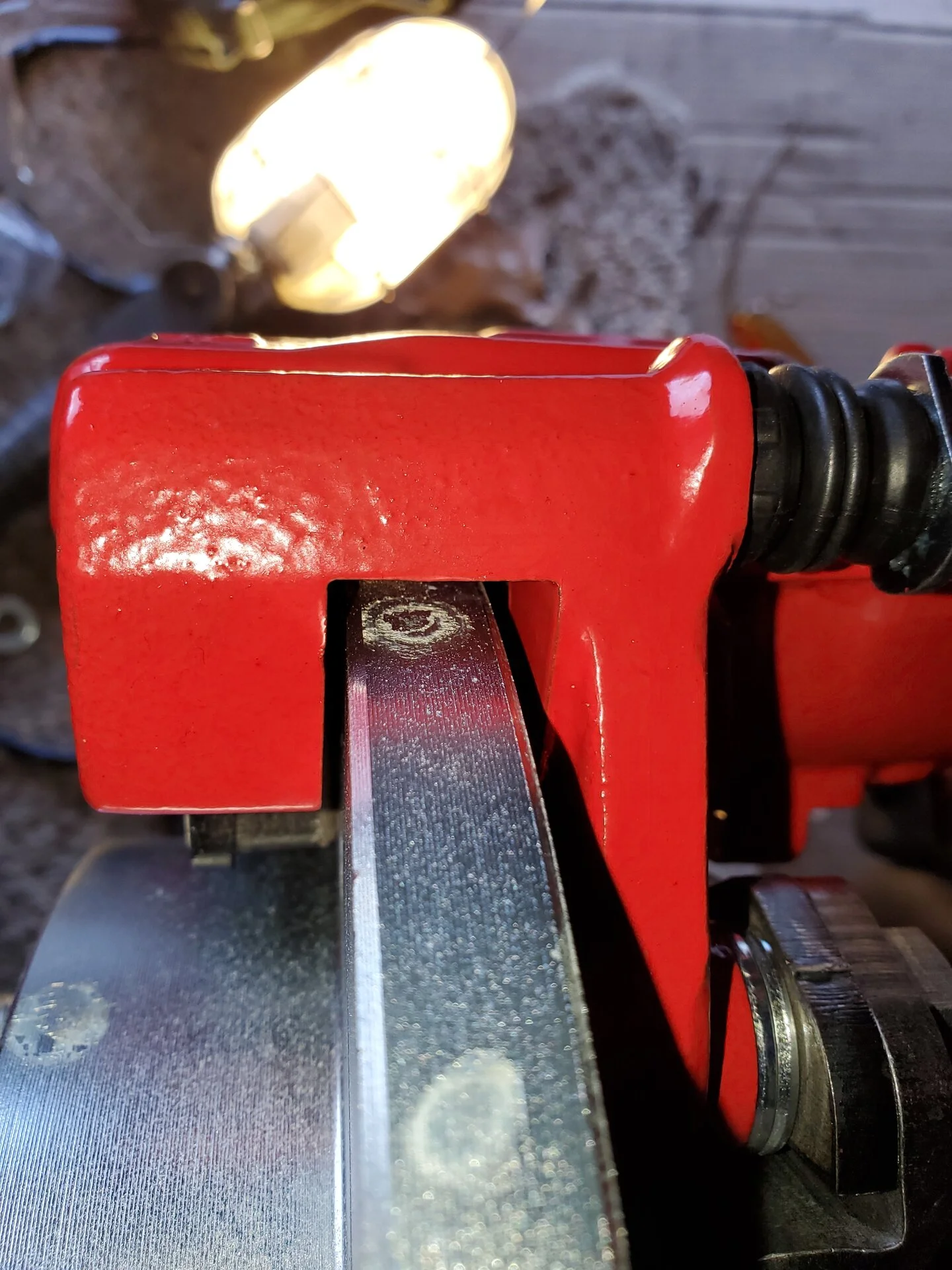

After the NorthRacecars brackets, the alignment for the rotor is dead on, IME.
