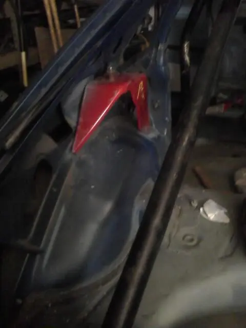

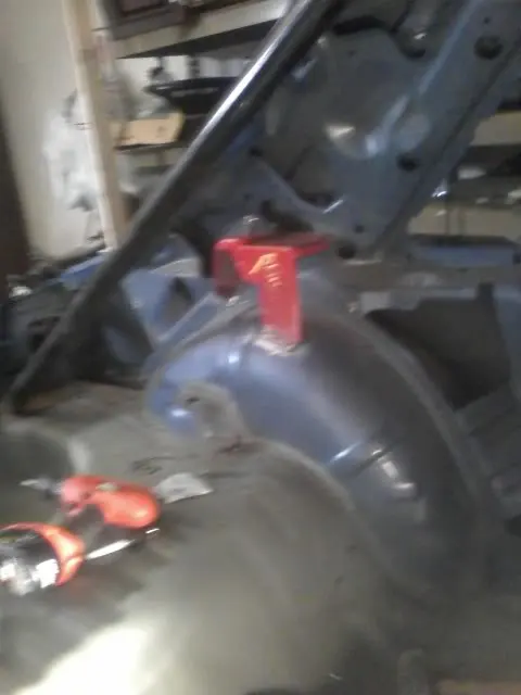

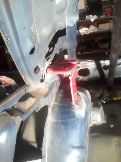

i did mine on my 87 project it's not hard but you definately want to know what your doing with a welder and cut from a donor car and mount in the right place.
here are some pics
