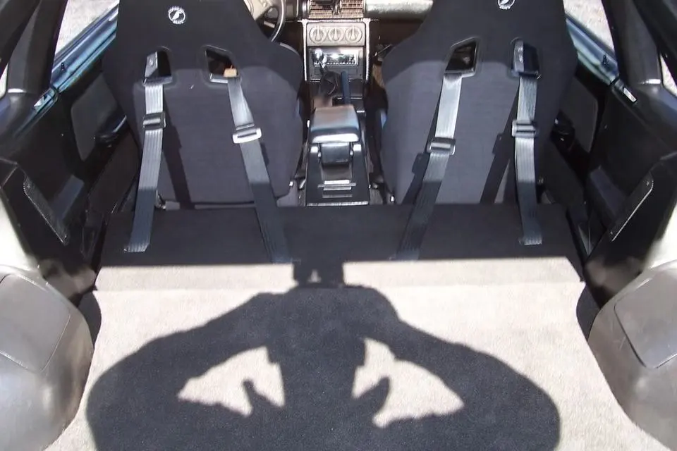

make it yourself thats what i did cost me about 40 bucks including the carpet from any local car audio place, a piece of thin plywood, carpet glue, and a few screws...

yo allballs, i think ima do that. im on a tight tight budget. and props to you, came out amazing! any spacial things ima need or is it all simple common sense things?

no its pretty much straight forward just make a template and trace it out and carpet it....i chose to cut holes in it for my harnesses but if yuor using seat belts you dont even need to get that creative...then just make a few brackets with some sheetmetal or something to hold it in place...hope that helps

Not to hijack here, but I hope you never have to use those harnesses with the way you currently have them mounted. Without a crossbar to mount them to, they will compress your spine and could cause a severe spinal cord injury that could result in paralysis.
