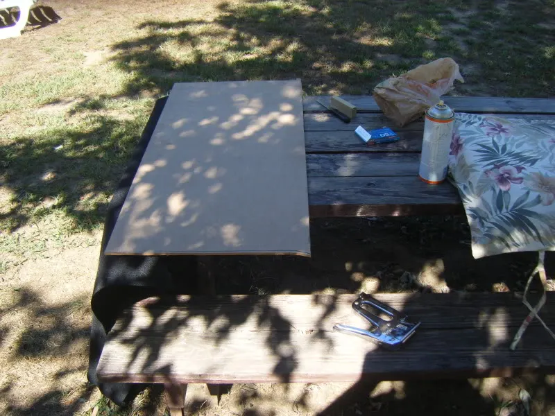

Trace the template on to the MDF
Then you cut out the mdf
Lay the mdf flat on the carpet section

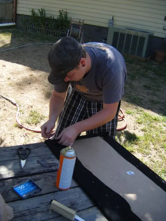

Spray the side to be carpeted with the adhesive:

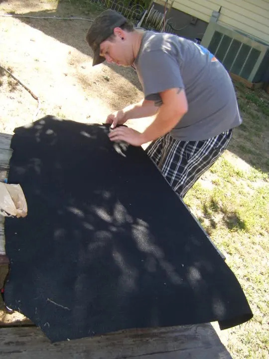

Pull carpet over and stretch tight
Be sure to rub the carpet flat with no wrinkles.

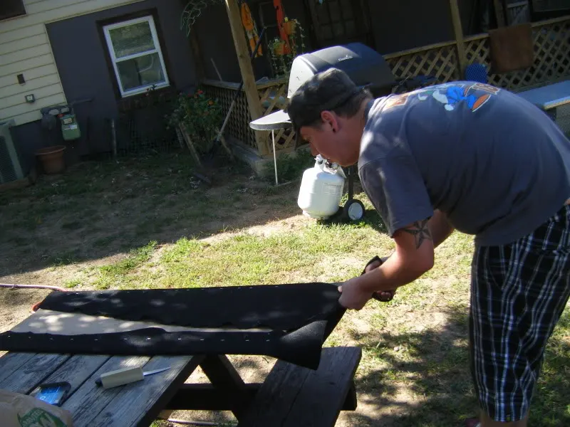

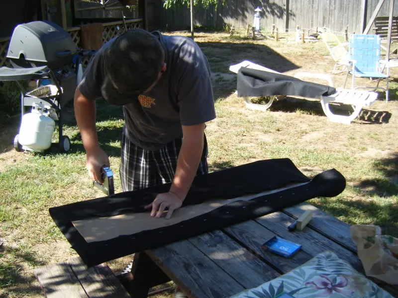

Flip it over and pull hard on the carpet and start to staple:
Trim off Excess

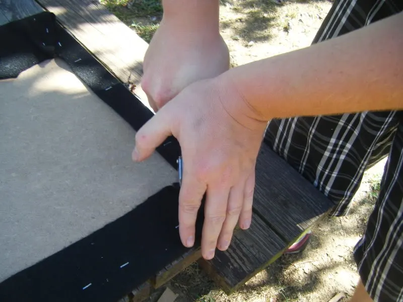

Fold in the corners neatly:
Staple Secure:
Trim Excess:

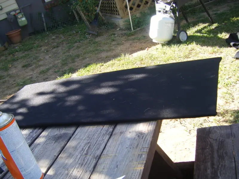

Bottom Finished:
