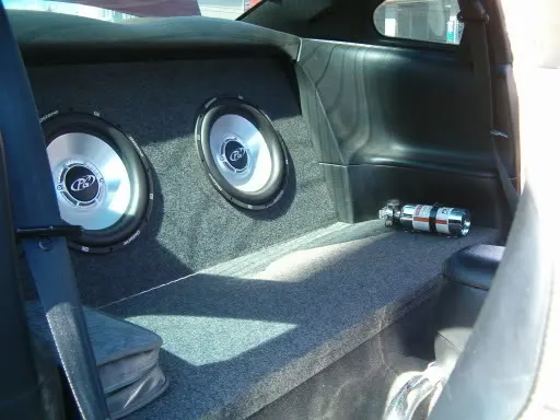

Well I fabbed my own out of a couple of pieces of plywood I had lying around the shop. The only thing I had to buy was a roll of carpet which was under $20 and about 1/2 hour of my time. These places charging $100 are completely out of there mind. Thats almost 2 nitrous bottle fills. LOL
Another DIY. I borrowed a couple of ideas. I have the seatback able to fold down for pass-through storage. I also used piano hinges to have hinged storage under the seat (thanks to Aaron for that idea).
Sorry for the sucky pic but it's all I have. I took it just to show the hinge situation. The piano hinges are hidden but you can see the outline of the center lid.

Making it isn't tough. I just used cardboard to make a template of one side of the area normally occupied by the 'butt' region of the seat (how it tapers outwards from the seat back forwards). Add the template to the width measurement taken at the back edge (where the stock seatback meets the seat cushion).
i must say. i love ur RSD. if ur interested in selling it let me know LOL! since ur a professional at making them, that is! JK JK! i like how the bottom half is still functional
if i ever get time i plan on making one myself.
i would think the best way to make a template, would be to use a big sheet of paper. that way you can get the conture of the sides, then transfer it to plywood or whatever you making it out of. and space the 2 templates apart the same sizes as whats in the car.
or if you have some stiff wire, you can mold it to the sides and just trace it to paper or cardboard. test fit and trim as you need to. then transfer it to the material you plan buuilding it out of.
Good luck.
