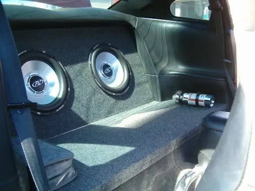

I've always wondered how ppl did their subs in the back of the seat like that. Do you have a custom box that is connected to the back of the seat? Or did you get free air subs? I have some JL W6V2's that would definately need an enclosure, but I'm not sure the easiest way to mount them and have them enclosed without making a completely custom box (which would probably be a huge hack job for me).

Make your own, its pretty easy. I made mine out of 2 Aluminum sheet's, then covered it in Carpet

Well, I can't take any more pictures of my RSD at the moment, I'm a little indisposed at the moment, but I can answer a few questions.
The headrest part of the backseat, IIRC I didn't even have to take it out. We used the mounts for the frame that used to hold the back seat into place. When I get home (2 months from now) I'll take a look and confirm that.
As for the subs, I have a custom box built into the back of the RSD that comes down underneath the Mach 460 amp rack. It leaves you less room in your trunk, but compared to what I had in there before (just a box sitting in there), it's not so bad. I can now fit two sandwiches in the trunk instead of one.
The RSD is really quite easy to build yourself if you just take your time and do the measurements properly. Once you have main template traced out, you can be creative and use your own idea's to create new storage areas, mounting points for nitrous, etc. Remember, Piano hinges are your friend.

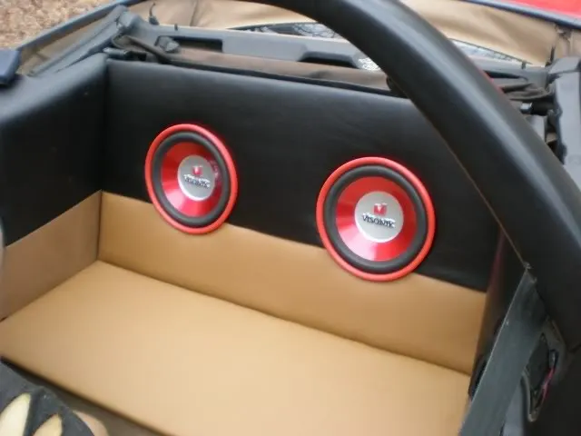

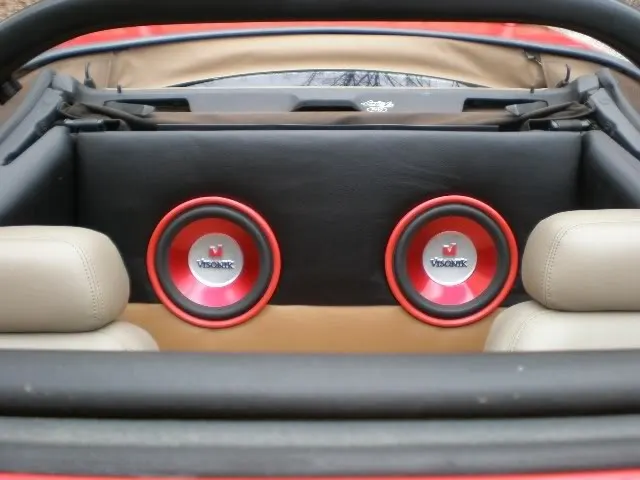

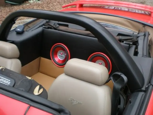

Well.... I couldnt really find any help. But I did it anyways! The verdict is........

p.s. I know my sun visors look like all hell.... but its what i got! if anyone has any or knows of anyone that has some for sale.... hit me up!

that looks pretty kick ass
How are the rear seat delets held into place? I have one that needs to go in but its just the wood w/ the cloth covering it but how do they mount to where the seat used to be?

that looks damn good! I especially like the two tone idea...
Now your template can be used for all the vert guys out there that have been looking for this sort of thing!

Looks awesome! Did you box the speakers? If not, how's the sound?

Holy crap 95gtvertstang! That looks amazing! I am inspired... I may have to buy a sewing machine just to do this
I would also like to know how the subs are vented in the back... seems there is very little room back there, especially with the top down.

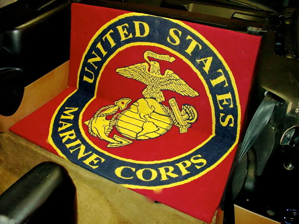

Plywood and hinges were $12 at Lowes b/c I don't have a jig or table saw. I had them cut it for me to my specs and then use the 2 holes where the bottom cushion connected to keep it from sliding.
It folds up for storage under and the back rest is connected with 4 wire ties from the inside of the trunk.
Hope this helps some you out there.
