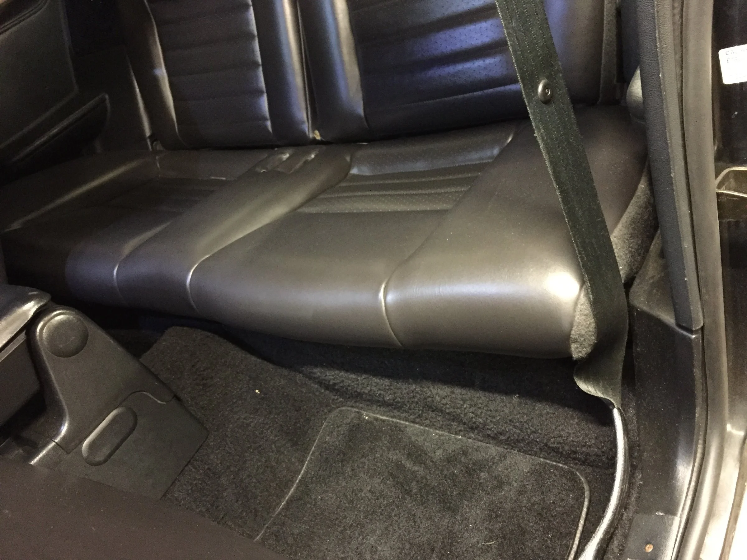

I don't have my oem back seat anymore, so I can't look. My SN95 seat has been more for show, but I'd like to get the back seat functional again for future rides with kiddos.
I'd like to recover the rear bottom to match my 99-04 leather seats, but unsure if a stock back seat can be reskinned.

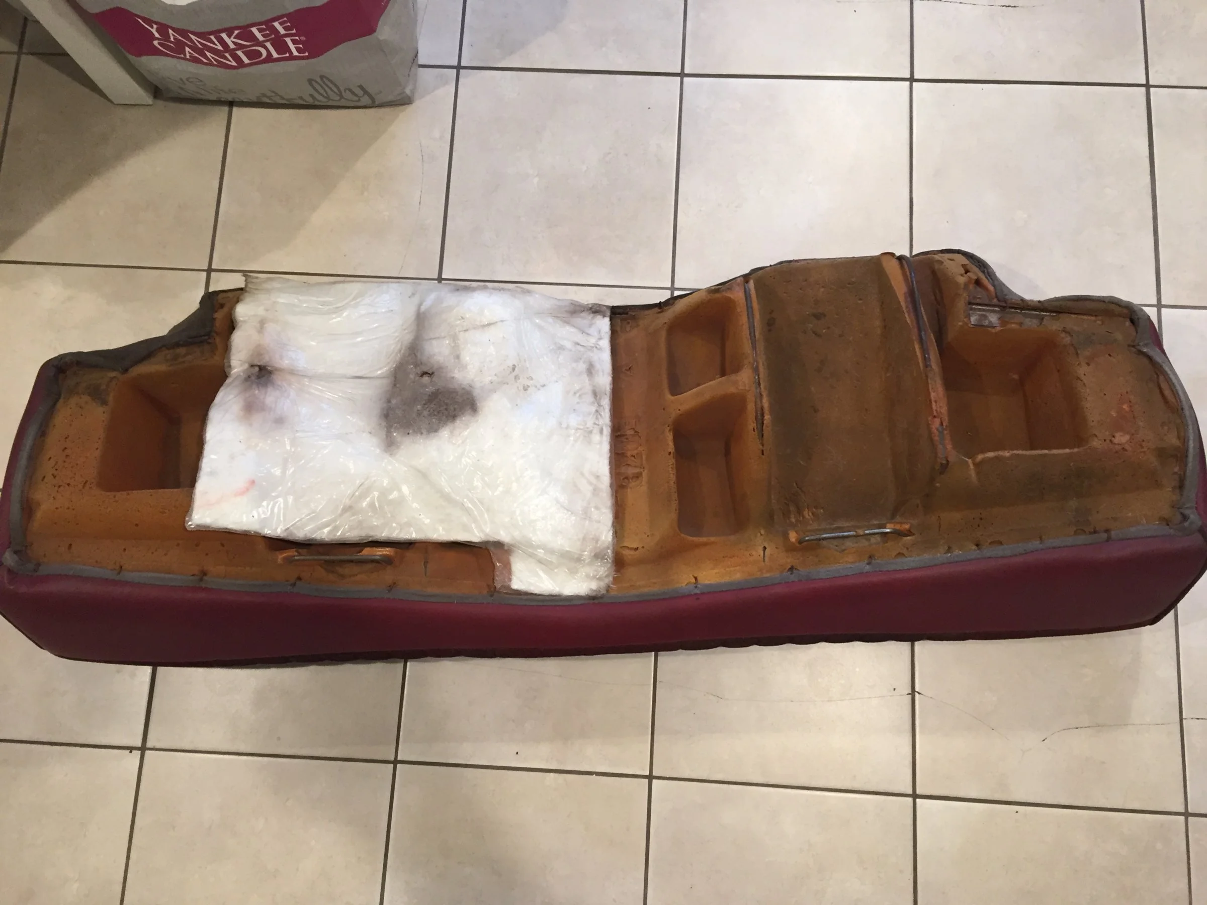

Do they sell new foams? Trying to find a donor 87-89 rear seat, but by the time I buy and ship one, I wonder if a new foam would be better...if such a thing exists.

I don't know about the areo foxes, but there's no foam to be found for the older 4i's Mike. I guess that metal frame inside of the foam keeps companies from making it.
I filled my bathtub up with cool water, a capful of laundry of laundry detergent and a cup of bleach and pretended I was making wine from grapes on mine for awhile.
Got the old stink completely out of it.
It's a pita though mike. You'll have to drain and rinse the foam several times to get the soap out. Then hang it on it's end and let it dry for a few days.

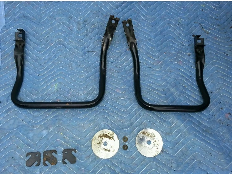

The later Foxes with 3 point belts in the back also had anti-submarining bars under the back seat- another feature I'd like to retrofit. Does your car have these?
I just have lap belts in mine. I actually have no belts in mine since they were originally red and I swapped interior to black.
I don't have the bars either. Bars and 3-point belts started in 1990. I had a set a long time ago but never test fit them in to see if they would attach.

It still doesn't secure the seat down. Right now the SN seat just lays there loose, which isn't an issue if you don't sit in it.
I have a set of SN latches to secure the seat, but I'd need to fab up some metalwork to properly mount it all.

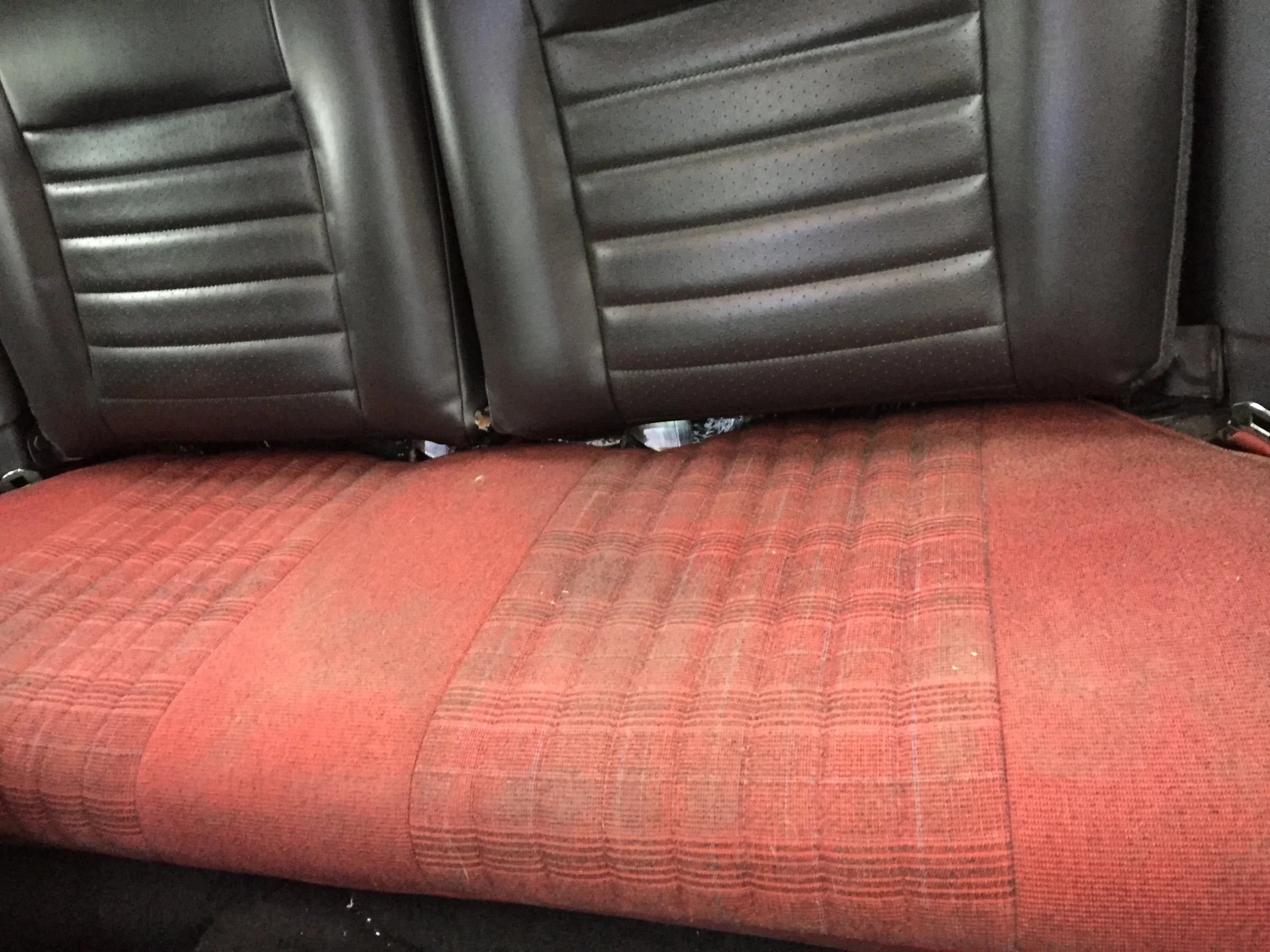

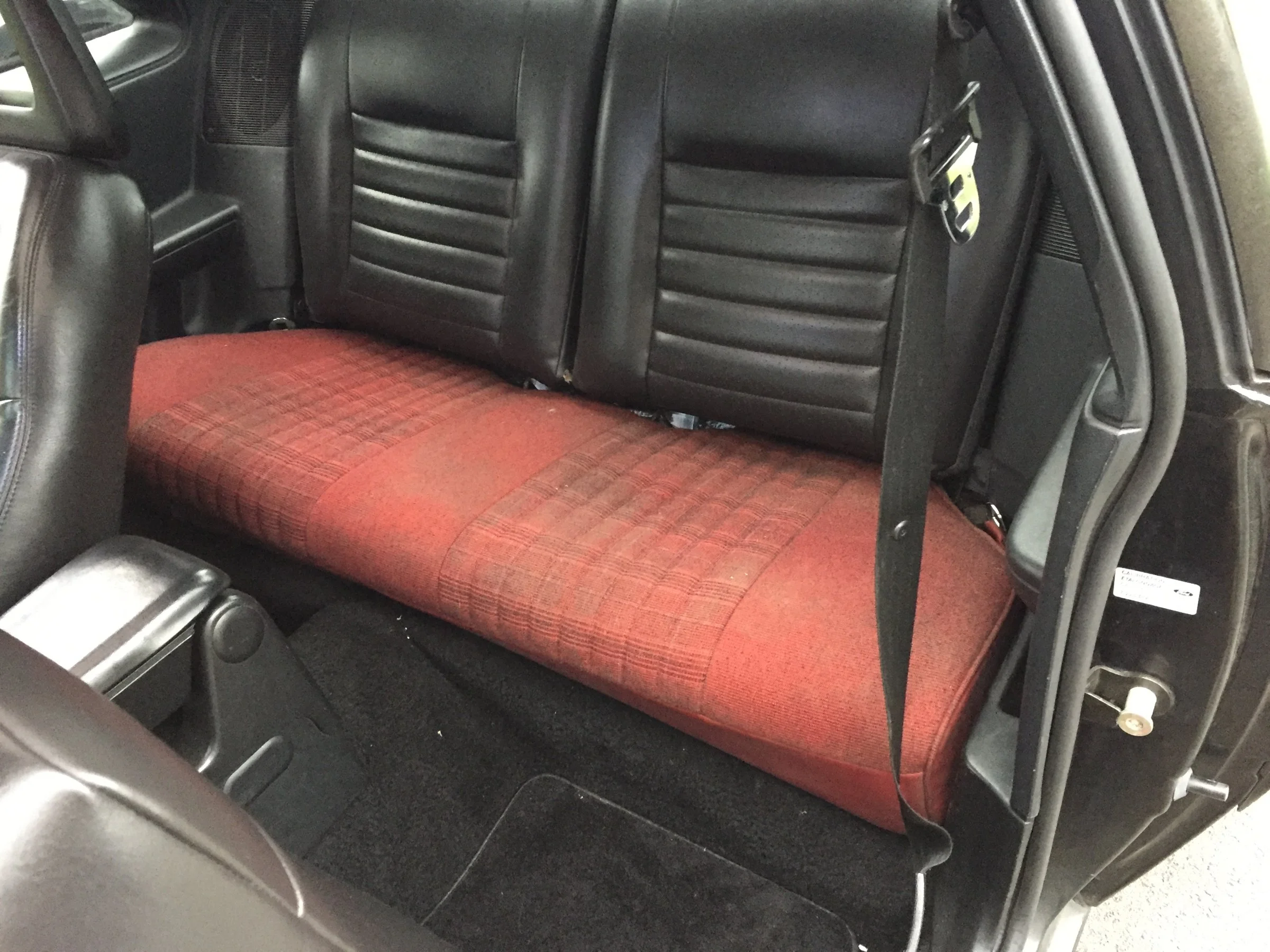

So I threw the seat in just to test fit. The contours if muuuch better and it feels better to sit on. The correctly molded foam just fits better...for obvious reasons.
Now the negative. A gap where the fox seat bottom meets the SN95 seat bottoms. Confused why this is, or perhaps it's normal as I'm using the fox frames, but with the SN95 skins in top. Do you pre-90 guys have the same gap?

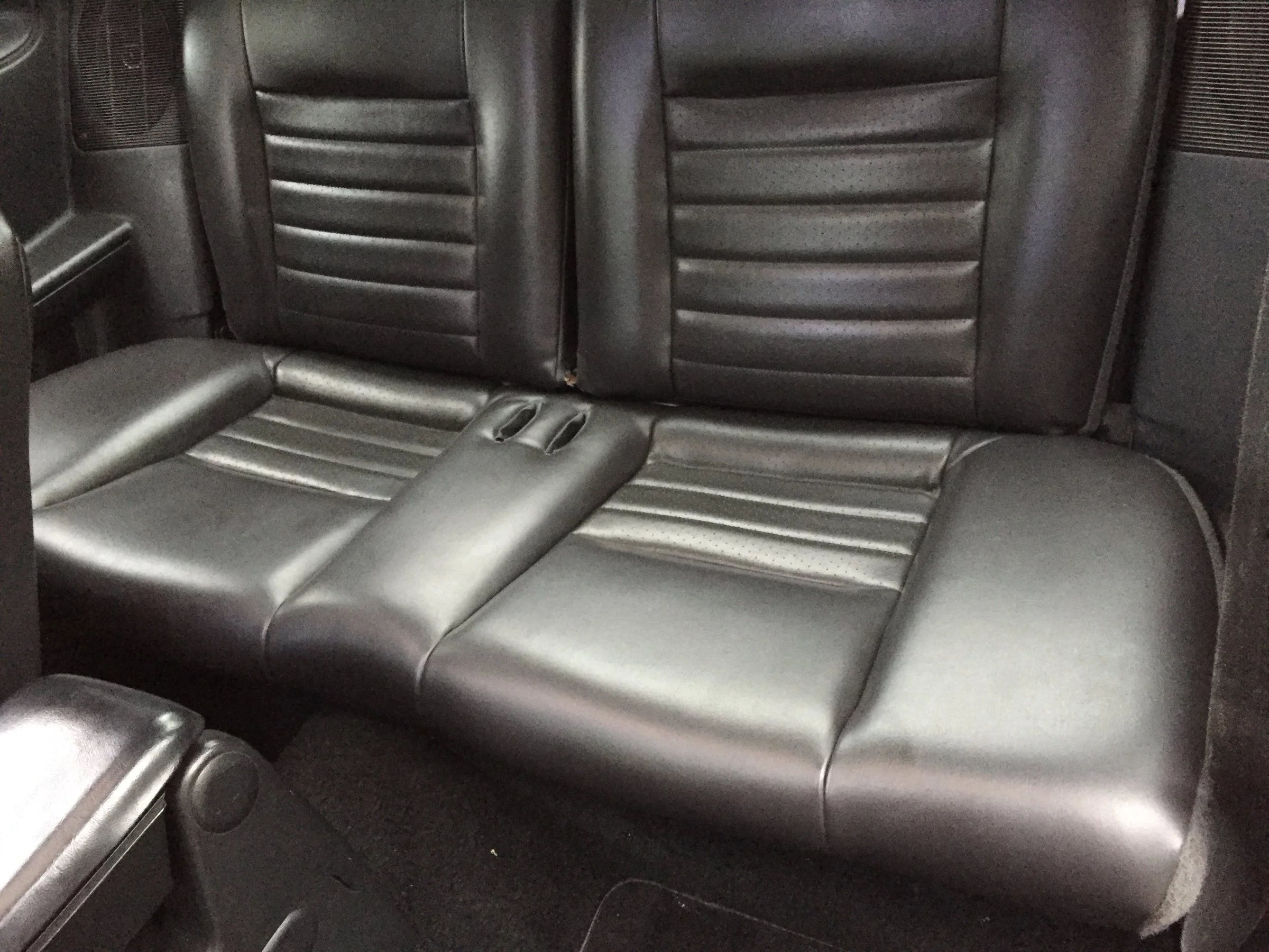

Maybe I'll just leave the SN95 seat in for looks and throw the fox seat in when I wanna take the kiddos for ride. I need to get seatbelt soon back in. Since finding 79-84 rear black belts is gonna be tough, maybe I'll snag some blue belts for now.
SN seat just looks better but doesn't really "sit" correctly

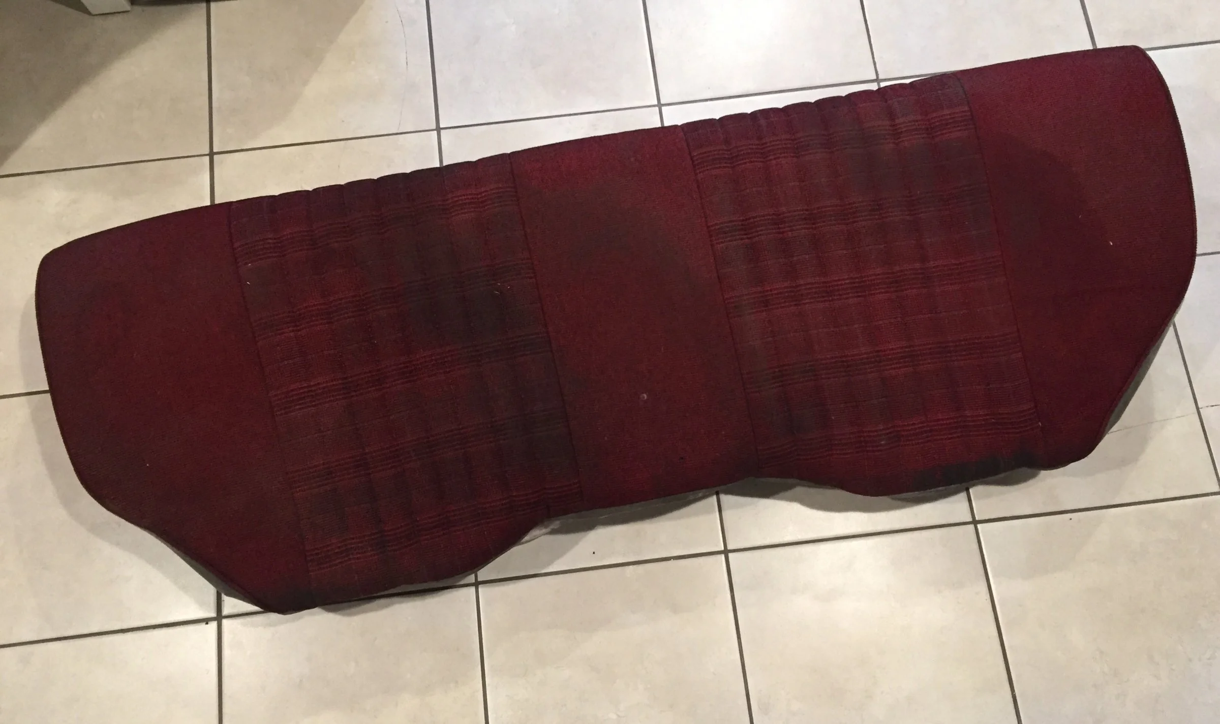

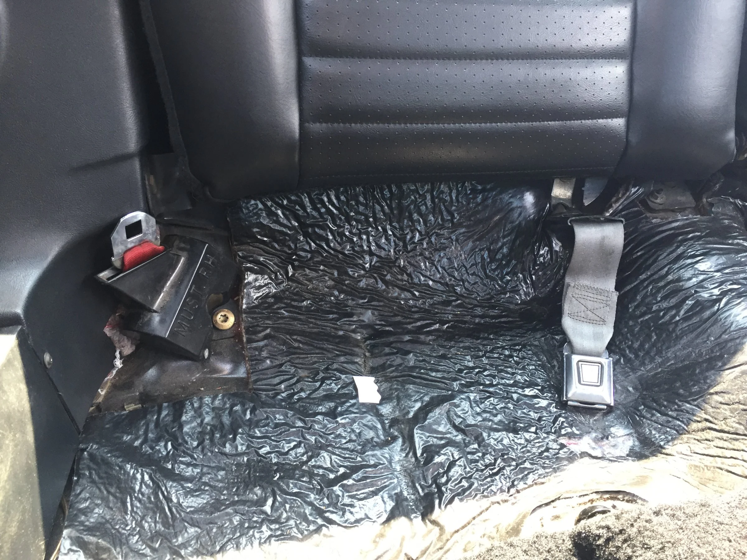

Ok. Got some seat belts in the car. Until I find a set of 79-84 black rear lap belts, I'll need to deal with the mismatch in colors. It's just nuts how much stock fox parts are selling for these days...even red.
But, i can now stick a car seat in. I'll use the red fox seat (which has been washed a dozen times so far) and go for a local ride with kiddos.

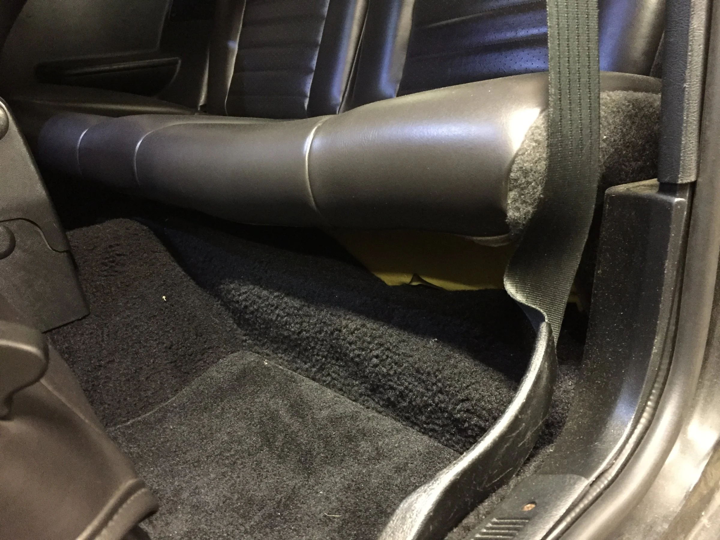

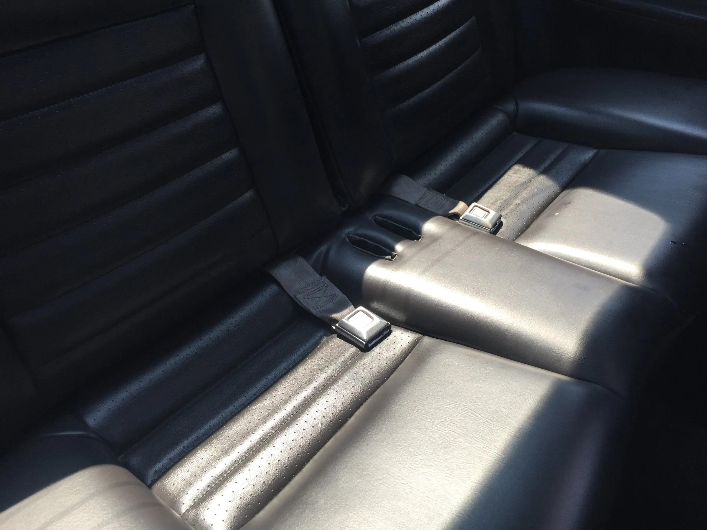

They don't tuck under the SN95 seat. Need to sit like this. Wish they weee black

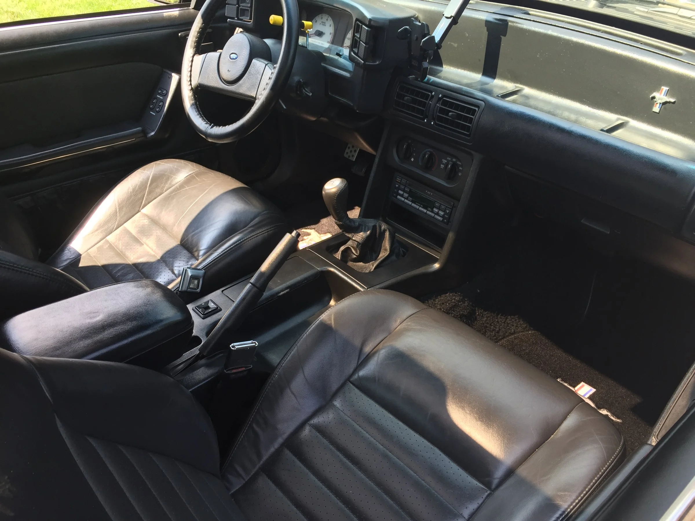

And front seat shot for the hell of it
