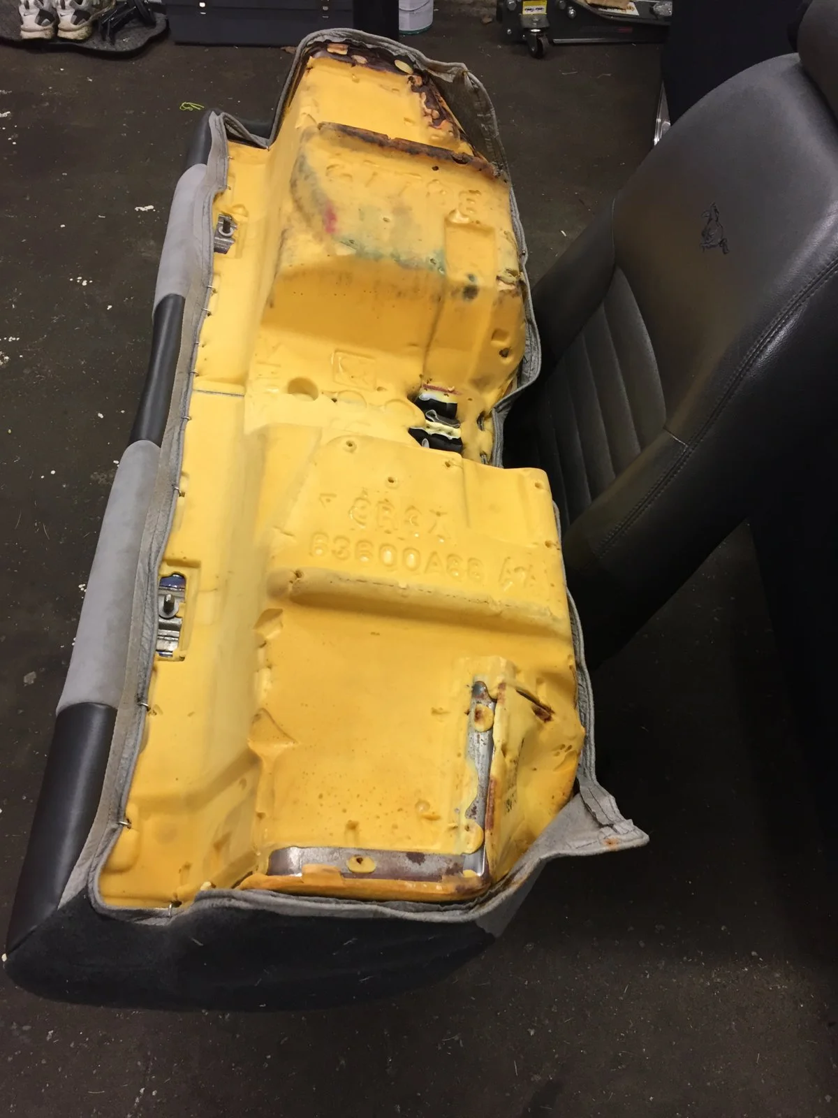

No. The seat bottom is held on by hog rings. You can use a set of wire snips to cut the rings and peel off the leather cover. The foam is basically molded over a steel frame, and that's what you clip the seat material to.
The SN95 seat backs unclip from the bottom and you can pull the foam frame out. Then you can slide that back into a new cover. SN95 seat backs are easy as pie, unlike Fox seat backs which were devised by the devil himself.

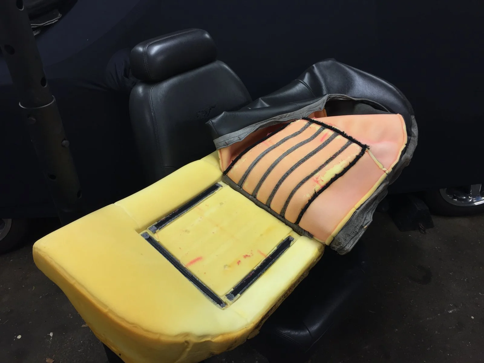

You can see how the material clips to the bottom foam. Some Velcro is used as well
I have done two convertible back seats, neither of which were glued. They were only held on by hog ring, and they were leather.

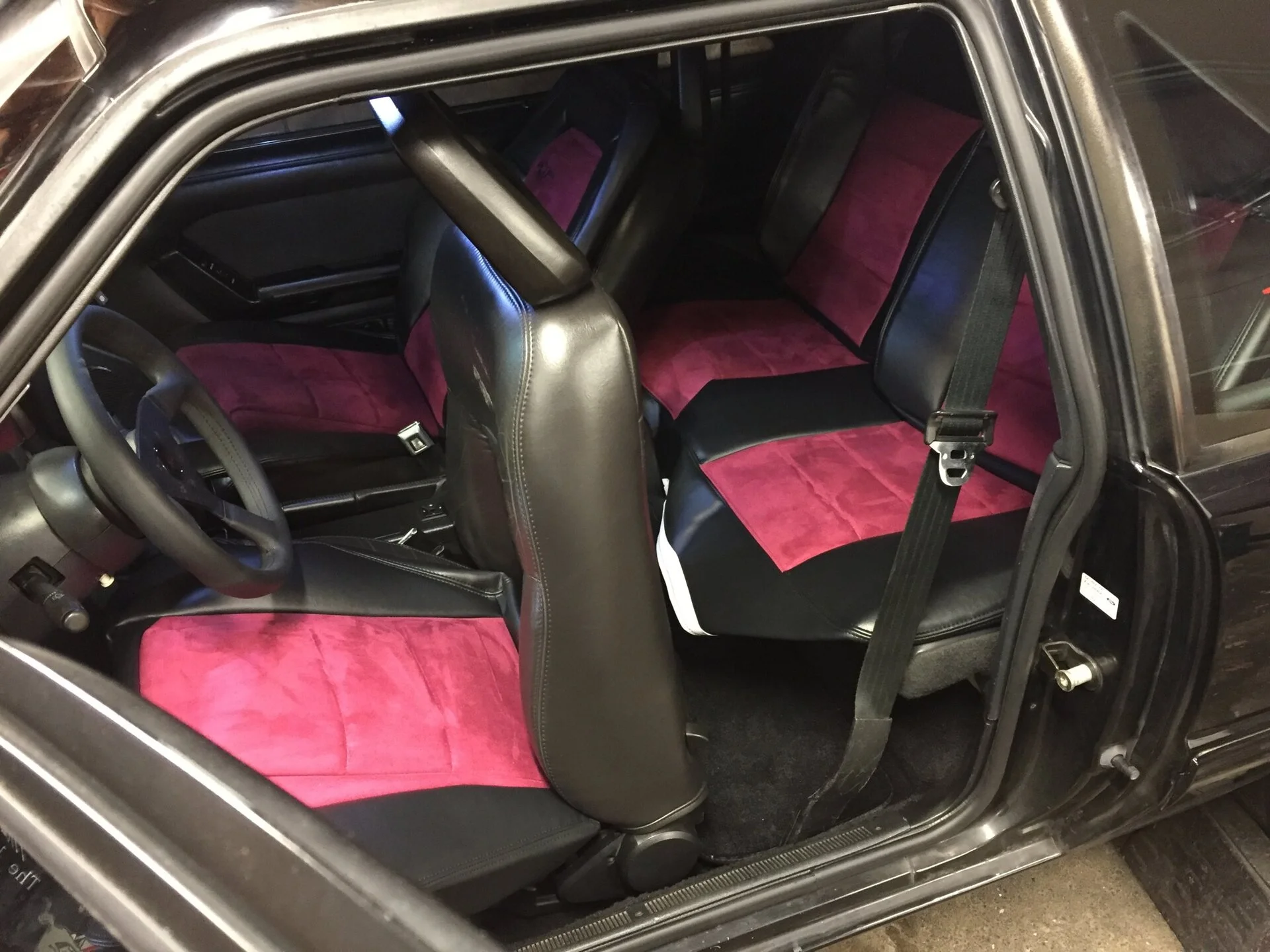

Some will remember my last TMI/CJpony experience. These were ordered as “Dark Red” inserts. The photos clearly showed them as being red like a nice dark apple. 8 weeks after the order, they sent me covers for a 66-67 Mustang. After a week trying to get a prepaid return label, I sent them back. Another 10 weeks later, this is what I got, and they didn’t understand why I wanted to return them. Dark Red. Right. I had to pay $100+ to ship them back.
(covers are just laying on my seats for photo reasons)
