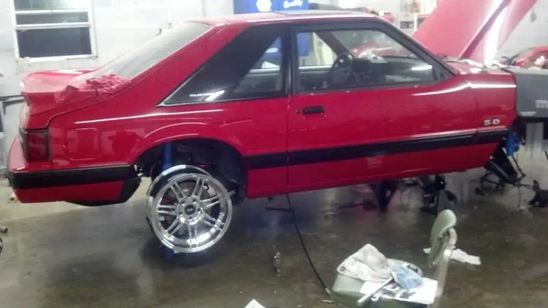

+1 for getting excited. It's been two years since this cars been running, and it's day is close. Heres a pic to relieve some of my stupidity lol. This is why I'm excited.
