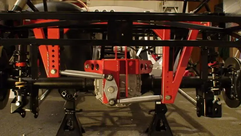

Im going to the 5 link watts setup LEVY Racing swears buy them on the Cobra Forum Guys that are running them say they hook the rear like never before. We had a three link in our FFR Daytona and it did very well even better with a spool the guys could beleive we was Roadracing with it.It just showed me how poorly our old posi was doing a good torenson or Detriot locker with shure help get the back tires working together.I love driving with the Go pedal :)
that stuff looks a little heavy for the rear suspension. It looks like you have to run an 8.8" rear end. But looks like they might have it set up right. Some modifications may be required to get the correct geometry setup when installing in a mustang.
They do run 8.8 and 9inch setups at Levy.I talked to Gordon he told me he has a solution for the 9 inch. I like TCP's also.I dont want the linked shocks but that set up looks nice.I think we can build that for a fraction of what ther asking for either setup.
