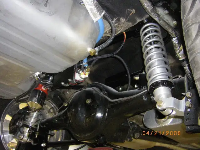

I have the Gbar but haven't taken it to the track. The ride is much more sure footed than the leaf spring suspension that was in there. I still need to play around with the shocks to adjust the ride quality. I am perfectly happy with it so far.
Install was easy but I did have to run the exhaust under the axle. I put in flanges at the back of the muffler so that I could remove the tailpipes if I need to service the axle.

got any pics of the install?
This was before the exhaust. I have one with the exhaust in but can't seem to find it right now. I think there is a post I put on here a while back about Gbar exhaust that has a photo.

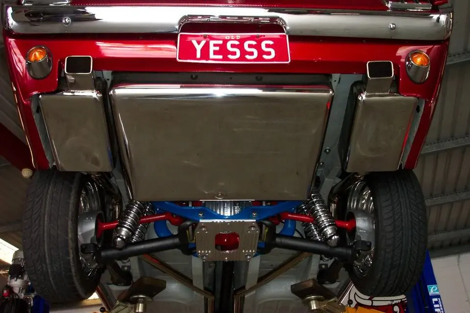

I can recommend a jaguar IRS, requires a small amount of underside modifications however the ride is truly excellent, corners like a todays car. I dont know about in the US but here in Australia a jag diff can be bought for around $1000.
