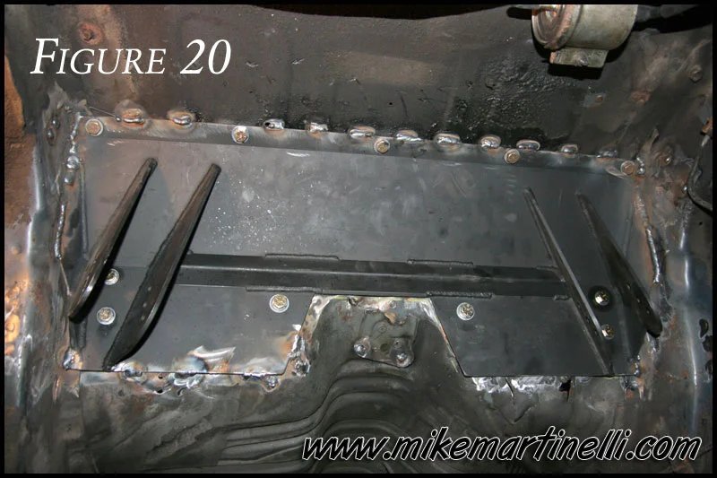

Depending on how bad they are you can fix them with "battle boxes" or torque box reinforcements fairly easy using only bolts. Then take it to a welder to have them welded. The sooner the better. If it is too damaged you may need the complete upper repair. I'll post a pic of my Fox torque box repair and the complete unit.

gearhead, is that a full-race car or a daily? From the axle side that hardware looks pretty hard-core.
That is a toy, mostly stock appearing Fox. The pic you are referring to is the only one that is NOT of my car. I posted that as a "what if my upper torque boxes are destroyed" option. You can purchase similar kits from several fabricators if your uppers are past the point of rescue. It is about $300.00 and I'm glad I didn't need it.

Gearhead, where can I buy that? IT sure beats trying to resurrect somebody's junk

Several companies make it and I am not advocating for any particular one. Below is one link.
