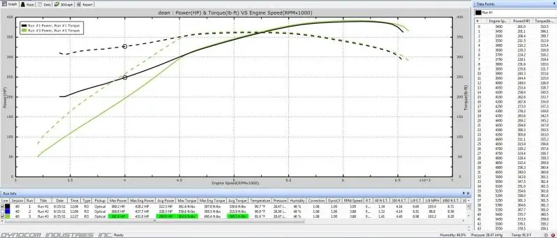

Previous tuner had loaded completely wrong data in the tune and hacked the MAF transfer to add fuel on top end , but the car was really lean at part throttle and tip in , look what loading the correct data in the tune did , picked up 53 RWHP and 68 RWTQ at 4000 rpms and even more below that over the previous tune
