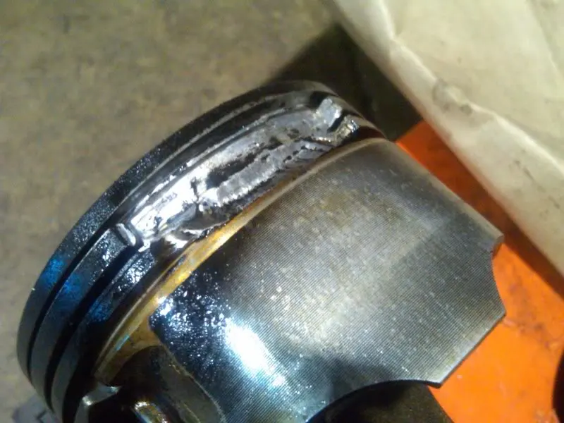

pulled the worst slug out the night i picked it up and it looked bad. the ring seats were destroyed.

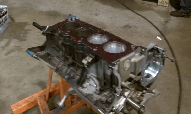

so last night we started with a shortblock and in a matter of about 3ish hours ended up with a long block!!

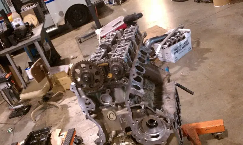

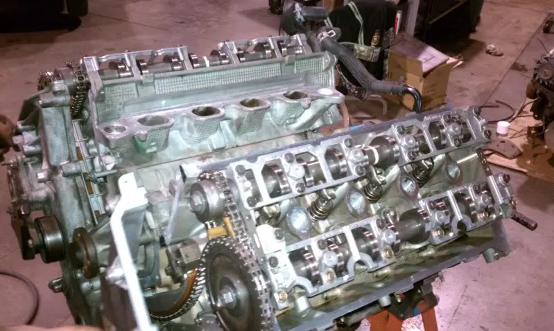

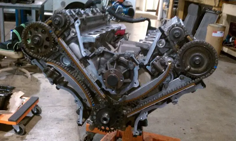

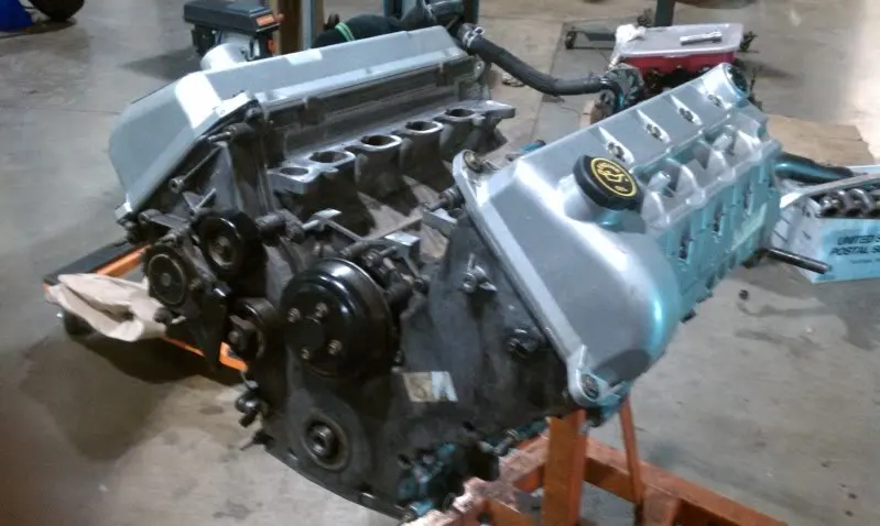

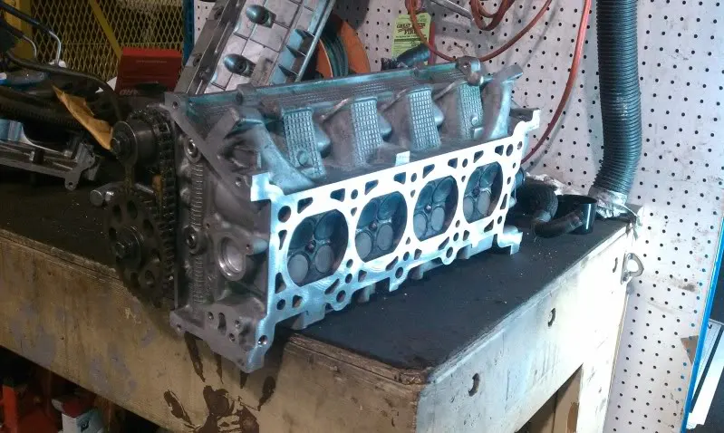

FR500 Cylinder Heads

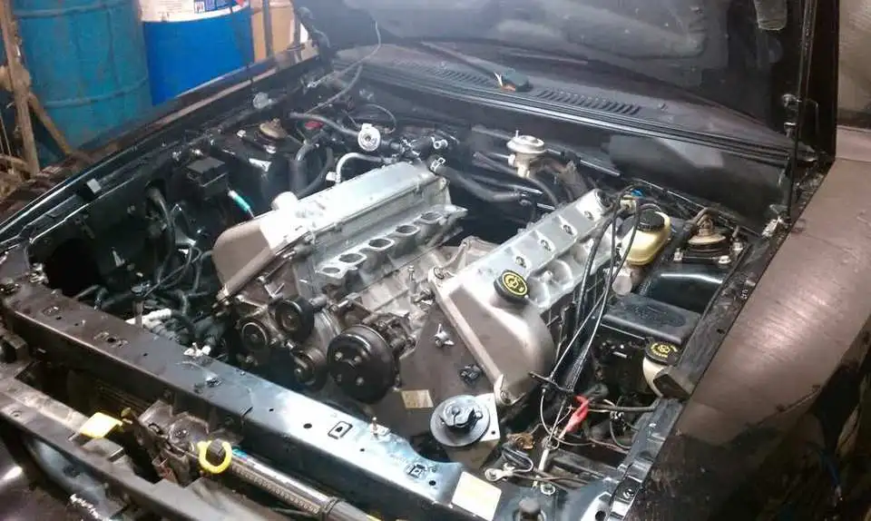

now i just need to pick my car up from where she has been sleeping with the rest of the parts in it. and shove this baby in. i am going to do my best to clean all the grime out of the engine bay while it is mostly barren too.
i look forward to driving and just enjoying this car again however stock it may be. i will be adding progress pic as well. i hope to have the car running by next week.
