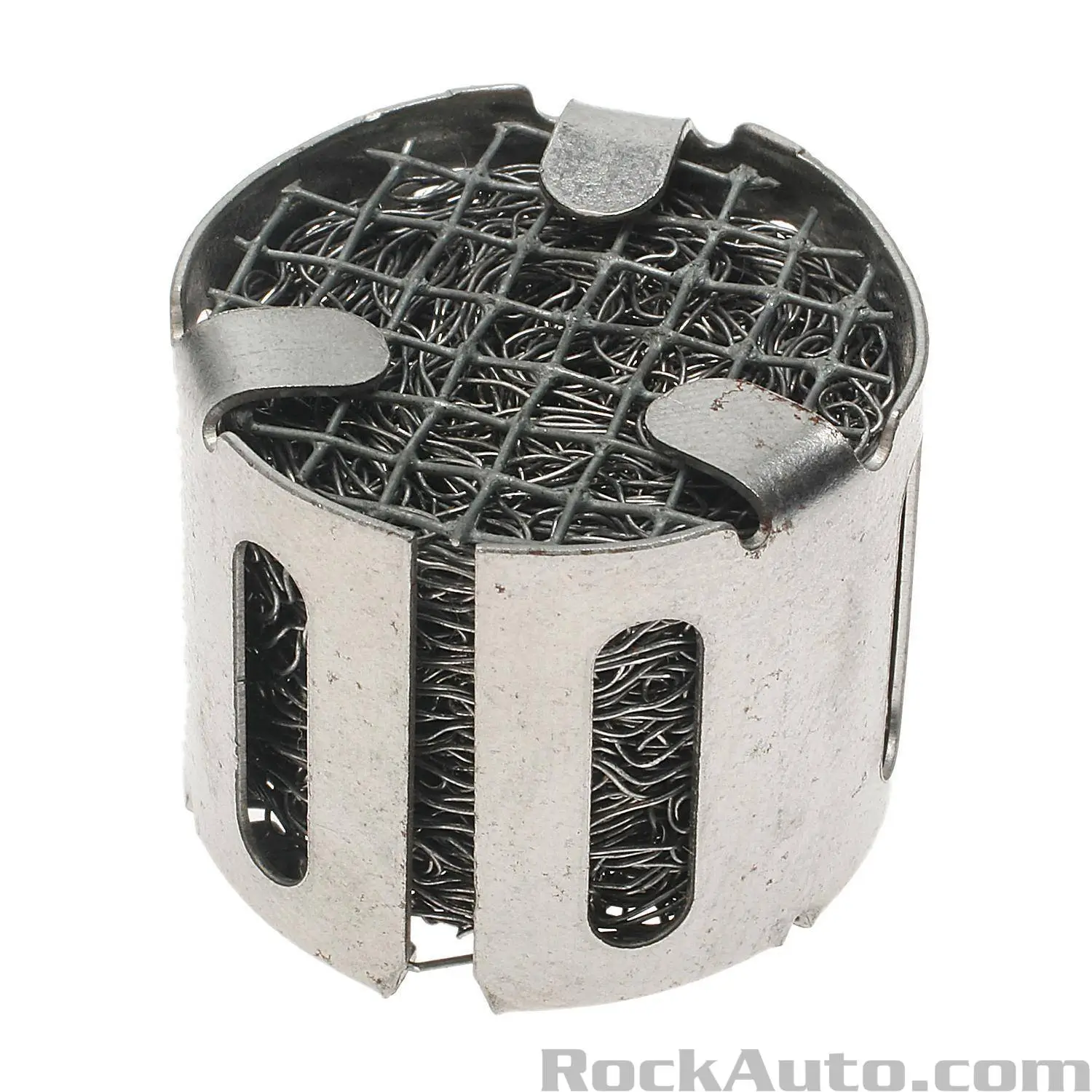

Did you have the screen under the PCV grommet? If not, normal engine vacuum in the intake will suck oil vapor from lifter valley and deposit it in the intake. Take a look where the PCV hose connects to intake. On mine it was right by the cylinder 8 and 4 at the rear of the intake. The screen helps precipitate the oil vapor out of the air.
