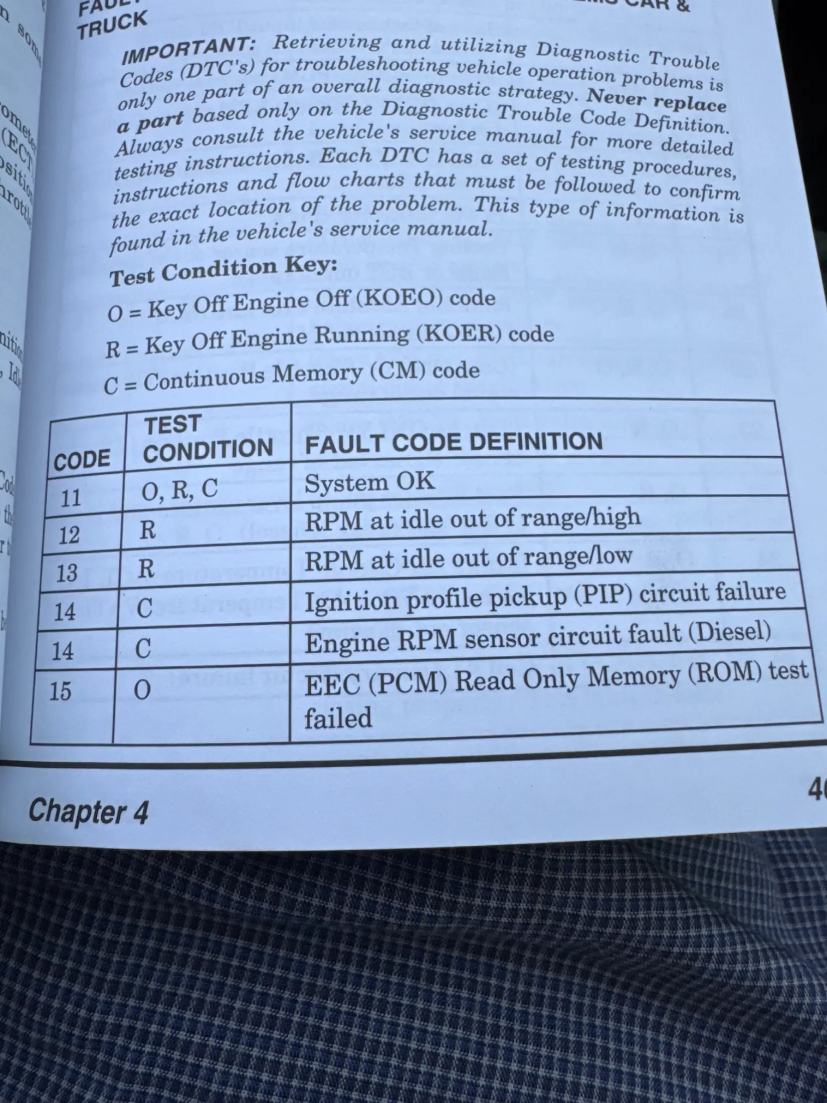

Code 12 isn't a code related to the airbag system?
This is what the book tells me. It’s my first time doing anything OBD1 so I may have been doing something wrong. Going to try and static reset the timing when I get off, in hopes of getting it at least running.
Interesting you'd get a "R" code when the car doesn't run. Is there a code 12 with "O"? when you ran the codes was the key on engine off? did you hear the car doing things/making some noises on its own? From what i understand you need the KOEO codes cleared before you can even run KOER codes, and then you need the car to at least be able to idle to run the KOER codes.
And you're probably right, i just googled "1994 mustang GT code 12" and a bunch of threads on the airbag system popped up, like low voltage to the airbag system or something.

The car “can run” with my foot on the gas. It misses and backfires while throttle input is severely delayed. It immediately dies when I stop revving or the clutch is released. I couldn’t get any codes with KOEO. I pulled that code 12 after it died when starting. Will re verify fuel pressure. The previous owner seemed to think it was the fuel pump. He bought one to replace, but said he never got around to it.
When you say you couldn't get any codes with KOEO, something doesn't sound right. You should get code 11 at least. Thats the computer telling you everything is good.
From my understanding you want to do KOEO first, fix/clear any codes so you get Code 11, then move on to KOER and fix/clear any codes there to get code 11 as well.

Went home and pulled codes again last night. This reader drives me nuts. With KOEO and clutch pushed in, the reader was telling me I have a 4 cylinder. I read that this is usually nothing and to ignore it. It would then generate code O 12. Which after some research it lead me to the IAC. I also noticed the purge valve vac line had dry rotted off of its connector so I re made that with a new hose and connector. Swapped the firing order around and it seems to no longer miss or backfire under throttle, but it still dies while going back to idle.
