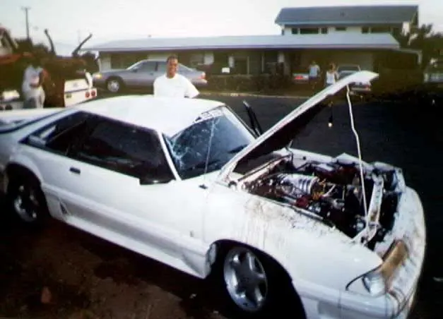

Check out the picture of my wrecked Mustang,the roof will have crush my head or neck if the rollbar are not there. It is insurance when you needed it the most..LOL
