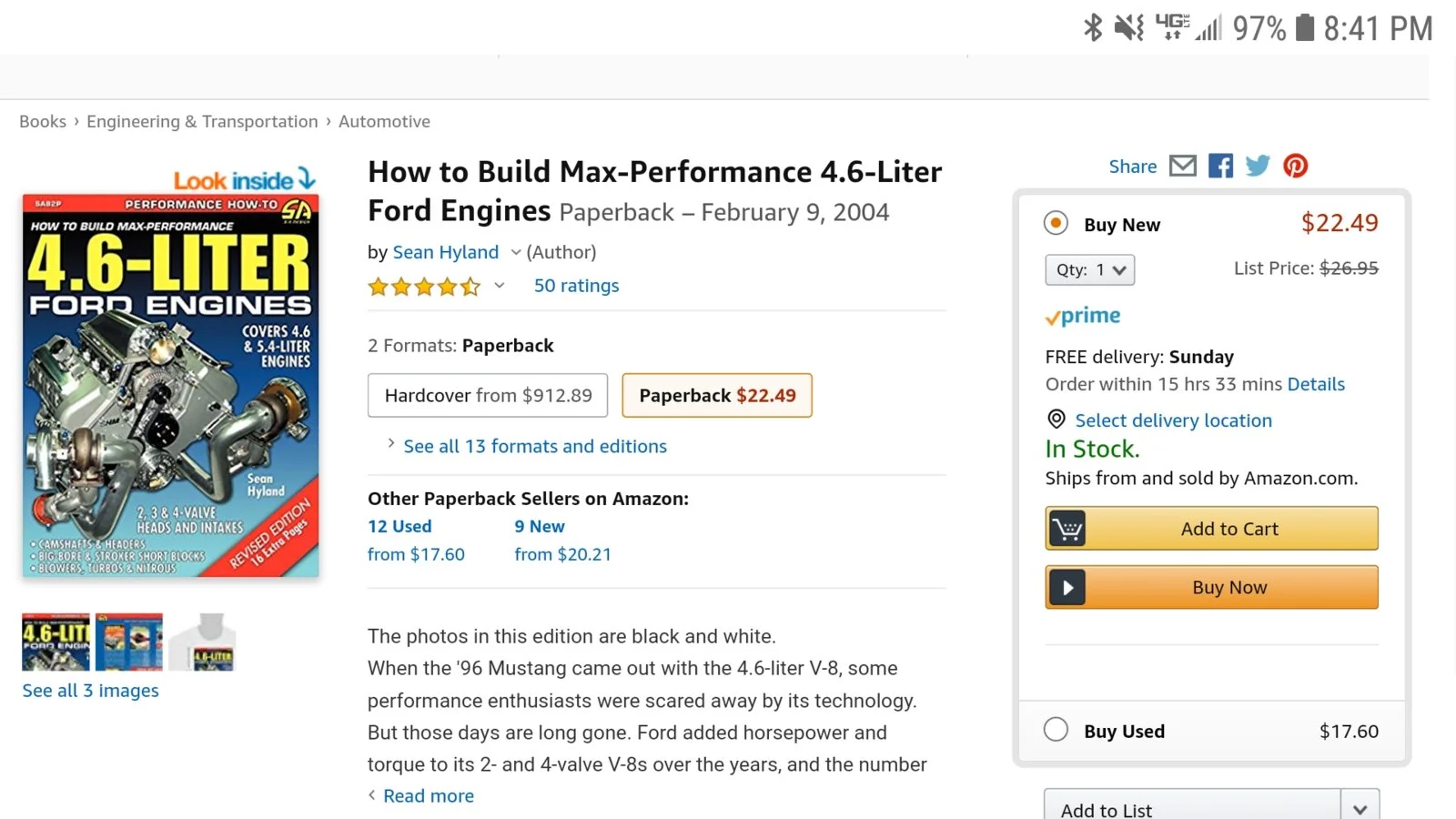

Start with internals and a rebuild kit before starting on adding power mods. I made the mistake of not starting there first. 12 grand later I'm having to rebuild the motor with forged internals. I'm hard on my car and love stop light to stop light acceleration. You can get away with factory internals but above 300 hp I advise building the bottom end, pistons and rods. Anything above 450 go with forged internals and a forged crankshaft. Everyone will have their own opinion but until you have been there and experienced it like I have most will just give their thoughts on it. If you want to build a 4.6 go and read the book from the picture I attached. This book breaks down the tolerances of everything the motor can handle and it's dead on.
