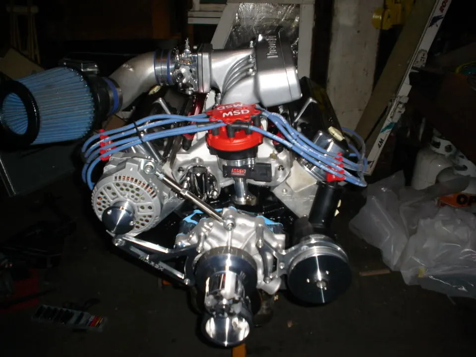

Nice engine!
I was telling the original poster what closed valves and base circle were (the same), to keep confusion down. Not you...
1/2-3/4" turn is plenty on his HR cam and lifters...no need to go more...
