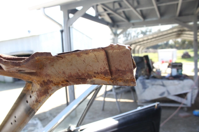

Okay, next question is, based on these pics, is there enough here to work with?
You will be removing the whole back sheet metal so that is no problem.
The front window frame may be trimmed a little to far forward,but still no problem .The kit has the piece that looks to be trimmed away ,it has the outer and inner wheel tubs as well .It looks like a perfect victim for a fast back, or a convert. I would not throw it out.
I have a thread for a 68 fast back conversion ,It is called , 68 coupe - fastback conversion.
This is the area i was talking about . It hasn't been trimmed in this pic so the outer piece has to come off ,the inner stops at that joint .Yours may have this area trimmed off a little to far but the window posts come in the kit ,i would just add this piece back from the new pieces ,that way you would not have to remove the front window posts .
