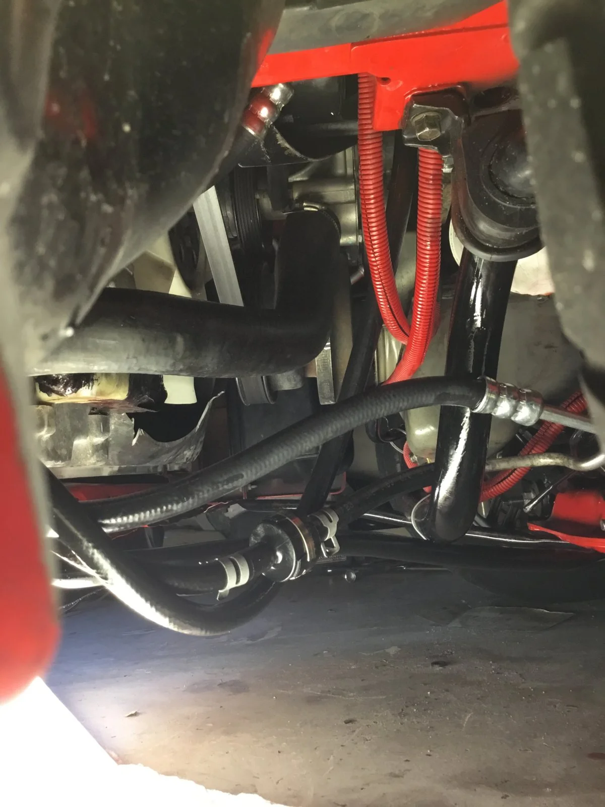

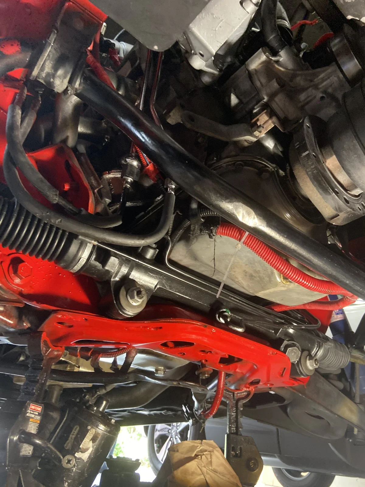

Inner tie rods come with the rack. If your rack is leaky and you can get a $80 one from Advanced it works out. I bought inner tie rods and threw them away after I needed a new rack. I only drive my car about 400 miles a year so I put mostly cheap stuff in it. Not selling so I really dont care. While under the car I cleaned everything up nice. This used to look a mess with dirt and oil from 30 years of leaks.
