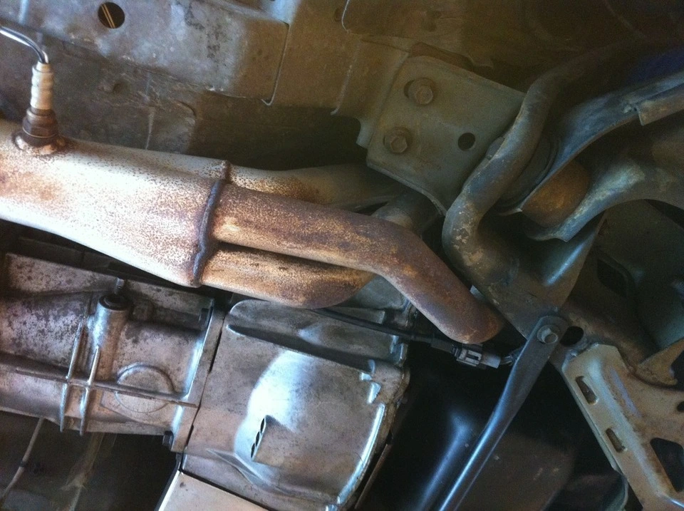

I thought I would go ahead and document the exhaust redo that I'm currently in the middle of on the Cobra. Before we came to Germany, I installed an all new exhaust with hooker super comp long tubes, Spintech 3000XL mufflers and SLP high-flow cats. I mainly did this so my car wouldn't be louder than the 95dB limit here in Germany. Long story short, the mufflers ended up being bigger than I thought, so they hang a lot lower than I'd like, and I found out the hard way that hooker's factory ceramic coating is of poor quality. They're also 1¾" headers, so they're too big anyway for my stock motor.
That all being said, this our last full year here; I got the last inspection done in February. This inspection will be valid until we leave and the car is shipped back stateside. Since I no longer have to worry about passing inspection, and since I'm tired of looking at the rusty headers and gigantic mufflers, I decided to start accumulating the parts to replace my entire exhaust. I don't have all the parts yet, I'm waiting on headers and mufflers. The headers are with @95steedamustang getting worked over and coated, and I'll be buying the mufflers this payday. I'm going with MAC long tubes and off-road H and Flowmaster 40s in stainless. My current tailpipes are the only parts I'll be reusing.

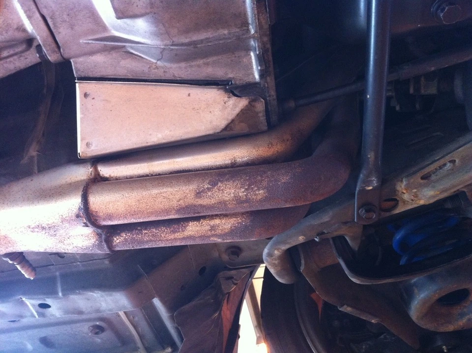

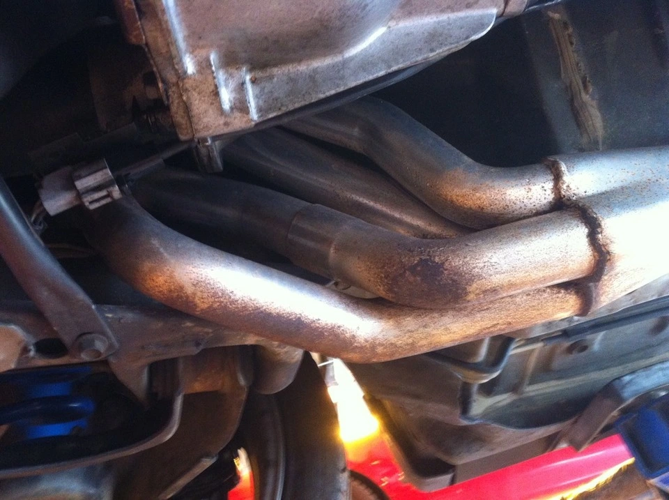

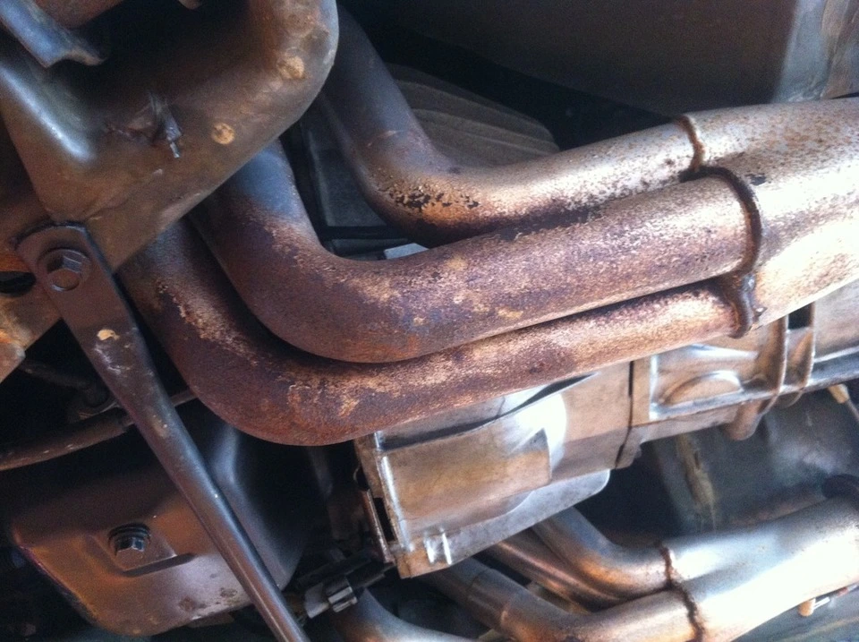

The current headers have been on the car for about four years now, but I haven't driven it that much in that time. The current state of the factory coating is pathetic.

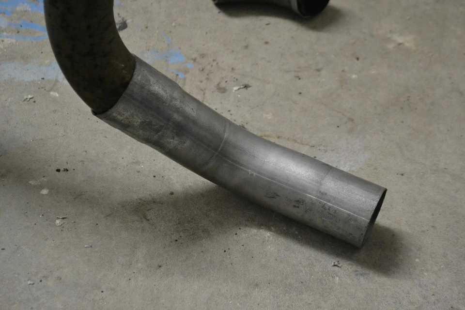

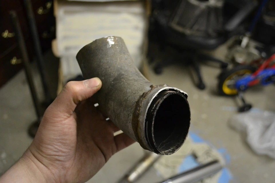

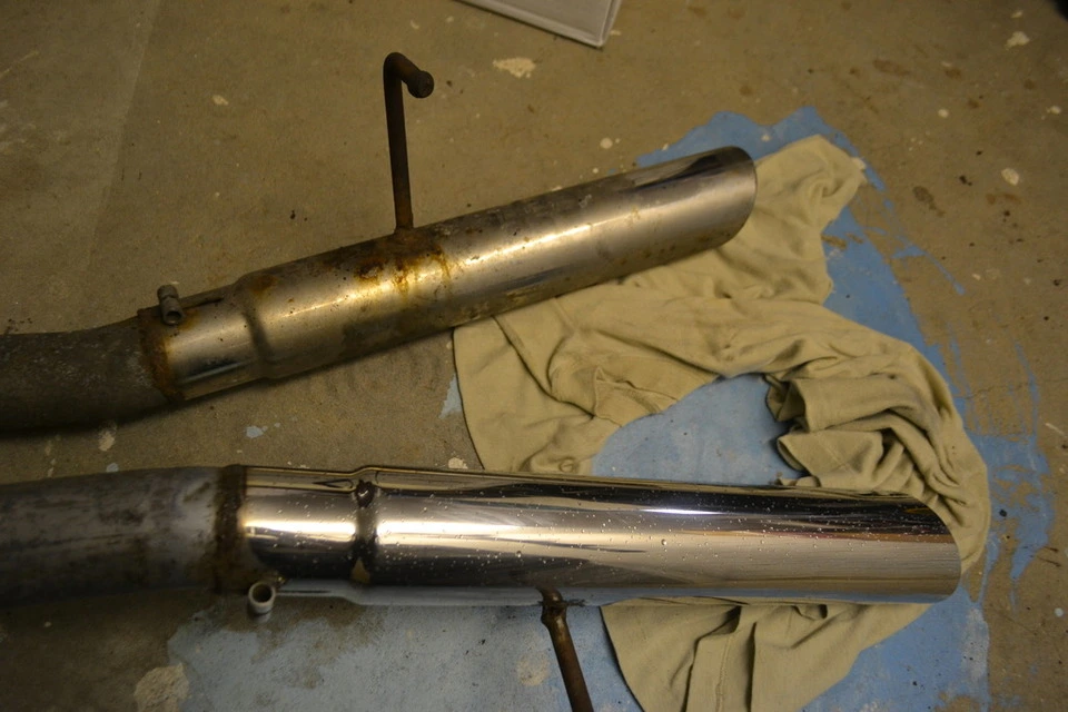

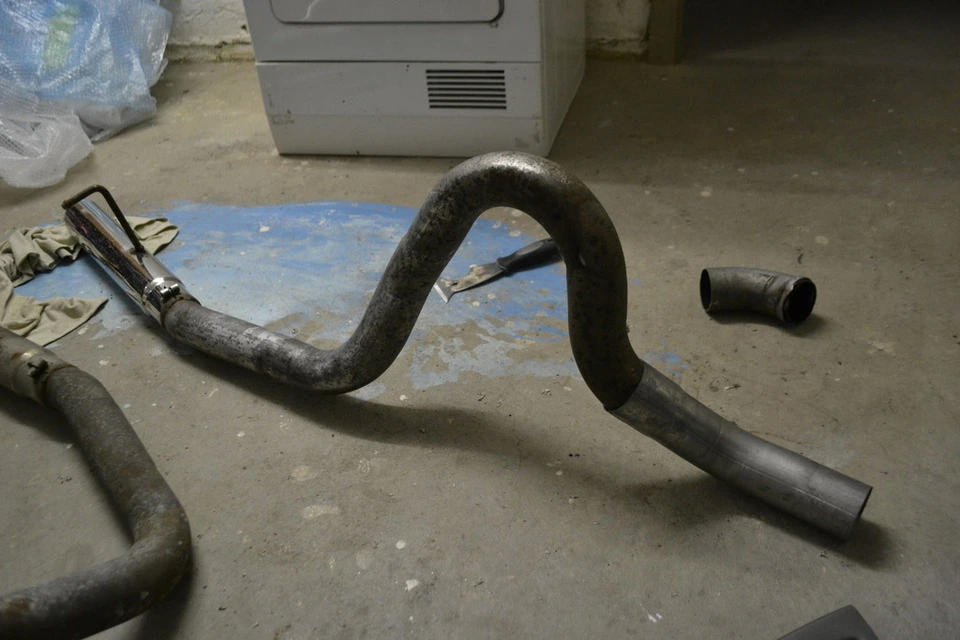

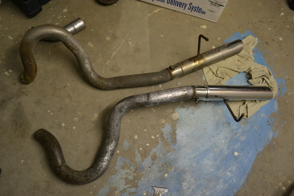

Because of how large the current mufflers are, the exhaust shop that originally installed them cut a significant portion of pipe from the tailpipes at the muffler end to get it all to fit. This meant that I didn't have enough pipe left to slip into the new mufflers once I install everything. I ended up buying a pair of 45° elbows and cutting a section off of the tailpipes to give me the necessary pipe length. I may still need to trim the elbows a bit so I can mount the new mufflers high enough without having the tailpipes hit the floorpan, but this should work.

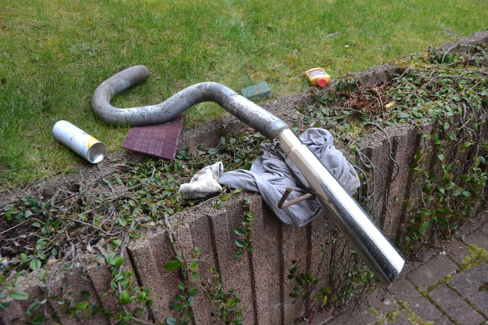

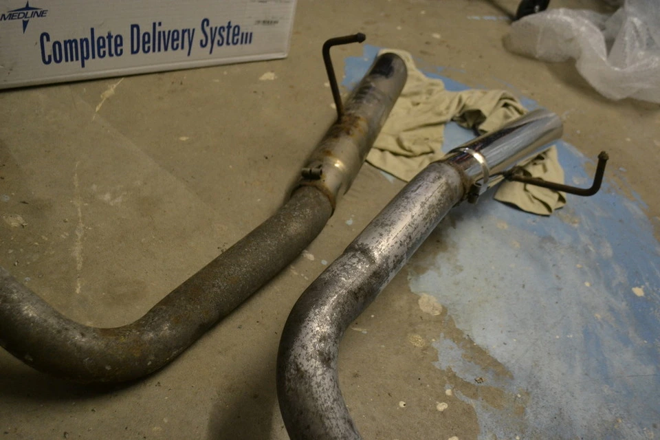

The tailpipes also needed a cleaning very badly. The Germans love their salt in the wintertime. I usually park the car over the winter for fear of it rusting. Most cars more than ten years old around here are eaten up pretty badly.

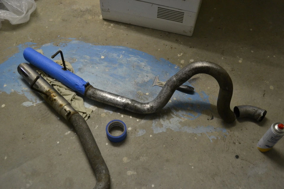

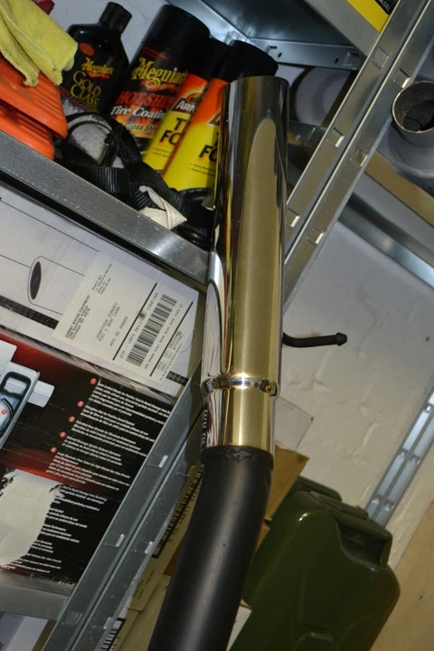

In the process of cleaning one pipe and polishing the tip.

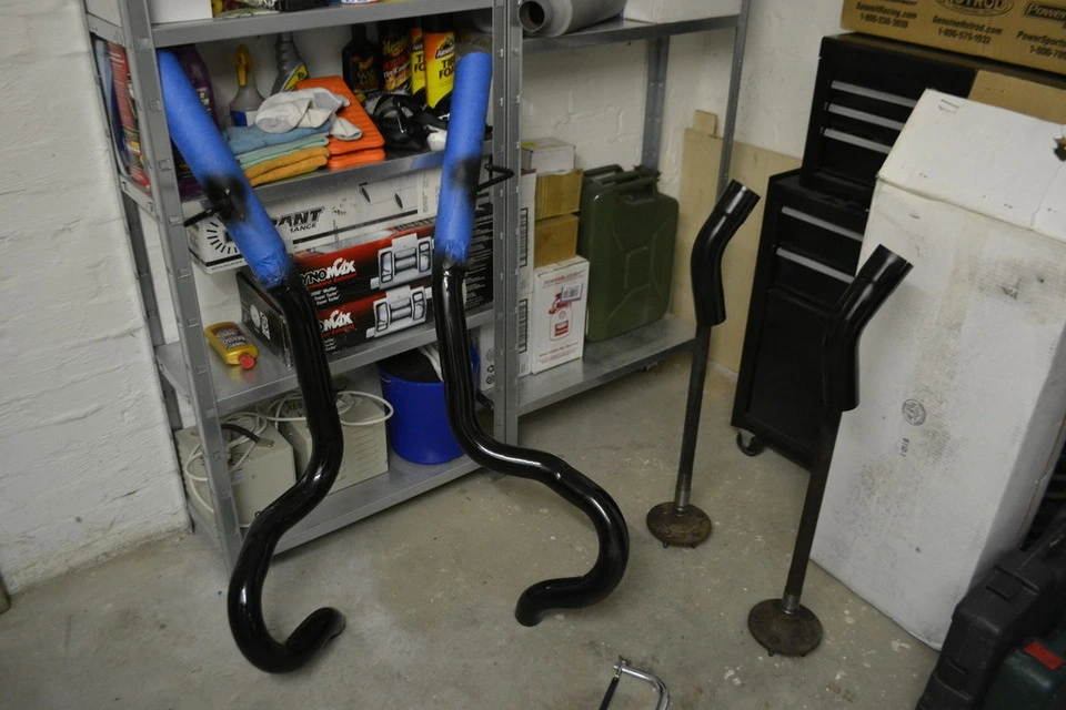

I'm really just getting the majority of it cleaned and sanded enough to lay down a coat of paint. All the new parts will be painted in high-heat black. I probably should have bought a flapper disc, but oh well. As long as it doesn't rust.
Bremsen reiniger. German brake cleaner. Just as good as the American stuff.

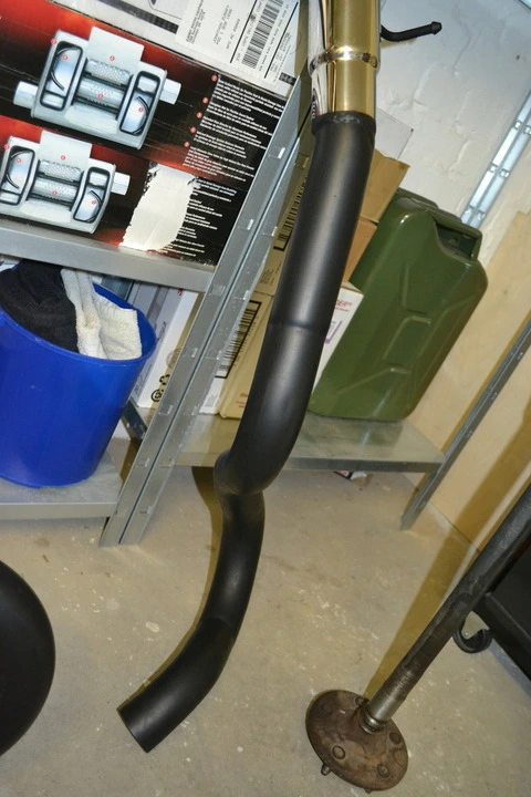

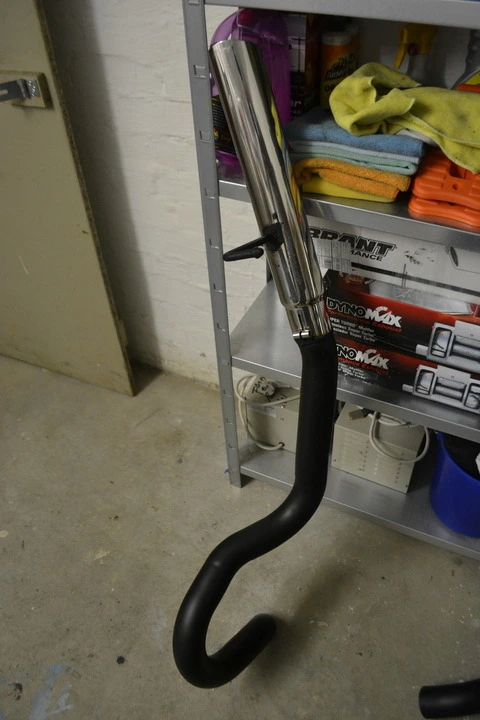

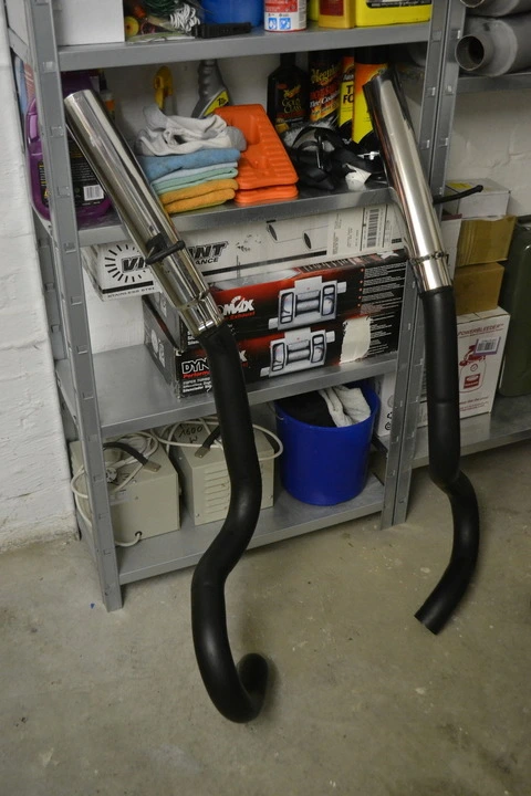

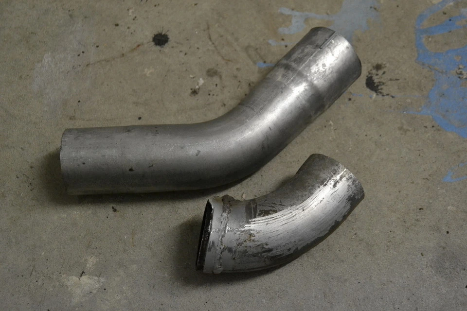

These tailpipes were pieced together from Dynomax 2.5" aluminized tails for fox bodies with the 18" long tip added by the exhaust shop. I really don't like the way they welded on the hanger. I wanted to just get another set of these tailpipes and use some new tips I have, but Dynomax seems to have discontinued them. They only disappeared from Summit Racing within the last couple of weeks. They were really cheap (about $51 per side) and fit perfect.

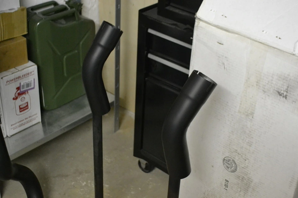

I got everything cleaned up to the point at which I was satisfied, and shot everything with a single coat of high-heat paint. This stuff is good to 800°C, so I think I'll be fine.
Nice and dry.
That's pretty much a stopping point for me until I get the headers and mufflers. I also bought Walker 2.5" flow tubes, heavy duty flanges, heavy duty clamps, adjustable hangers and hardware. My goal is to install everything myself with clamps for now, and have it welded when I get back stateside. The typical exhaust shop here has labor rates around €60/hr, and then charges a crazy amount for the actual welding work. Having all this stuff professionally installed would probably cost me close to €500 or more even with me supplying everything. I can't wait to get back to the USofA.

When I started looking at your headers my first thought was "Those look like they took a salt bath." I'm actually surprised they rusted that bad though they look salvageable from the pics. I like the high temp paint idea and think I'm going to steal your idea for my tails. :nice:
Reactions: 02 281 GT
^^This. Wow. Man I've had several sets of hooker super comps and never, ever had a set rust like that. Then again, I live in southeast Texas with no snow or salt. In fact, I've yet to find a header made better with the exception of kooks. If those hookers rusted that bad there the macs should last about a year..
The new stuff looks good man. I had a truck I painted the exhaust on it like that, and it got a lot of compliments. :nice:
It may just be due to the salt. Though I avoid it as much as I can, I've had to drive it in the winter a few times. The finish inside the engine bay looks better than the underside, so that may be a clue. Although the coating hasn't fared well, they are very well put together headers.

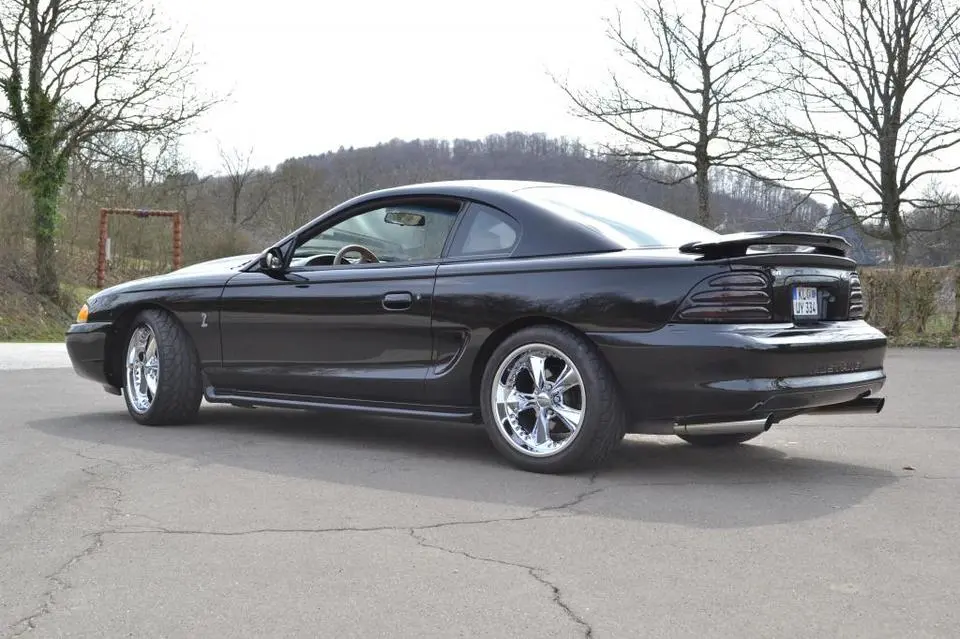

I was always under the impression that that stockers were 2.25" all the way out the back. They look really tiny even compared to aftermarket 2.5" tails. As you read, these are unfortunately discontinued. And yes, you can see the weld point, but it's tucked back by the rear tire; now it'll be painted over as well which will make it more difficult to see. That's the reason for the 18" tip. It's the longest tip you can put on there before the first bend by the gas tank.
Edit: here is a pic with the tailpipes still on the car. It's kind of a easy to see where the tip is welded, but it'll look much better with the black paint job. One of the advantages of piecing my own tails together is the upward angle I had the exhaust shop do. Just looks better that way.

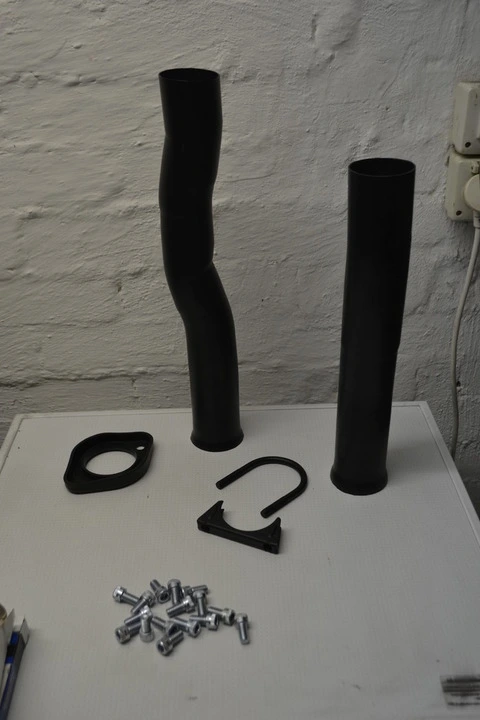

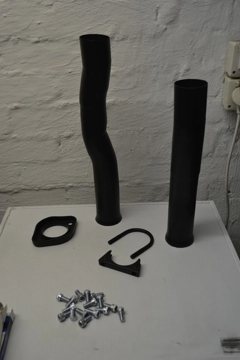

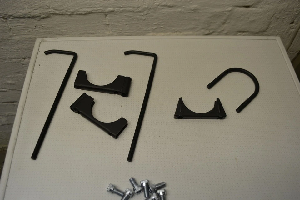

Some of the other supporting components. New flow tubes, flanges, clamps and adjustable hangers.
We'll see how these Pypes adjustable hangers work. The u-bolts were terrible, so I'm going to use a couple of the u-bolts from the eight heavy duty clamps I bought. I've painted all this stuff black as well.

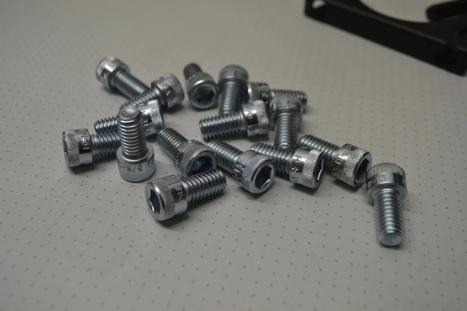

I bought these to use instead of regular header bolts. 3/8-16x3/4 zinc-plated socket cap screws. I ordered 50 since that was the minimum order quantity.

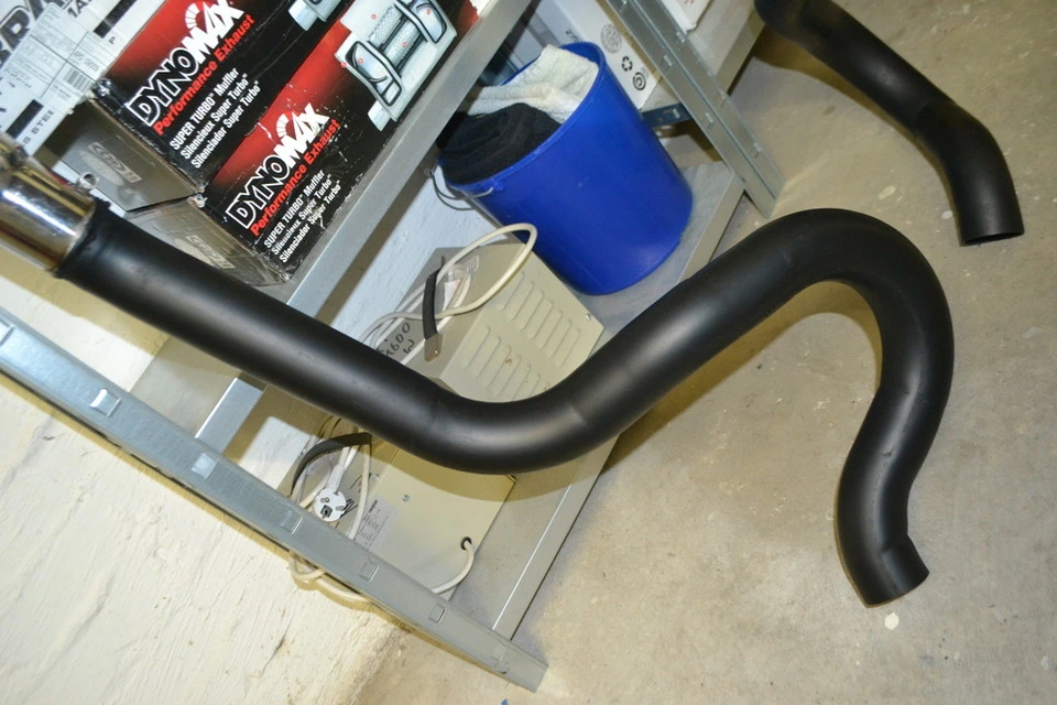

Really happy with how the paint turned out on these. Not perfect, but it looks pretty good. My goal with the black paint and tucking the new exhaust as high as I can is to make it as difficult as possible to see the exhaust from a casual observation.

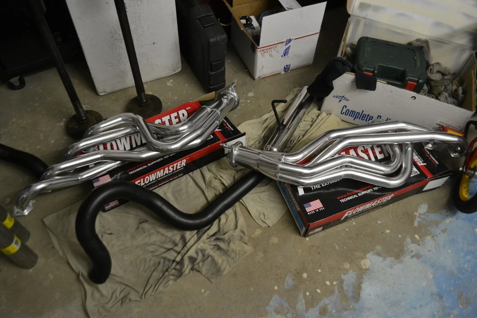

Finally received the last two, and most important, pieces of my new exhaust puzzle: mufflers and headers.

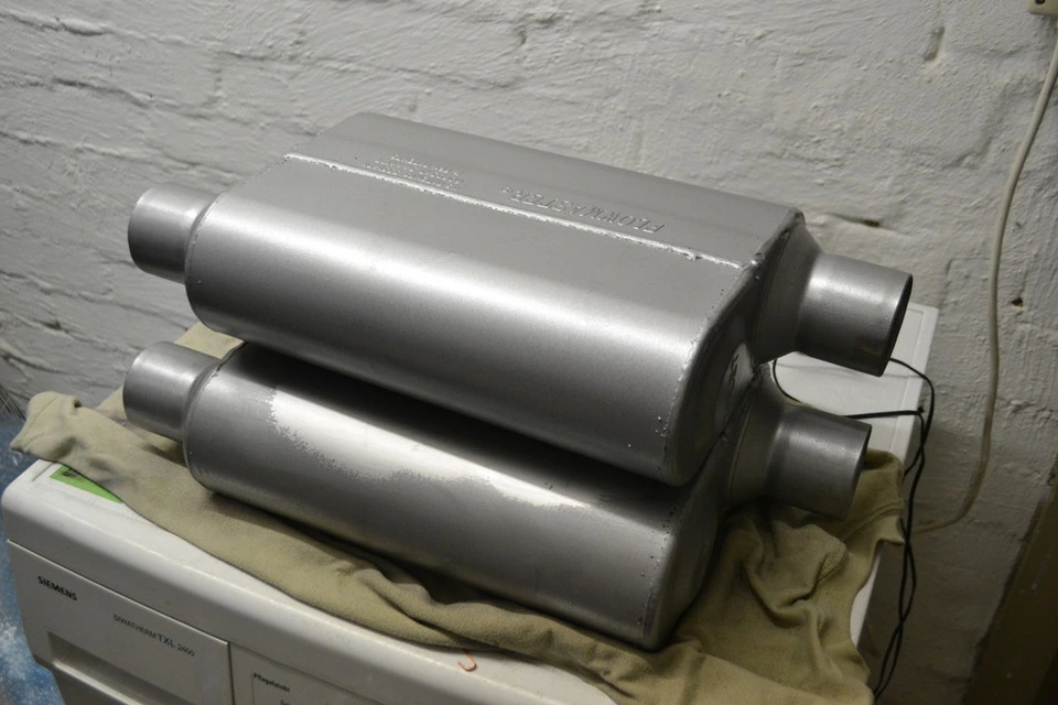

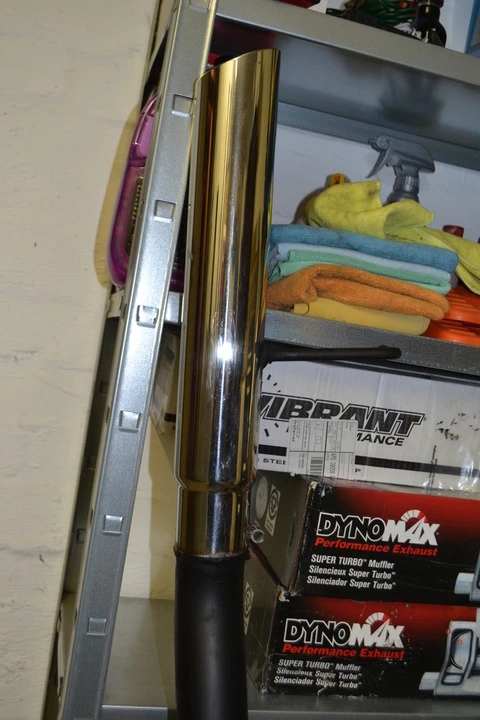

I have a pair of Dynomax SuperTurbo mufflers in the basement that I didn't really want to use, so I decided to get a new pair of Flowmaster original 40s. I sprung for the stainless versions as they're a paltry $5 more than the standard aluminized. They come with a factory coat of paint, so I'll strip the paint off these and spray them to match the rest of the exhaust.
I'd polish them up if the rest of my exhaust were stainless or ceramic coated. I've already removed some of the paint from one of them.

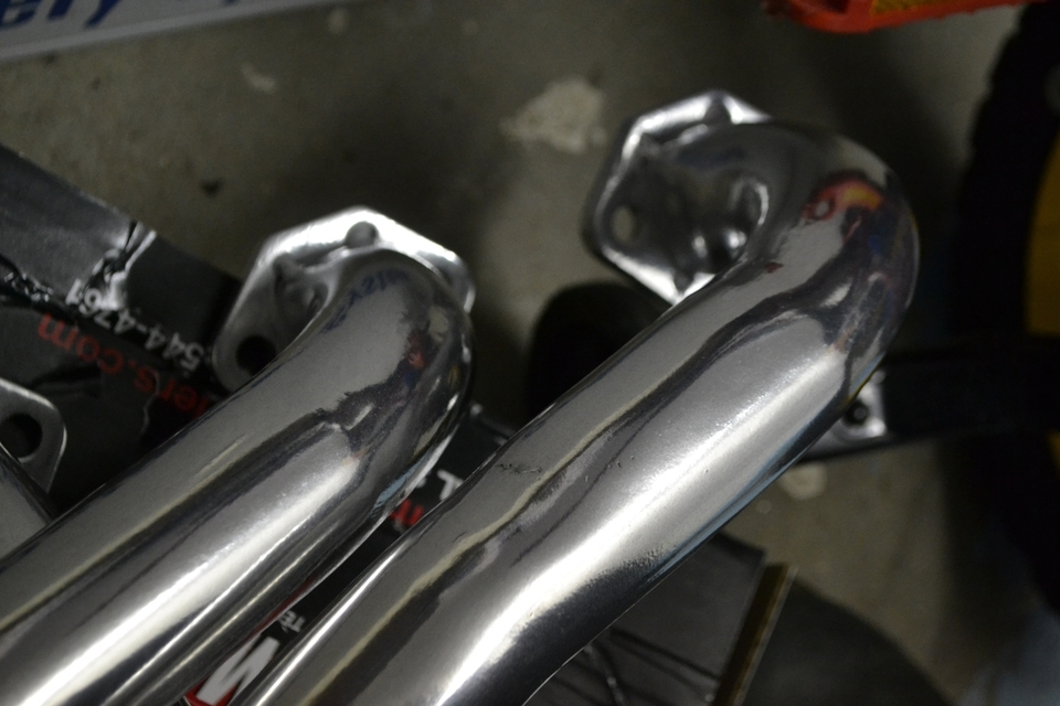

The headers. The EGR bung was removed and they were blasted and ceramic coated by @95steedamustang. They actually came with some nice looking copper gaskets instead of the usual paper crap. I'll probably use them and see how they turn out.

I've had bad luck with the copper gaskets. No problems with regular ol Felpros which usually seals perfectly. Those headers look great! Makes me wish I would have done mine when I ripped my motor out. Maybe this winter
I thought everybody just used RTV as a sole gasket on an exhaust header (least that's the way the "Boy's round here" including me have done it for years)

I've had quite a few people suggest that.
I've simply never tried that before; I'm a bit gun shy about it. I tend to make a mess when I use RTV and I really don't want to miss a little spot and end up with a leak.

I was the same way back in 1990 when (after developing a leak using a standard HG) that somebody told me about it. Been doing it that way ever since.
Just put a bead of high heat copper on the exhaust port after you get the header up in there, allow it to "skin over" about ten minutes, and stick that dude up there.
Hell, for that matter, as long as you have smeared the port on the head, and the tube w/ just enough to completely cover the circumference of each opening, dont even worry about a "bead" I just put some on my finger tip and just skim coat each surface.
