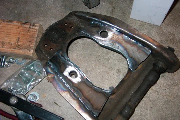

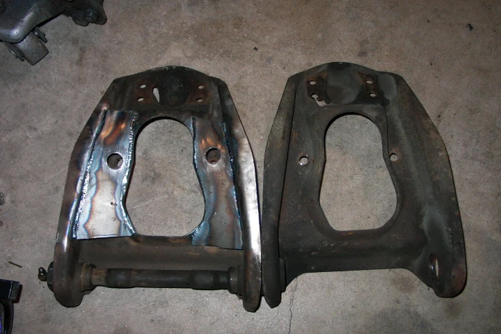

Here are some shots of the reinforcement plates I welded into the stock upper A-arms.

Good point. I also decided to change the upper ball joint angle by cutting the UCA's; cutting, bending and welding to suit. Hope my trig is up to snuff. Just couldn't justify the $270 for the negative wedge kit when I could backyard engineer it myself for next to nothin'. Didn't know that the weak point was near the ball joint area. Hmmm.
