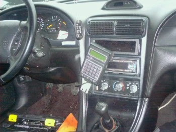

is it possible to move the a/c, fan speed knobs and stuff, and move then underneath the radio? id use the knob location for holding some gauges.

Thats exactly what i did, i havent made the knobs fit permanently down there, i just kinda squeeze it in there and it holds. Once in awhile it comes out though. U just gotta take out the radio and the knobs and panel, and move everything down.
Its really easy, i have summits digital gauge in there...i love it. I need to get some pics up

I'm telling you, you do not need a write up. A guy on the corral told me the same thing. Take the trim off, get the radio out, then take off the a/c panel and u will see how u take out the screws to disconnect all the lines for the switches on the back, then just run the lines down to the bottom, hook everything back up and either sandwich the a/c panel into the window or figure out a way to mount it.
Here is a pic of mine when everything was still kinda in pieces...u can see the gauge from summit up above in the old a/c panel slot....its black when off and lights up with blue digital numbers for volts, oil pressure, and water temp. I love it. It matches my radio and STOCK FACED speedogauge perfectly since i replaced the lights behind the speed with LED lights so it lights up a real nice Blue now. And the summit piece even has warning lights for high and low readings.

thats mine, i screwed mine in though, after i cut off the mounting tabs which i later realized would have helped me. oh well...
Where did u screw it into? I've been using the sandwich method which is a temporary fix. Did u screw from the front?

eh i just looked, apparently i countersunk it in the hole and siliconed it in, anyways its solid as a rock..
