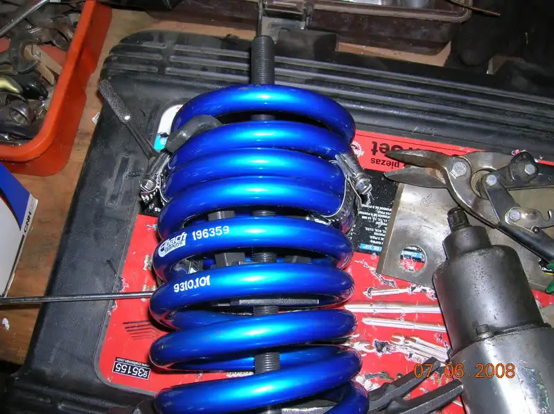

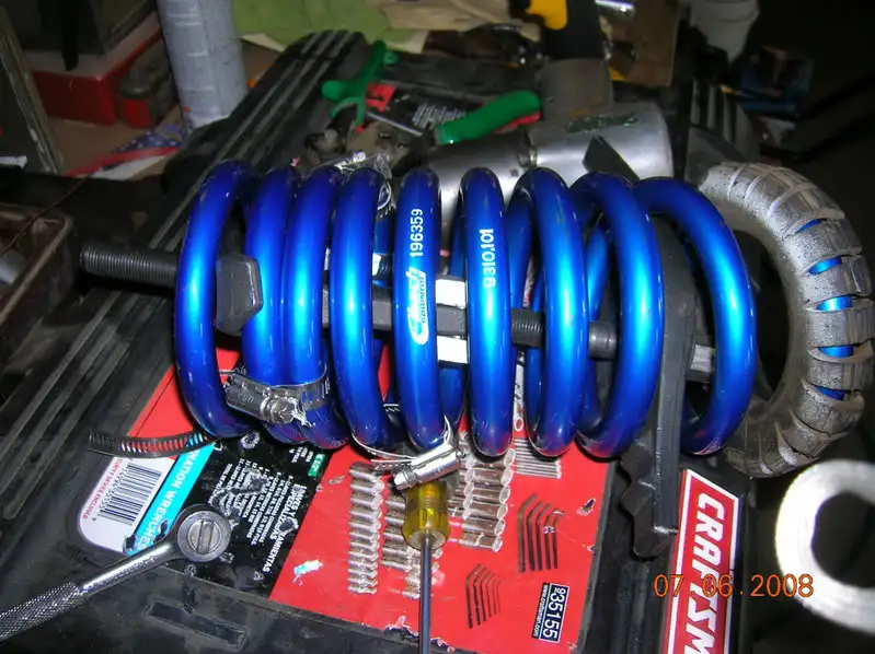

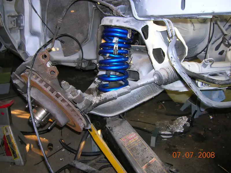

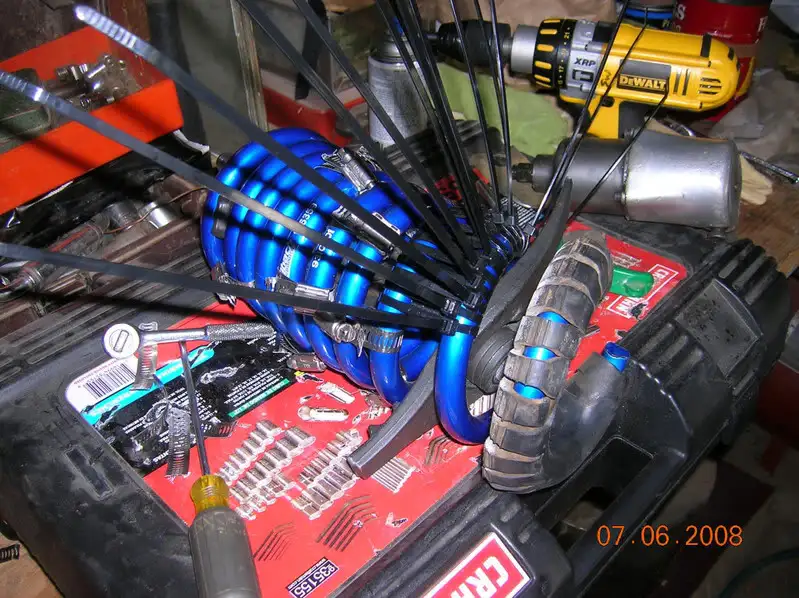

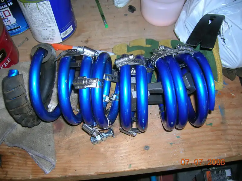

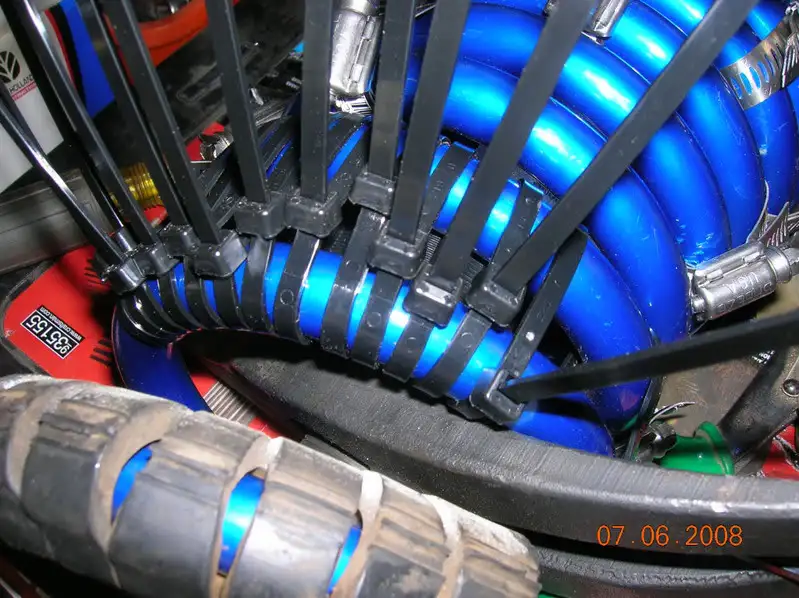

ok well as i promised, i took some pictures of, "the hose clamp method" for everyone to check out... i dont wanna hear it. but here it is...
first, jack the car up by the crossmember, let the a-arms sag. unbolt the strut from the shock tower caster camber plates. if the a-arm is hanging as far down as you can get it you can pop a stock spring out pretty easily, i just put a 3 foot prybar in there and jammed it out. prolly not safe, but thats how i did it...

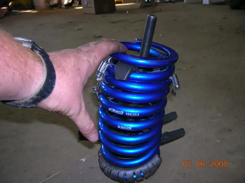

i then used a spring compressor that went up through the center of the coils to compress the spring down to about a foot in length.
i then used hose clamps on the coils, two per coil, evenly distributed so the spring doesnt flex.

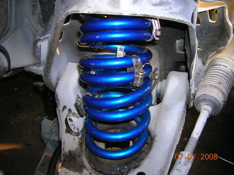

unfortunately i ran out of hose clamps half way through, so i called 1sickfox and he said i could use zip-ties instead of hose clamps.
lol, stop ****ting your pants jason... i was only kidding. here are the springs compressed about to go in.

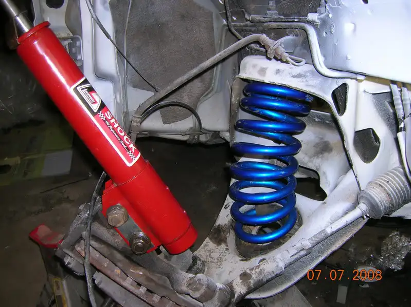

put the spring in place and jack the arm up until the car is supported by the spring

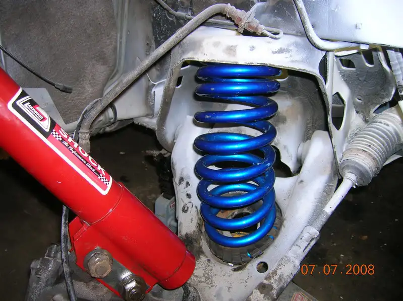

use a sawzall with a metal blade to cut the hose clamps off, the springs will pop up and make a spooky noise, but it seems to be fine.
cut free all the clamps and let the arm down, and your done...
total time taken for install... about 45 minutes to an hour.
remember guys, dont hate, debate.
