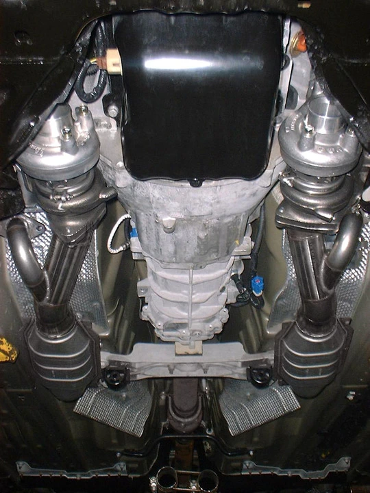

These look pretty cool. The two concerns I had were:
1. The turbos seem pretty unprotected under the car.
2. The examples I have seen had the air intakes right on the turbos UNDER the car. Seems like a recipe for additional dirt and possibly water ingestion.

This seems to be what you're talking about. Notice the current difficulties they are running into. I have not seen a working turbo system yet for the '05. Be wary of those saying they have one (non racing of course).

This setup appears to be commig more common along with the rear mount turbo's. And they certainly seem to produce some impressive HP claims.
Apart from the obvious exposed nature of the location the only other thing that may be an issue is lag. Having the turbo's mounted further away could increase lag time, according to some sources.
Best thing to do is try and have a go in a car with them fitted and see if you like it. Give it a good test drive 20 miles or so in varied driving styles not just WOT as see if you like the the WAY it produces the power as opposed to the peak numbers.
A supercharger will get similar numbers (perhaps slightly lower on a like for like basis) but the delivery and driveability should be very different.
Remote turbos are hardly a new concept. They are unpopular for good reason.
