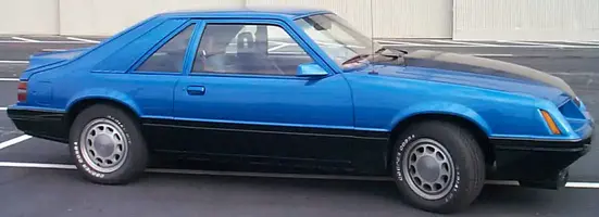

I tossed all of the side rubber moldings. I kept the pieces on the front of the fenders and the rear of quarter panels where it meets with the bumper moldings. The rubber pieces don't take painting well (although there are ways to prep them so that they will). The very front and back pieces are hard plastic though and not rubber. They paint great. No reason to get rid of them. Oh... and it looks fine with or without the rubber side moldings. Just depends on which way you tend to like it best.
Forgive the image quality below. The site is real picky about image size.

Now that doesn't look bad, but yours is a 4-eyed ;). Looks nice though :nice:
