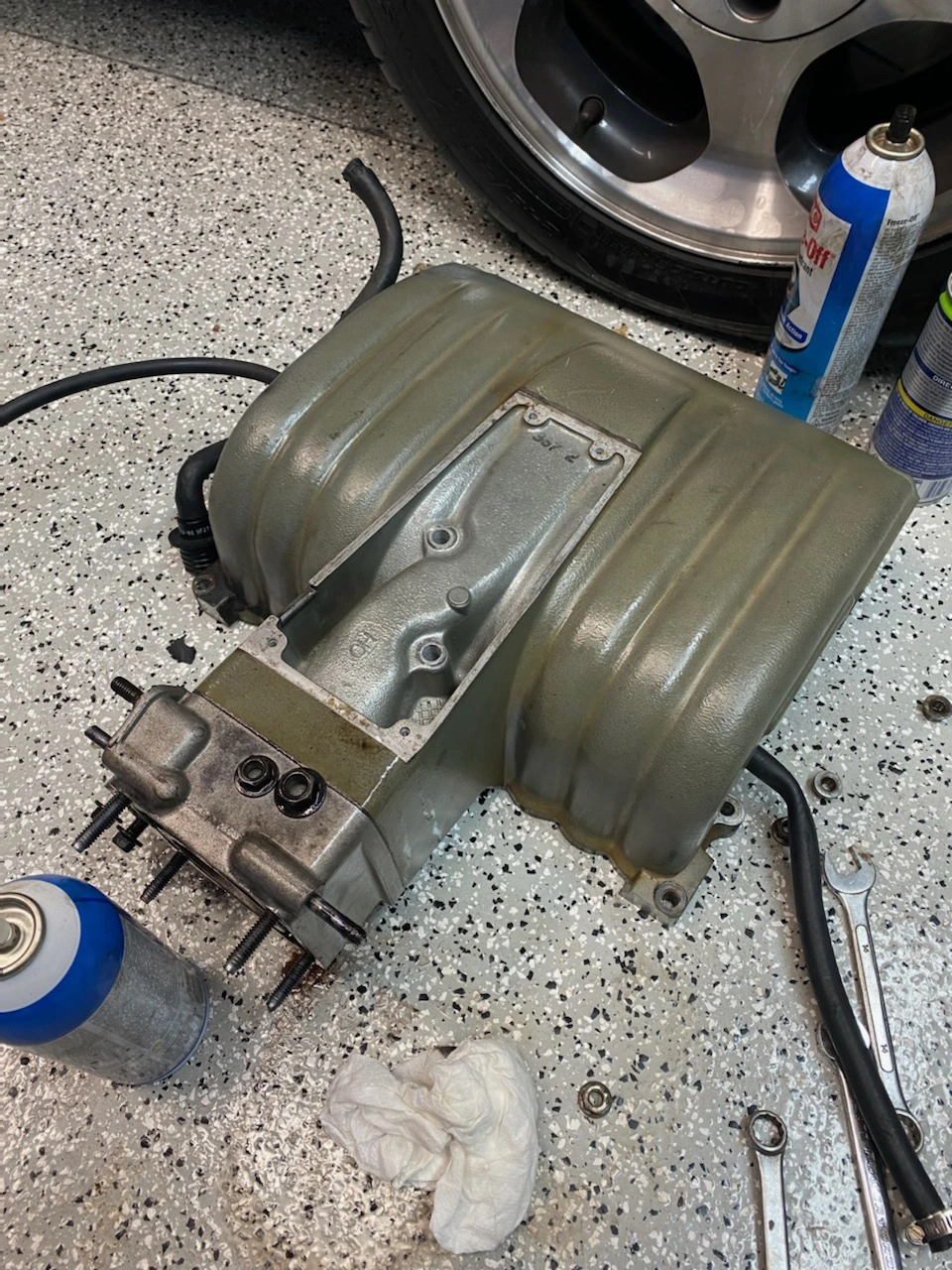

Hope, this has not been asked or answered. How do I safely remove the EGR spacer from the Phlenum? I've soaked the four bolts on the spacer for two days and they will not turn. Used the method suggested by Matt on the Youtube Vid.
Also, whats the stock size for the EGR Spacer?

Yeah, they're a pain! The steel studs tend to corrode into the aluminum on the spacer and the manifold. My go to is PB Blaster but Kroil works great too. Spray the penetrant, tap on the studs with a ball peen hammer, several times. Soak and tap over and over. Bang on the EGR spacer with a dead blow hammer. Try to tap in a thin putty knife between the spacer and manifold to break the seal. Nothing fun about it. Patience is the key here! When you do get it off, clean it well and definitely replace the studs with a new set.
