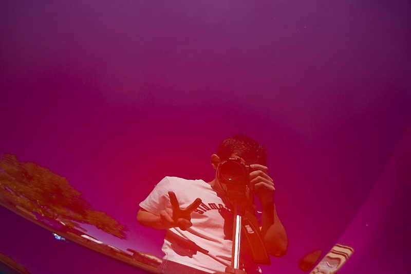

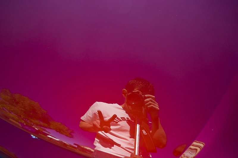

I removed the swirls on my stang a long time ago so my pant looks fabulous

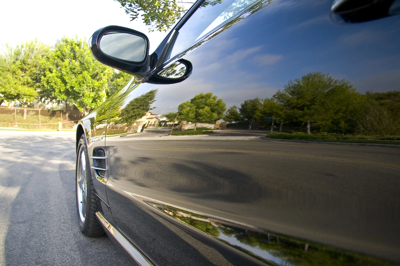

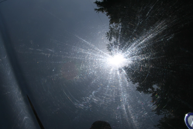

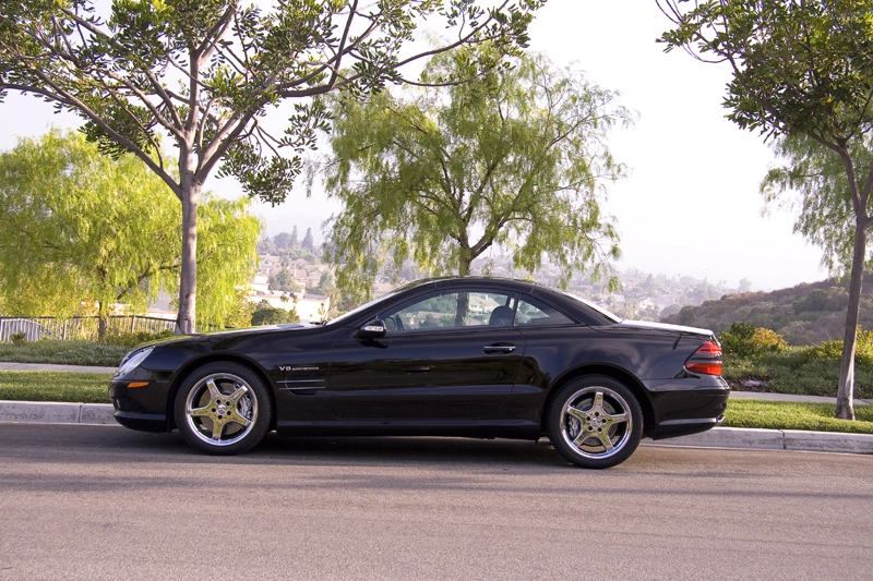

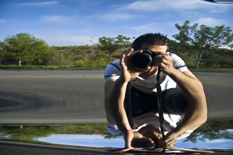

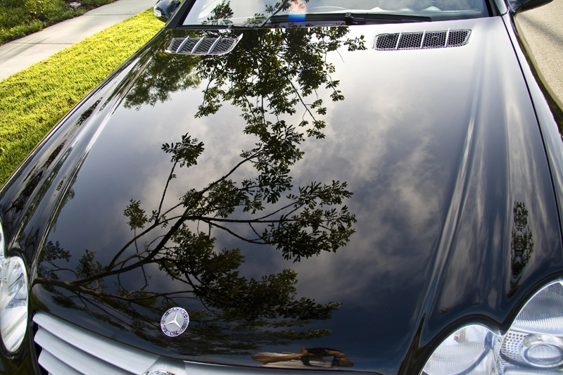

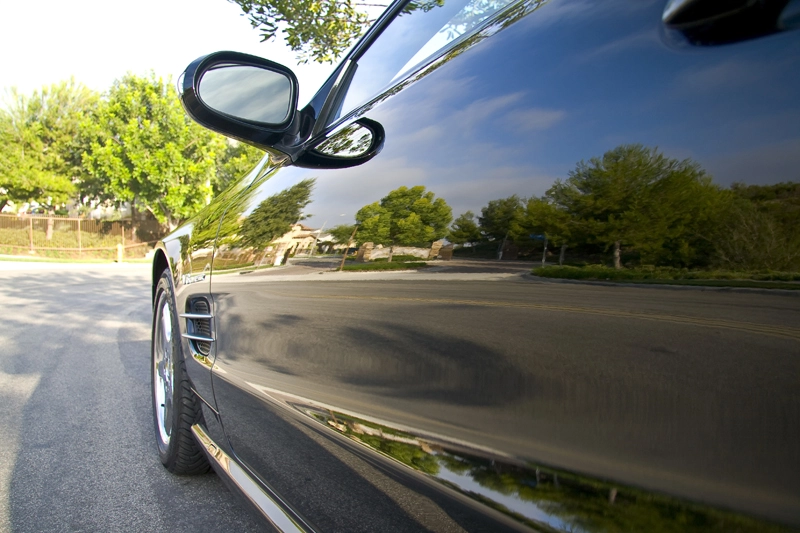

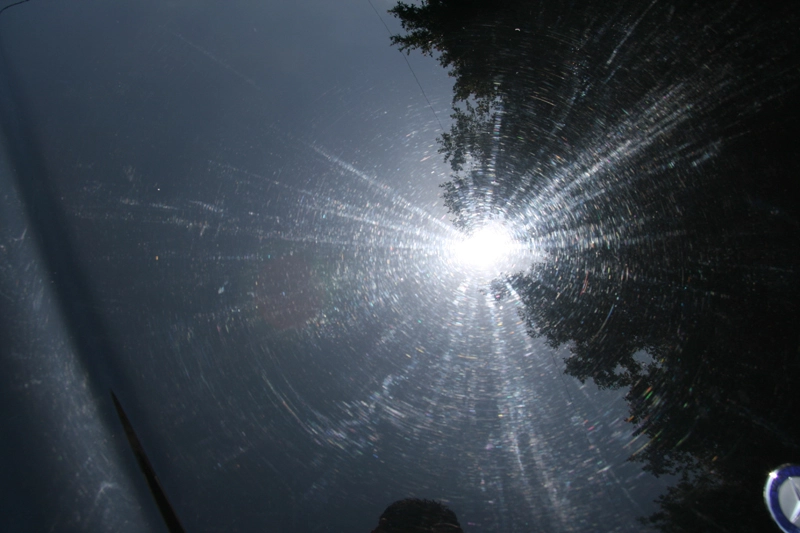

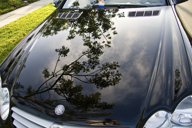

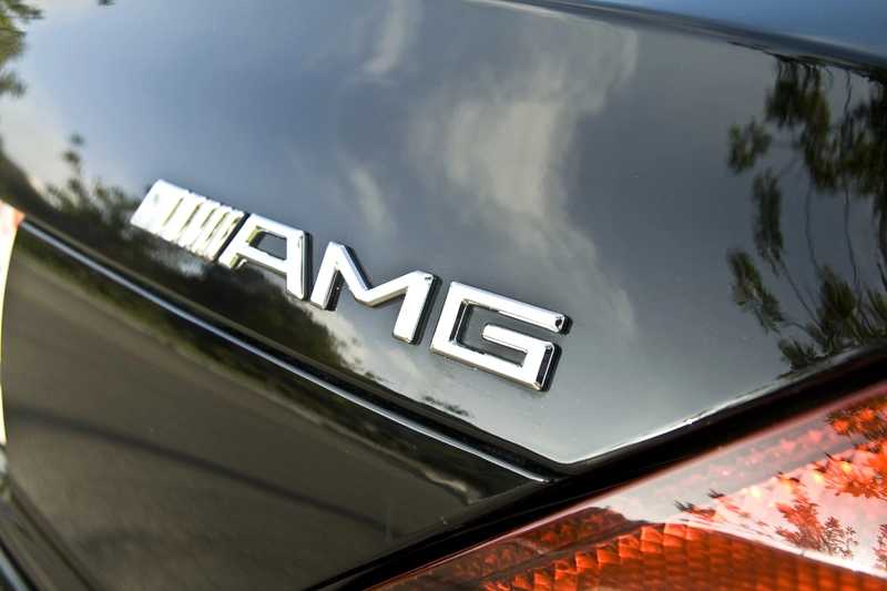

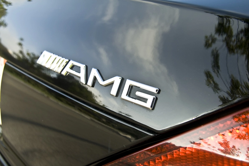

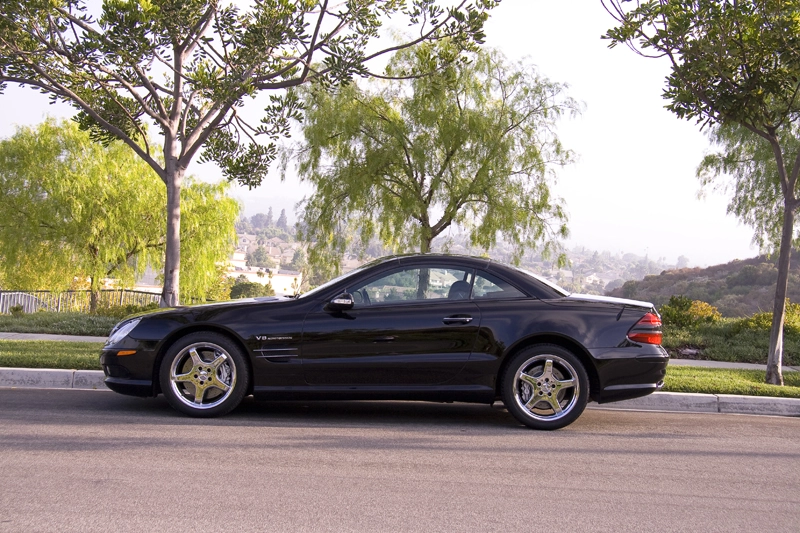

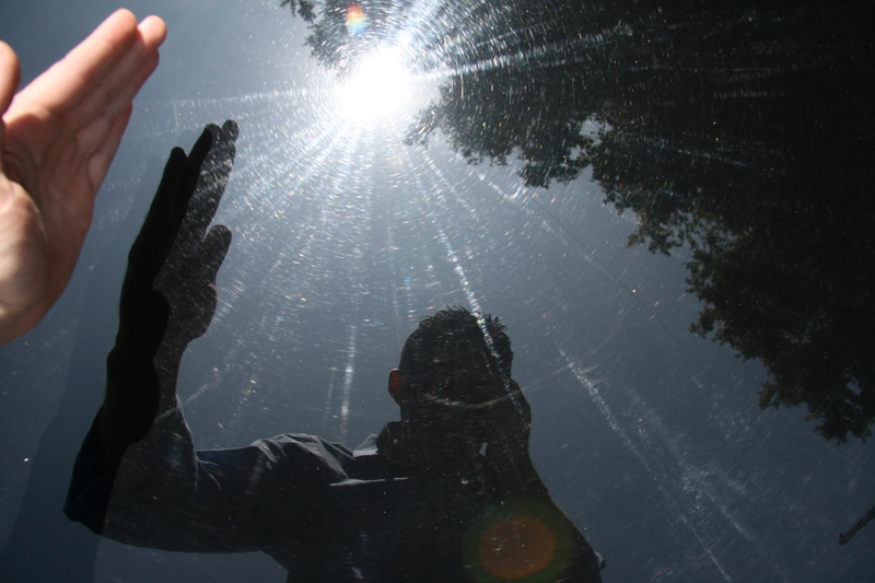

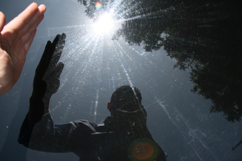

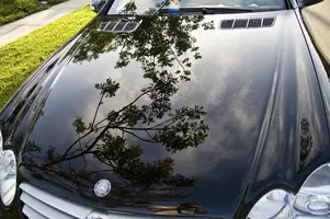

This is my family member's SL55 AMG that i detailed....the swirls looks like Hell before....
Adam's Car Wash
Dry With Waffle Weave Towel
Adam's Claybar
Wolfgang Total Swirl Remover 3.0 w/Lake Country Orange Pad
Wolfgang Finishing Glaze 3.0 w/Lake Country White Pad
Wolfgang Deep Gloss Sealant w/Lake Country Red Pad
Before
After

Maybe it isn't "swirls". It is not what you see in the above pics. It is a haze left from where the buffer went. I tried to get pics, but it is very hard to capture. I'm glad it seems fixable, I'll take it by the body shop next chance I get to see if the guy will work on it. Last time I took it to him, he worked on it for an hour and wouldn't let me pay him. Great, yeah, but I also feel bad because he stays busy and it was during business hours when he could have made money. That's the reason I didn't go back to him (wish I had now, but oh well). Thanks everyone.

Your "Pant" looks much better than before :D
