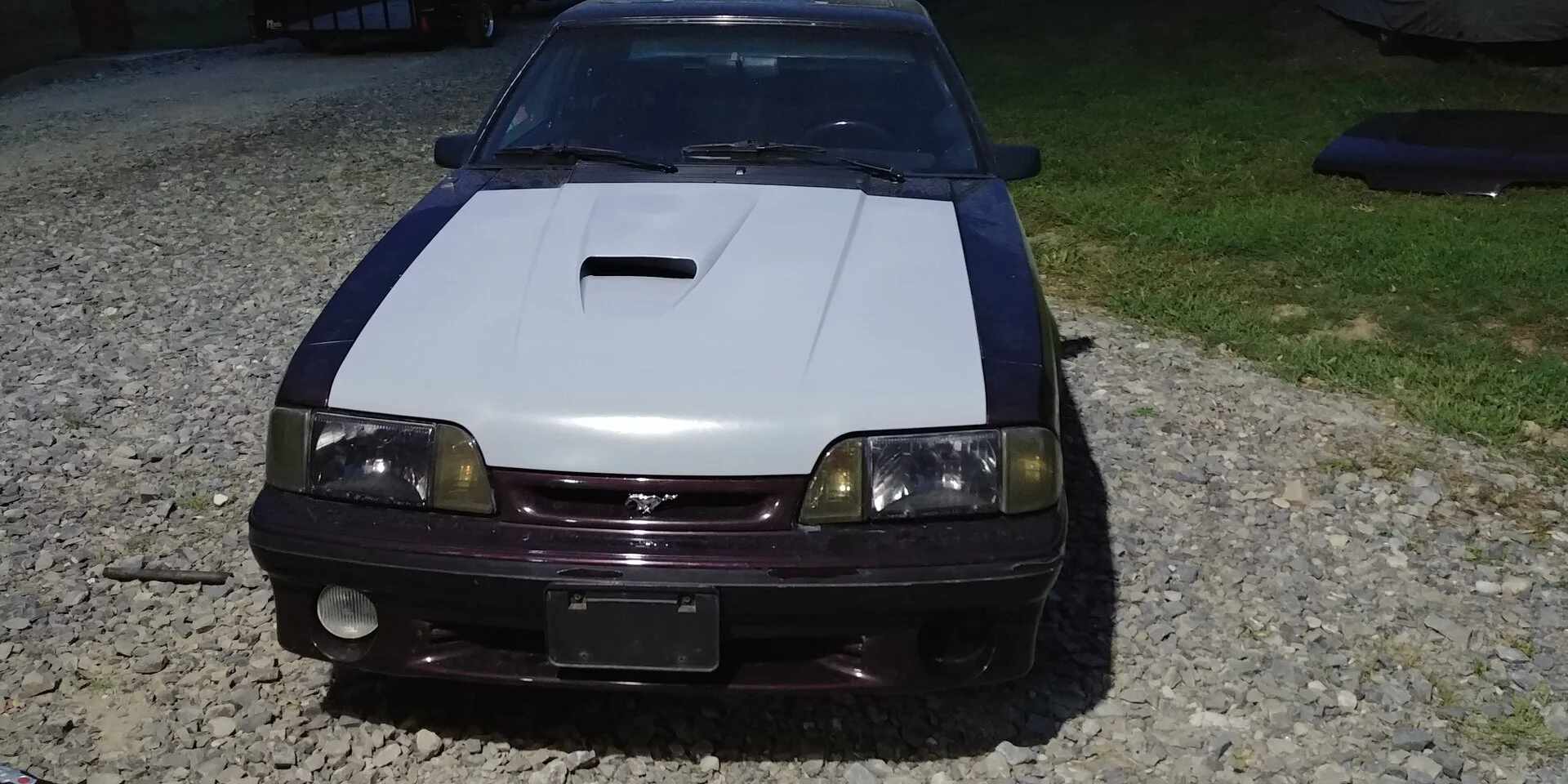

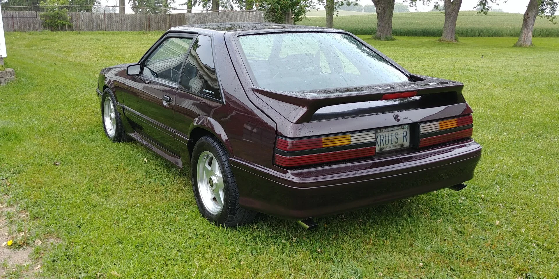

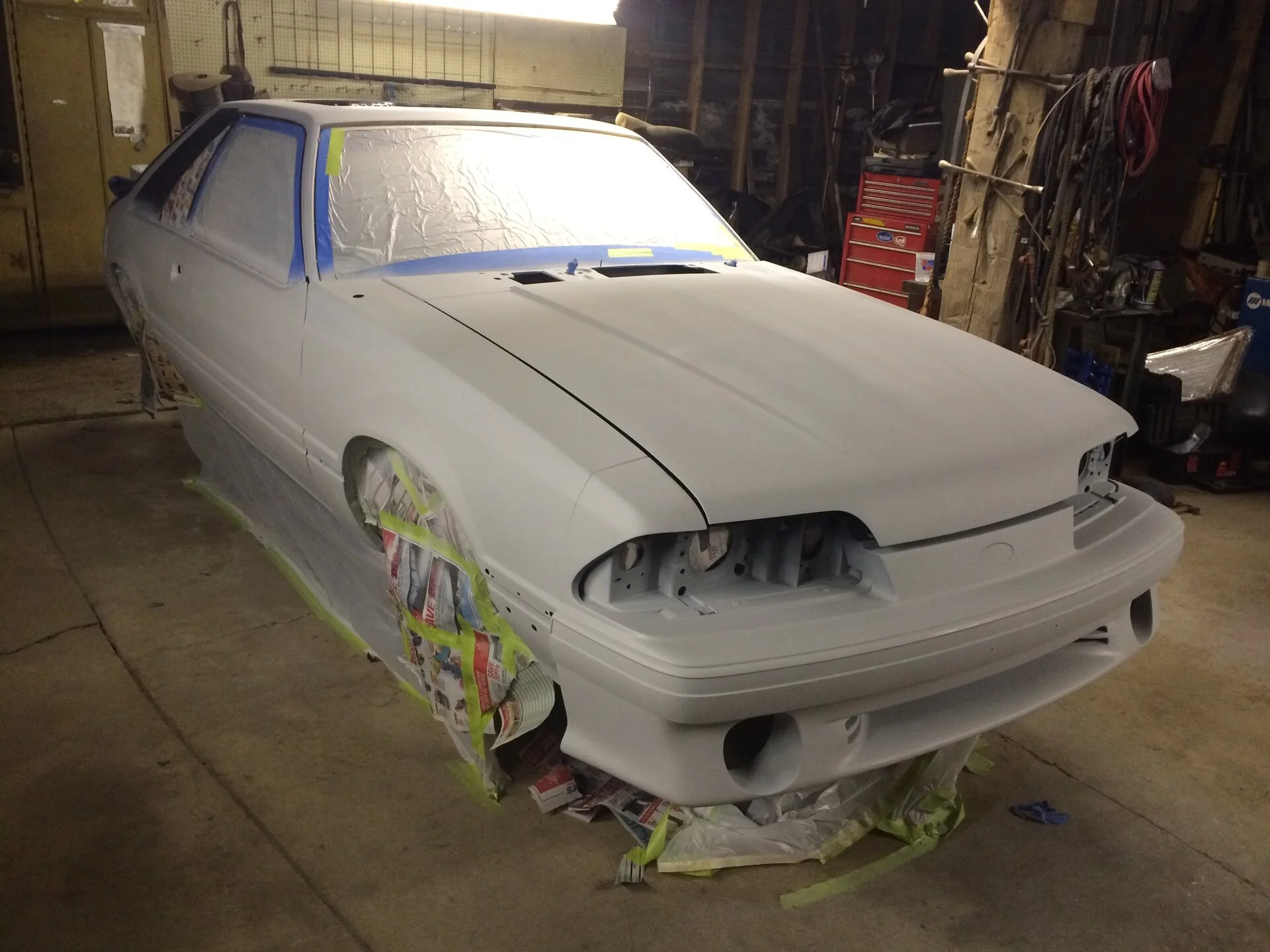

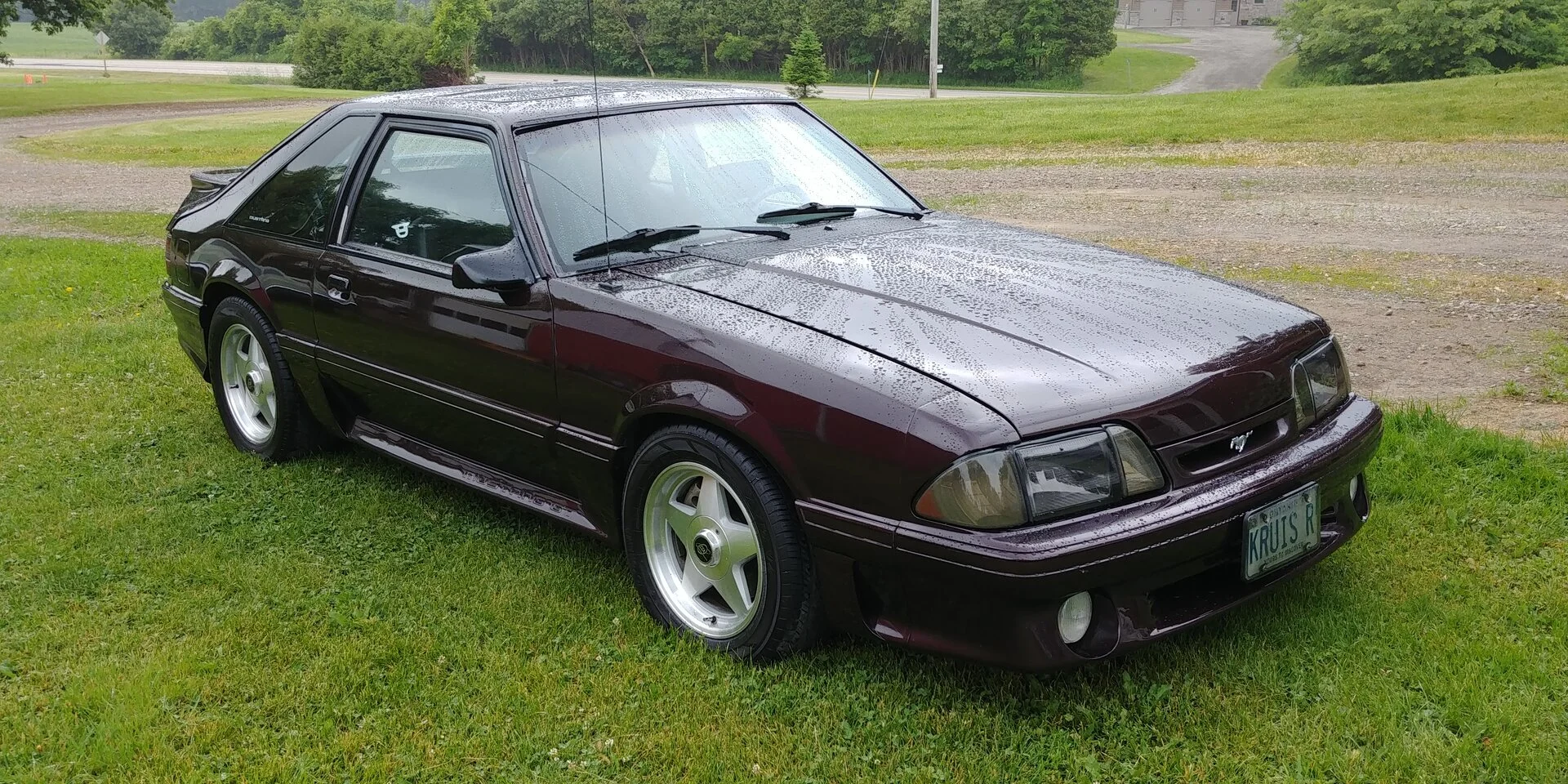

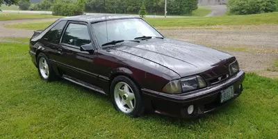

I personally have painted cars myself (and not in a paint booth) with some coming out good, some needing more work and or repaint.
IMG_0893.webp IMG_0894.webp IMG_0900.webp IMG_0914.webp IMG_0916.webp IMG_0919.webp
Take your time, pay attention to the details, don't get frustrated or upset if you make a mistake, just learn how to fix it.

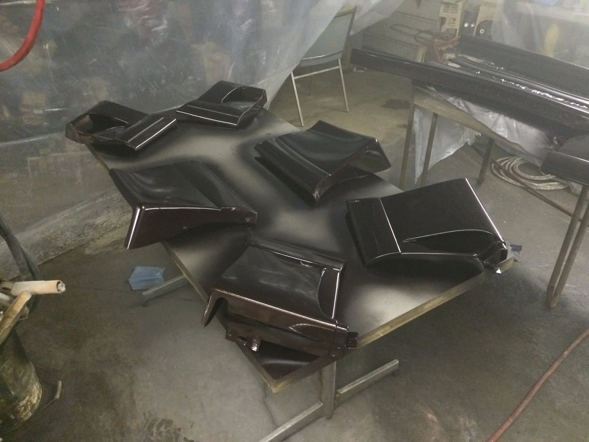

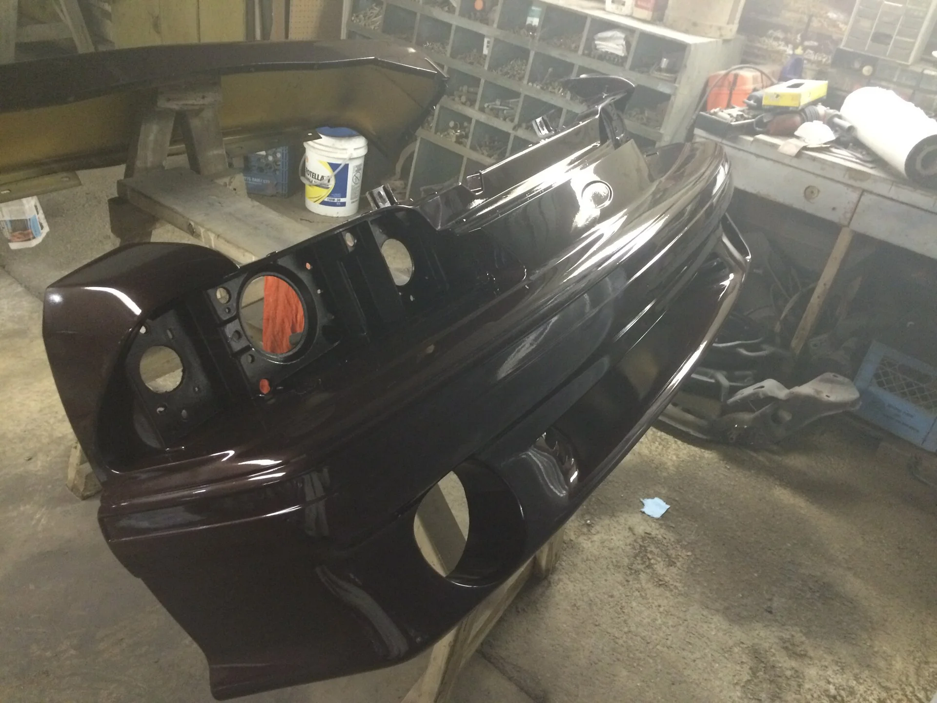

I used the Eastwood products (poly primer, 2k sealer, base coat and clear). All total I was about $800-900 CDN in materials (5 years ago) plus equipment.

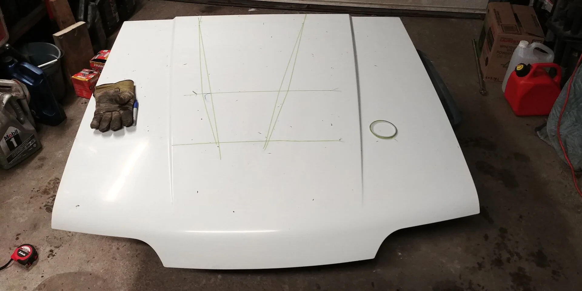

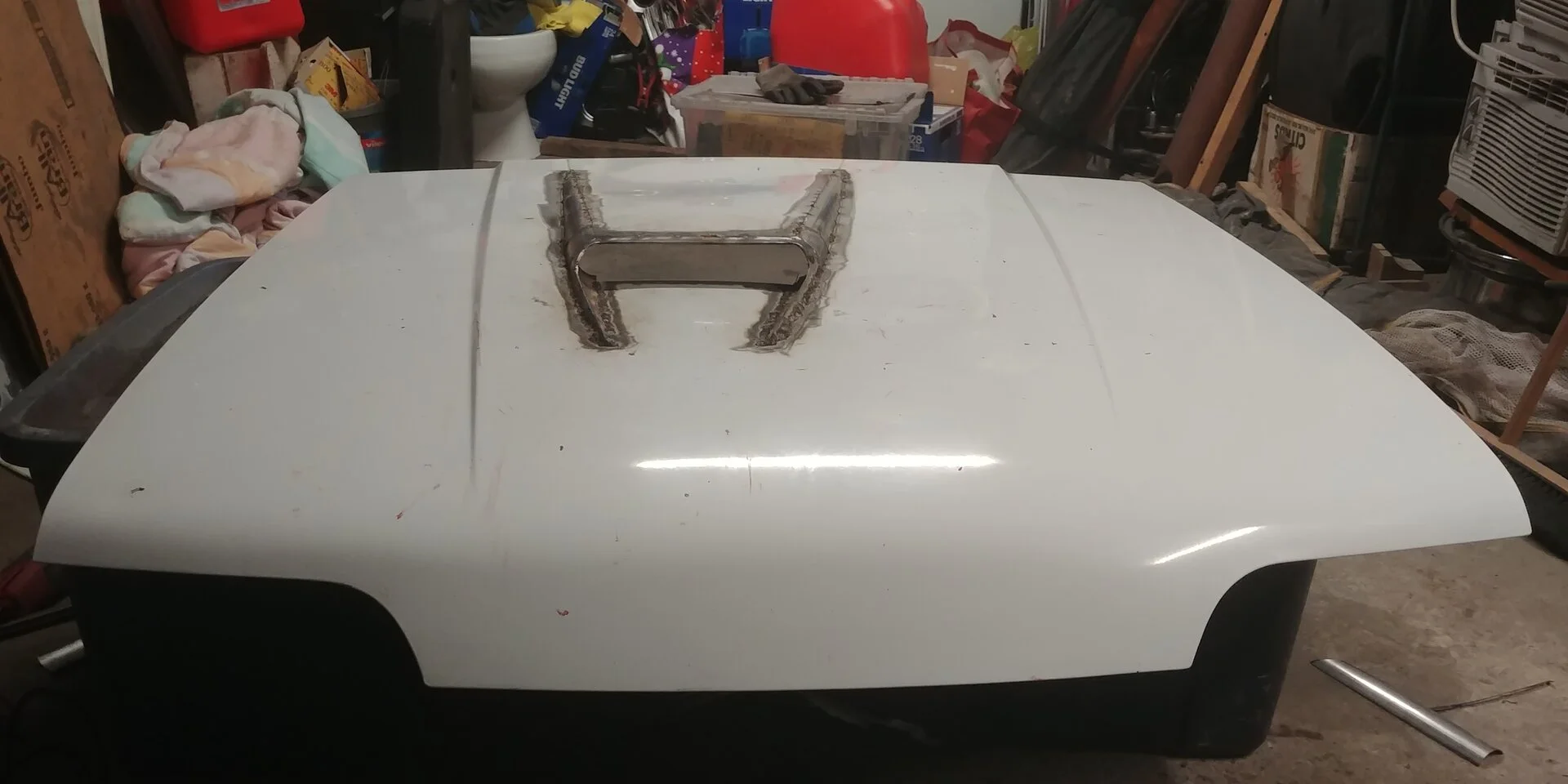

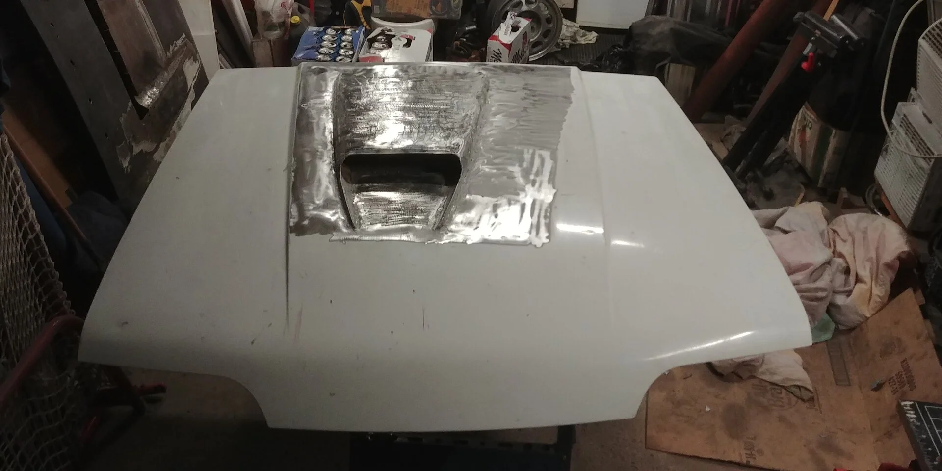

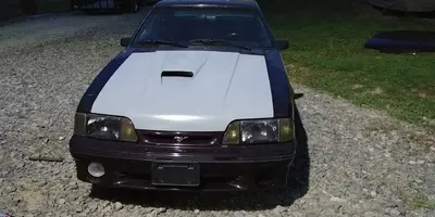

Then recently built on those skills and built a custom hood.
20200109_131332.webp 20200114_173218.webp 20200514_213324.webp 20200901_201816.webp 20200903_140907_HDR.webp

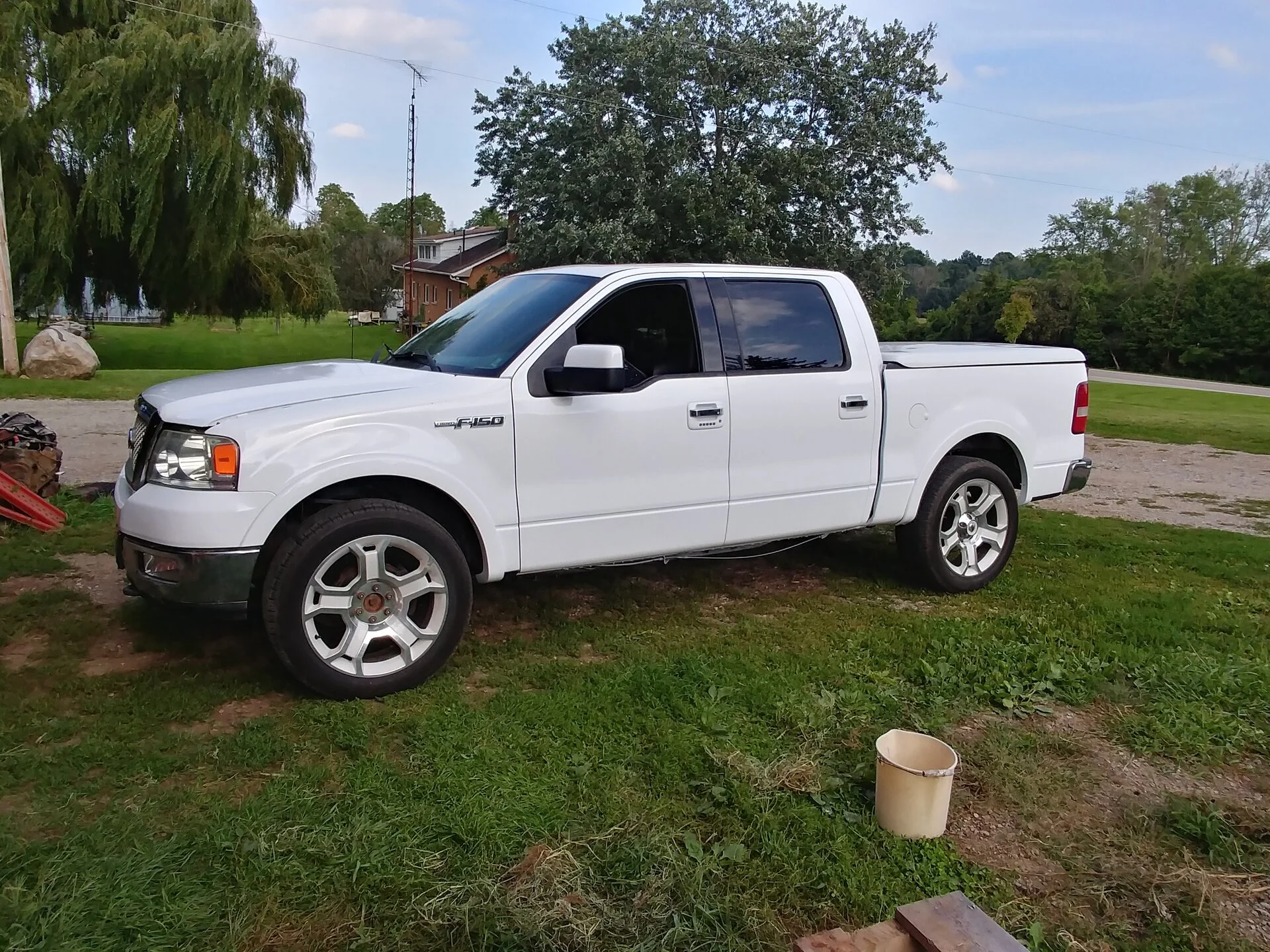

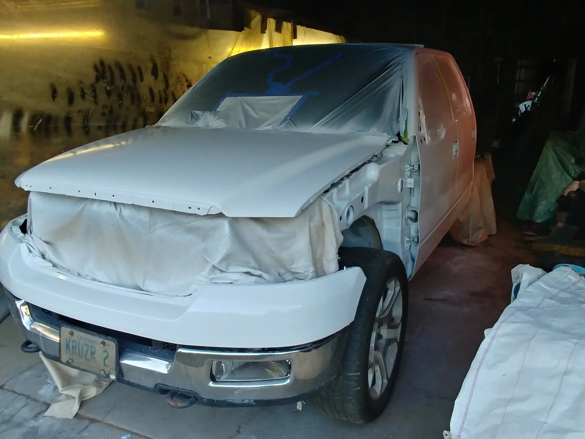

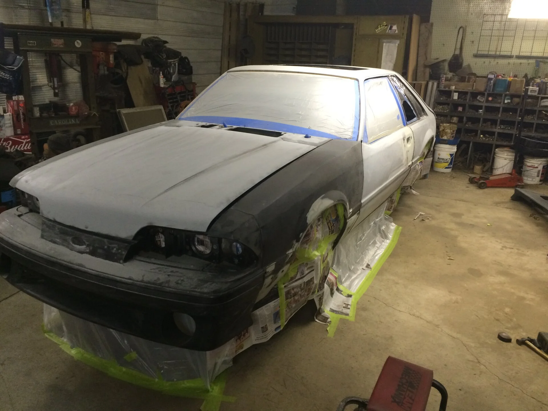

Single stage paint is not a problem. I repainted my F150 in an Oxford White a few years ago. Other than some orange peel (a function of my equipment and lack of booth to heat finish after spraying - not single stage paint) it came out very well.
