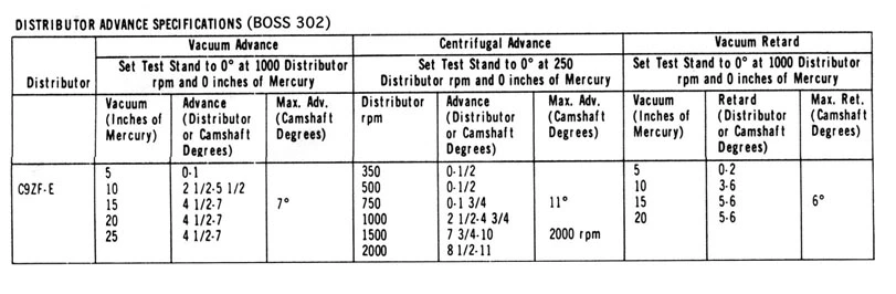

Usually, a good baseline for the dual advance distributor, if you have an upgraded engine, is the BOSS 302 specs:
