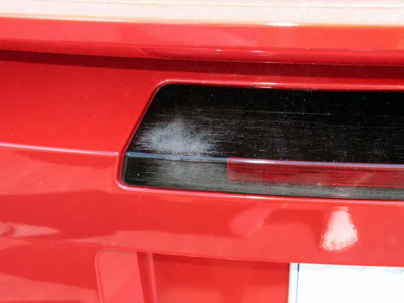

before:

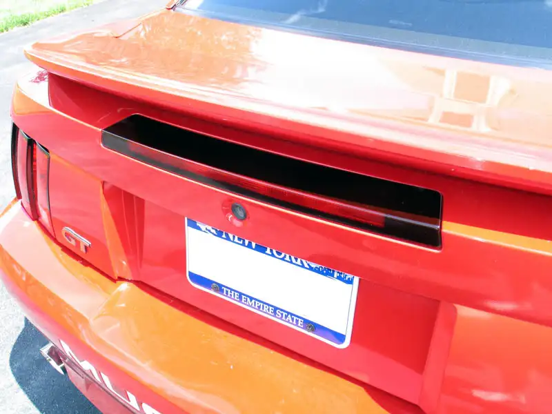

after:
i applied a gloss clear coat over it and has been lookin good for almost a year now :nice:
