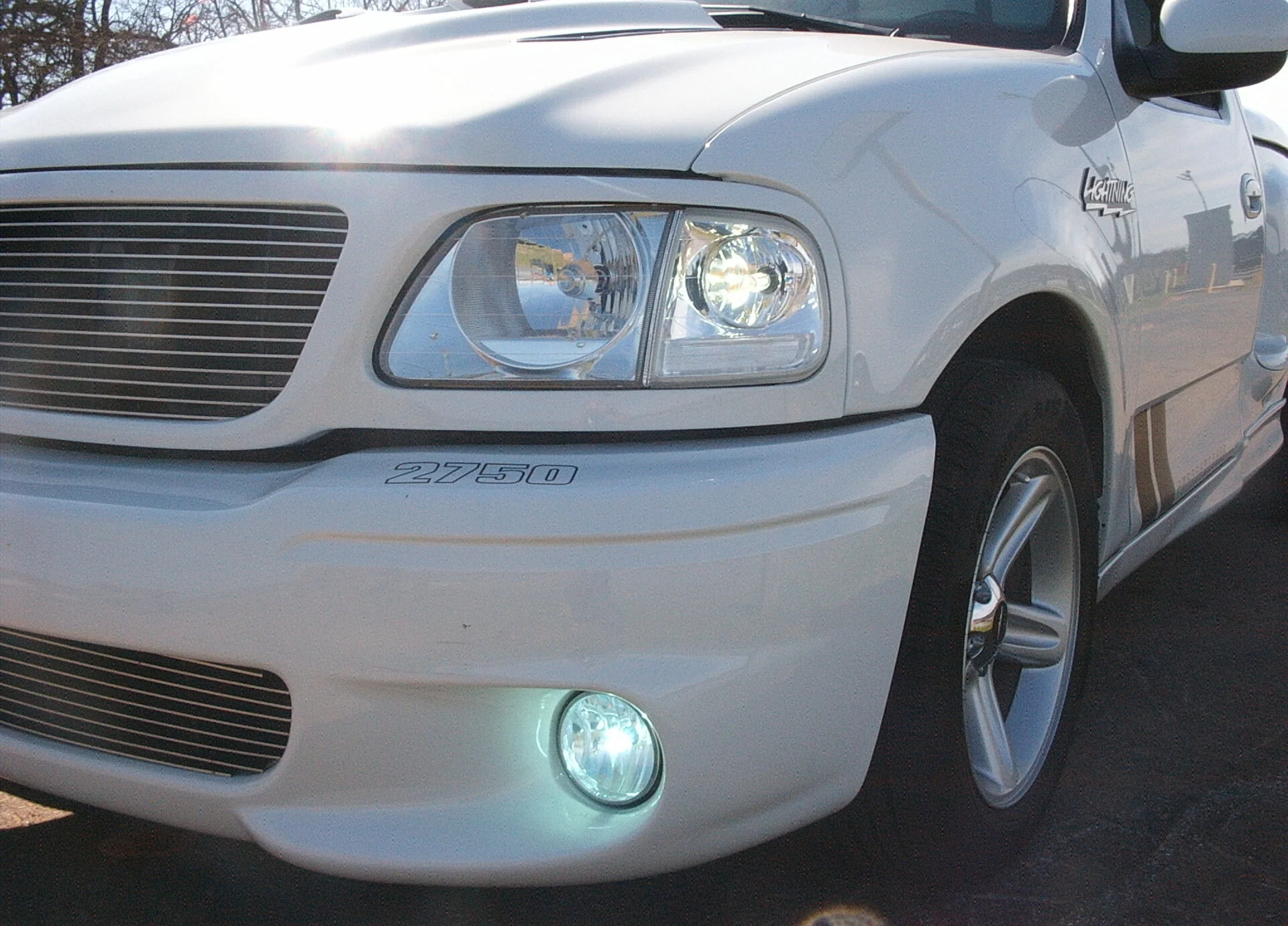

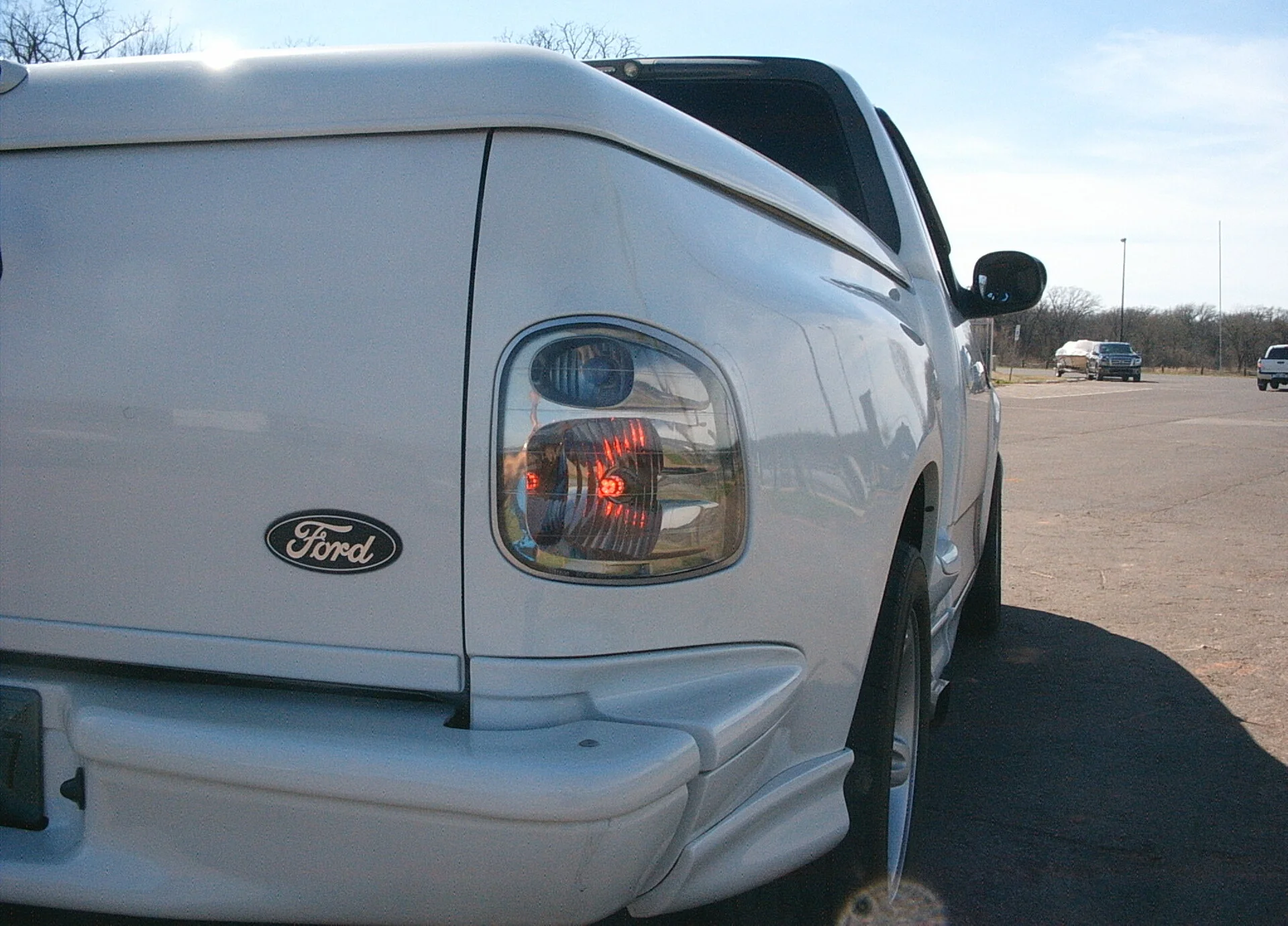

For a trunk light, yeah I agree. For turn signals, if you want to go LED, it's worth it. Here are a few pics of my Lightning with LED signal lights. The rears are one-offs, no other set like them. Had to put a load equalizer on each for them to blink properly.

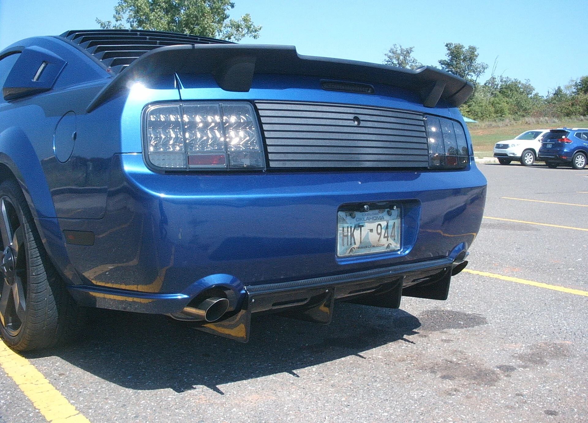

And my Mustang has Spec D tail lights and front corners. But they came prewired with the resistors already wired in. Plug-and-play.
