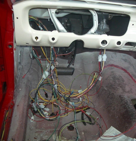

I am in the middle of a Painless wiring install and can confirm that it has given me quite a bit of Pain. I have not been able to call their tech line, because they are open while I'm at work. Part of this kit could be installed by a small child and other parts would require an electrical engineer. I CAN NOT figure out the wiper motor, switch and pump. The pictures look nothing like my motor or switch. There are too many wires for the motor and not enough for the switch or vice versa, I really can't recall. My pump (brand new) has only one wire connector, but there are two wires to connect to it (not ground). I'm also having trouble with heater connections. Overall I really like the quality of this kit and it looks fantastic. It's just a bit beyond my skill level. Do you like spaghetti? Then here's a pic....
