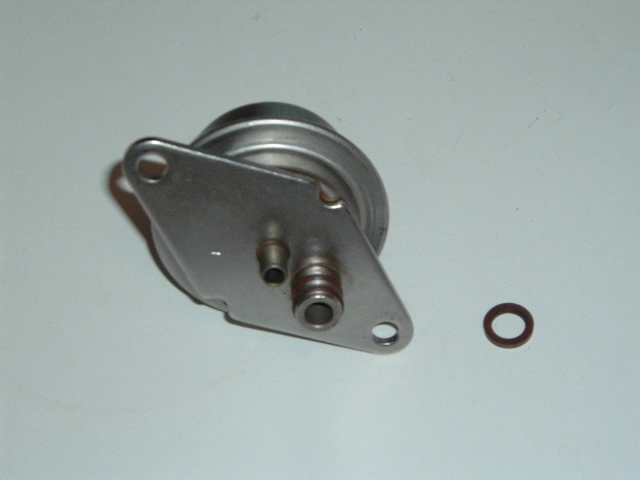

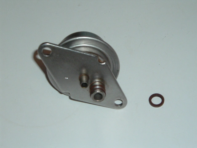

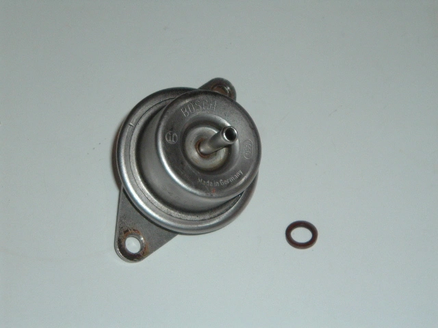

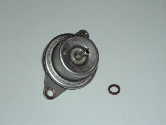

In the pictures, where does the unattached o-ring go?
